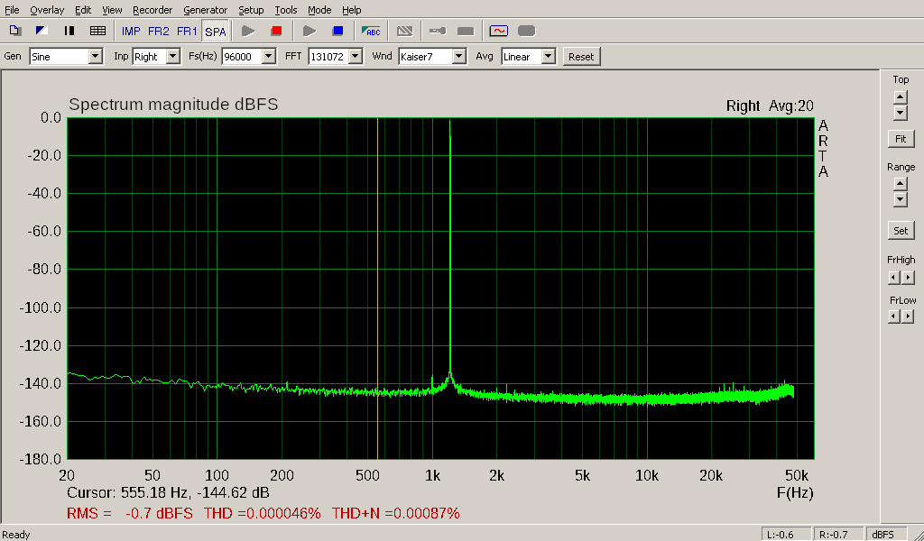

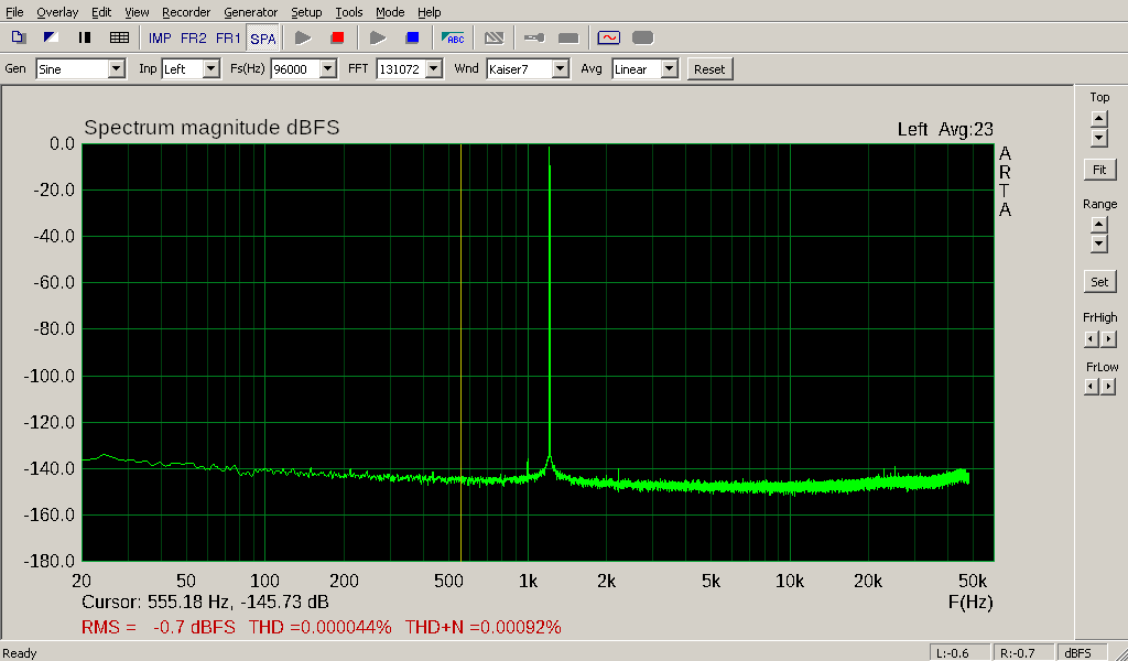

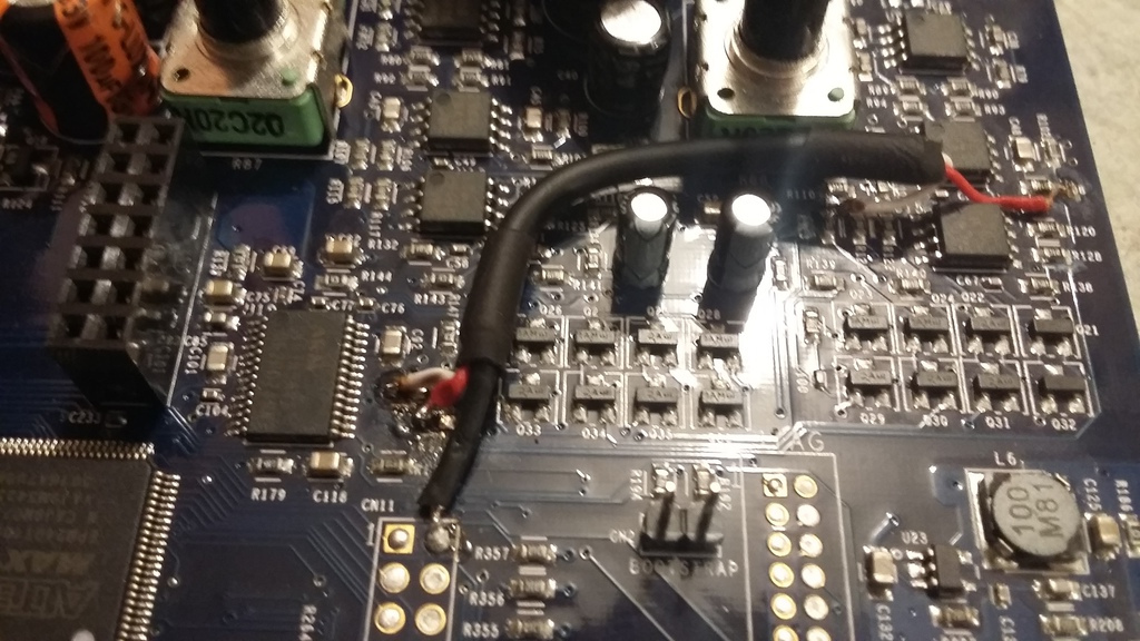

The simple fix seems to work (I really wonder how they could route balanced signals that way). Both channels have basically same performance now (screenshots of joint-sides compensation at 1211Hz). It would have been better without the 1kHz USB artefact 🙂

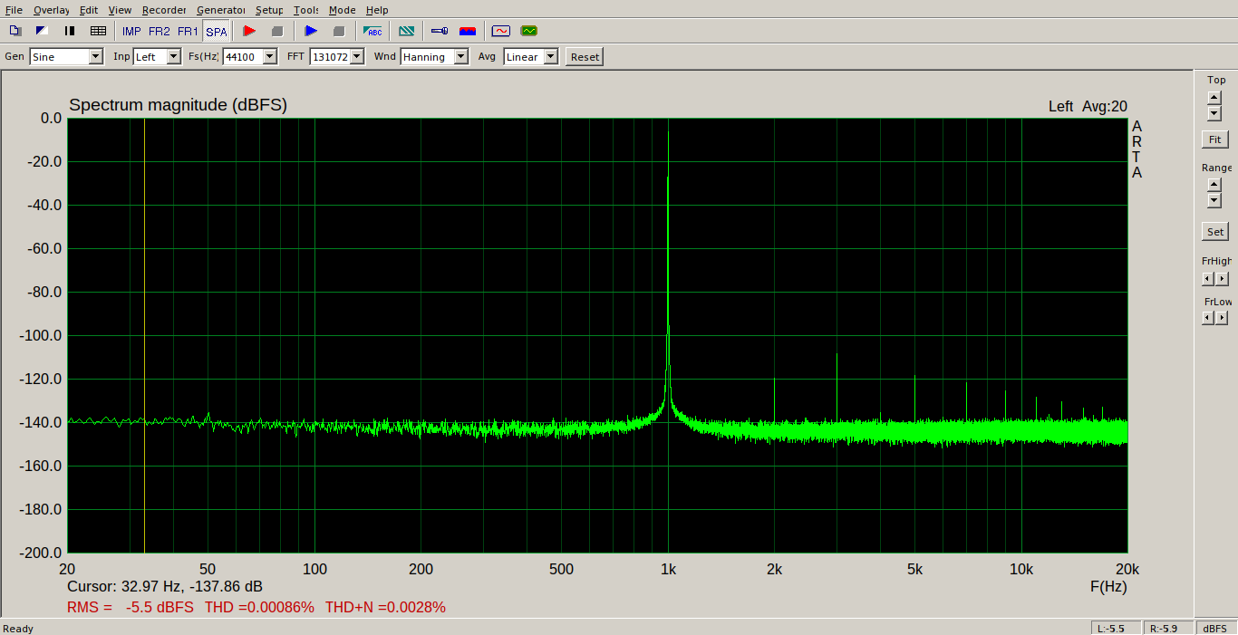

Hope this is the appropriate thread to drop in. I am fiddling for some time with linux (LMDE), ARTA, STEPS and EMU-0202 and EMU-Tracker pre.
Recently I installed Ubuntu Studio on a separate machine for comparisions. Starting loopback THD-measurements with ARTA FFT on LMDE yields the more or less usual result:
