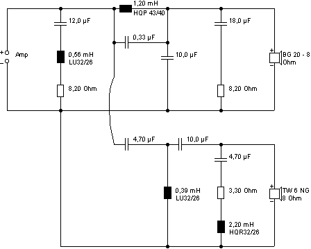

You might be able to do something along the same lines for a valve amp with these two 8" units:
B 200 - 6 Ohm
BG 20 - 8 Ohm
Strassacker: Speaker Building, Components
Model it in Boxsim. Start with something like this:
Best I can suggest. 🙂
I just found the circuit for the Cheap Trick CT230.
I don't rate the TW6 particularly. You might try your existing tweeters or the Monacor HT22/8 which you can model pretty much as if it was a TW70 without the 14kHz HF peak.
Bear in mind this is a fullrange BG20 with the whizzer cone removed with some work with a razor blade or Stanley Knife. The B200 might be easier.
The circuit makes sense at some level, especially the Zobel on the bass. But I think I could do better. That LCR on the tweeter is a bit weird, but the input LCR is impedance correction for SET amplifier. 🙂
Most people will fling their hands up in horror at this sort of retro thing, but it can sound stunningly good and musical when well-implemented. 😎

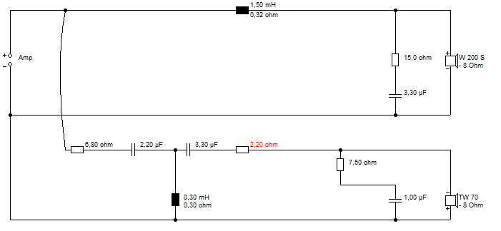

We really want a paper driver with corrugated paper surround and preferably, vented magnet and cloth dustcap. The Eminence Beta 8 is not far off that idea, but possibly too efficient here.
I'd take on this Visaton W200S in your situation, it doesn't need much filtering:
Visaton W200S-8 8" Woofer with Treated Paper Cone 8 Ohm | 292-572
It's a sort of poor man's SEAS CA22RNY.
Then give your tweeters, wired in series for 8 ohms (?), a go like this. 30 L ( 1 cubic foot) cabinet, reflex or closed box to taste.
