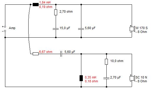

But you can see most of what's going on with some modelling:
Software | Visaton
Just import this design into the projekte folder and play around with values and add bits:
CT 142 mod – Boxsim Projektdatenbank
Paper drivers are not so easy as polycones, because they have more bumps in the response being less damped, but you get a feel for what does what.
Boxsim, like most simulators, can optimise parts for particular circumstances. The ones you mark in red.
825157d1584277138-dynaudio-x18-cabinet-drivers-lousy-crossover-dynaudio-x18-circuit-jpg
You then just modify for convenient preferred values. 10% here or there makes little difference.

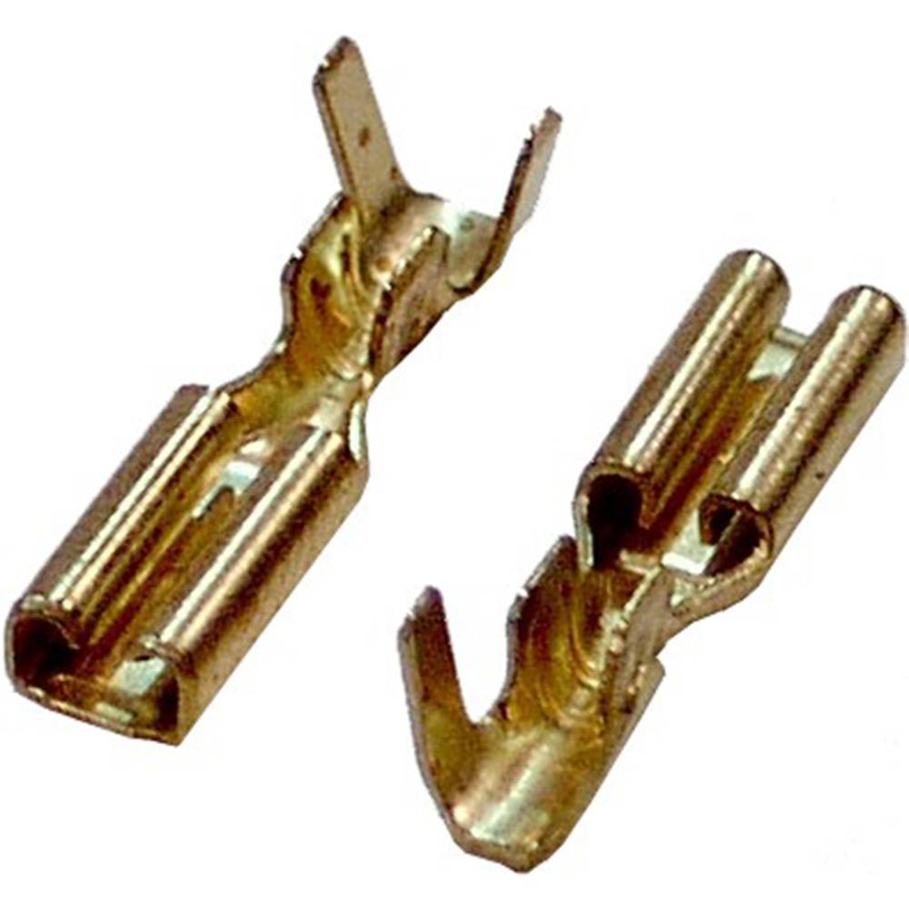

Consider removing the fast-on connectors from the equation. That may solve a lot of normally unexplainable dips and general strangeness in the sound.
In my opinion these have no place in audio, as they are designed to carry high current and thus do not have the consistent pressure on the contact surfaces necessary for stable connections at lower currents
Regards, Tjeerd
I am not too sure what a fast-on connection is.

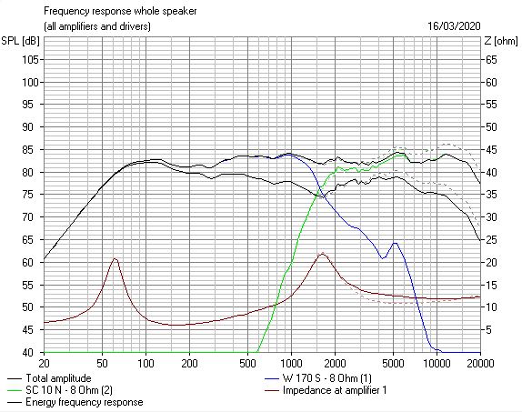

More certain is the effect of crossover components if you model them:
What happens if you take out the 10R plus 2.7uF Zobel?
A raise in high frequencies. Simple as that. The dotted line. :)

A faston connector is a piece of brass with a U shape that slides on the terminal
of the driver or input connector, usually nickel plated but comes also in gold plating.

Yes, copper oxidation can be a big problem, but usually it is quite visible. If in doubt, cut the wire a few centimeters above the old fast-on connector, inspect the naked wire (copper) if it is good and install a new fast-on connector. Or use a new wire.
Those are the push on connectors they use instead of good practices like soldering. Basically they provide a good mechanical connection, in that they won't fall off, but a lousy electrical connectin since there's no pressure or bonding at the contact point.
Laughably solder would be both more economical and more reliable, even on the production line, as a good solder joint takes no more time than push-ons.
Yes they are kind of loose as they can move sideways:D
If there is any play at all, it is very likely there are at least a couple of spots where you're getting a high resistance connection. As I mentioned in my previous post, these things provide a good mechanical connection but not a very good electrical one. My common practice when working on speakers is to remove them and solder everything.
Yes, the bare copper where they crimped the connectors onto the wire can and does oxidise, but that isn't their biggest drawback.

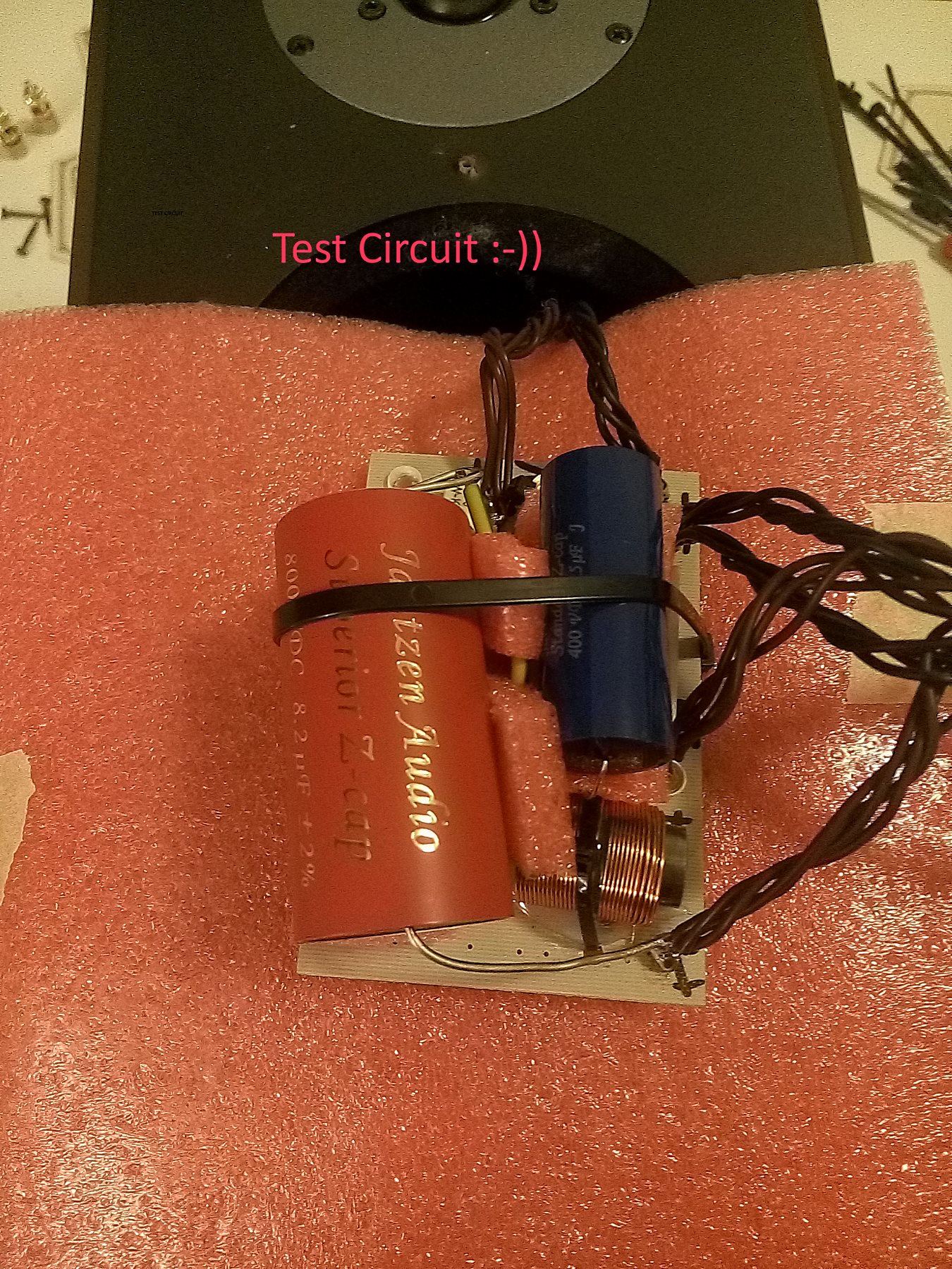

my DM 2/7 experience...
Hello Guys,
nice to see this post live...
2 days ago I made a last xover update to my DM 2/7...

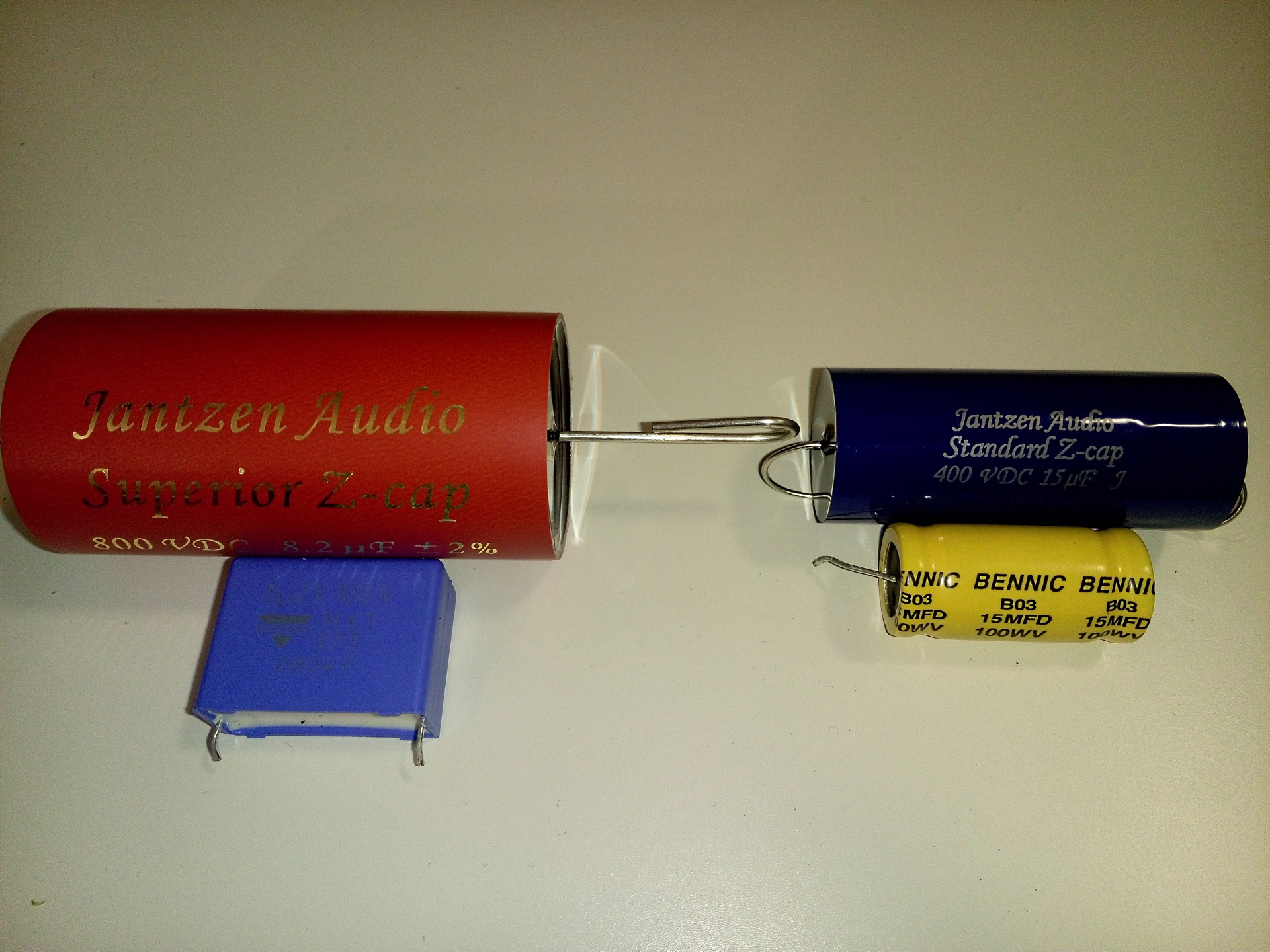

Before 3 years I decised to open my Dynaudios to see what is inside. What a disappointment ! Bennic, MKP´s and fastons ! UGH :eek:
So I decised buy a Jantzen Audio caps (8,2uF Superior Z-Cap for higs and 1uF to change one small MKP + 15uF Standart Z-cap for mids). Also I changed a new Kimber Kable 8PR to all wired connections + direct soldering.
1st I installed Kimber Kable 8PR + faston OFF and listened the change ... nice, bass were more rigid, more solid and less muddy and highs were more airy and opened.
2nd I installed caps...and then started 3 years of re-possitioning speakers, 5x of damping foam reducing in thousant steps... yes there were more colours to recognize - amazing but there was also bad mid + tweeter connection... so after one year I decided to put back that 1uF MKP because I understand that it could be a original one... and really mid+highs were nicely connected again so I just listened.
I found them very demanding for Amps but after a change it was worse and worse with possitioning... bass were slow in some freqs and I used and changed lot of amps to provide best damping factor values + Kenwood KA-1100D, DPA 222SE dual mono, everything less powered were slow. In 50Hz were a massive drop, I never knew why it is strong under 48hz and at 50Hz its so weak and then make it strong again in 53Hz+... oh dear... possitioning never ends !
And the same it was with sound source, LP, CD, MC... same all interconnets changed to SUPRA EF-1 and this all sorted this DM 2/7 setup. Well I got also some other speakers too, but Dynaudios were always best in terms of vocal and instrument colours, clarity and bit real feel. So I always do everything to make sound them perfect.
But there were another issue too, in space were often a hole in a center... so never-ending re-possitioning to make them enough close because of center space and enough away because of wide space and ideal from back side because of bass delay :mad: ... well it was really good test to me, what I am able to do for the sound, lot of personal energy.
So as I mentioned after 3 years of this (changed 2 rooms because of moving to another flats) I realised, that when is speaker sucks in phase, that you have to correct everything others or easily said, they are not able to sound correct in phase in some real conditions. I made a decision to try put the original bennic 15uF there (real value on both is 16,15uF not a 15,1 as is Jantzen) and see what happen... with this all damping foam is back inside as original - 3% from back sides foams but this is OK it gave them a very small amount of hardness which I overal missed.
So what happened after put back old bennic´s ? Oh sh1t they have so smooth and quick bass... and space is so perfect, wide, deep but with full center mass as I always wish... I told to myself, that I am so stupid... but this is very good experience to me.
So now Dynaudios have:
- 8,2uF Jantzen Superior Z-Cap for higs (this not influence to any previous issue)
- Original 1uF MKP and 15uF Bennic
- Kimber Kable 8PR freshly on tweeter I used only two wires from 8PR cable to connect a tweeter... This solutions has a smaller capacity as standart 8PR cable and power ablitiy for tweeter is still very good...
Iam lucky man now... And I am happy to saw on start of this thread - just change a tweeter cap and everything leave original ! Yes this is very safe solution !
I know that all this is because I never measured it, never calculated and completely fail myself to see, that only consider capacity is not enough.
I hope it will help to somebody...
PS: I am not native speaker, sorry for my Englis... :eek:
