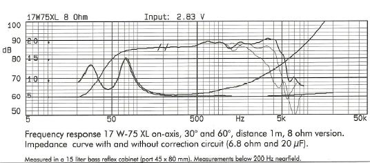

Dynaudio 6" polycone drivers are quite well-behaved:
610159d1491571296-crossover-help-dynaudio-17w75xl-ohm-d260-dynaudio-17w75xl-8-ohm-jpg

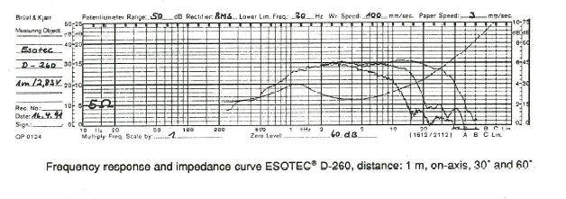

Esostar and Esotec tweeters are flat and can handle high excursion:
610160d1491571296-crossover-help-dynaudio-17w75xl-ohm-d260-dynaudio-esotec-260-jpg

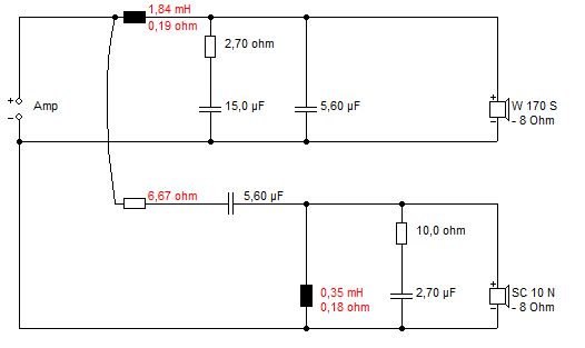

To take the mystery out of the crossover network I will elaborate here:
The bass-mid section consists of a coil with metal core of unknown value
in series with the BM driver.
Parallel to the BM driver a zobel of 15µf bipolar in series with 2,7 Ohm.
Parallel to the BM driver a 5µ6 bipolar.
The tweeter section consists of a unknown air coil parallel to the HF driver.
Parallel to the HF driver 10 Ohm in series with a 2µ7 bipolar.
In series with the HF driver 3,9 Ohm with 5µ6 in series.
Sorry I cannot draw a crossover schematic on my computer.
Best regards, Veeren
Just to demystify the polycone Dynaudio drivers, they get quite close to some other popular 6" polycones::

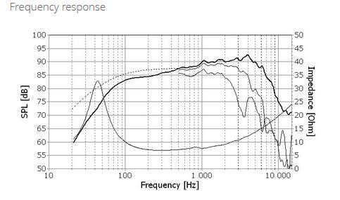

Peerless 830874:
462003d1422409098-value-performance-6-5-mid-woofer-diy-market-peerless-830874-jpg

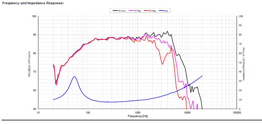

SEAS U18RNX-P:
462004d1422409098-value-performance-6-5-mid-woofer-diy-market-seas-u18rnx-frequency-response-jpg
All with breakup problems around 4kHz, which can be dealt with.

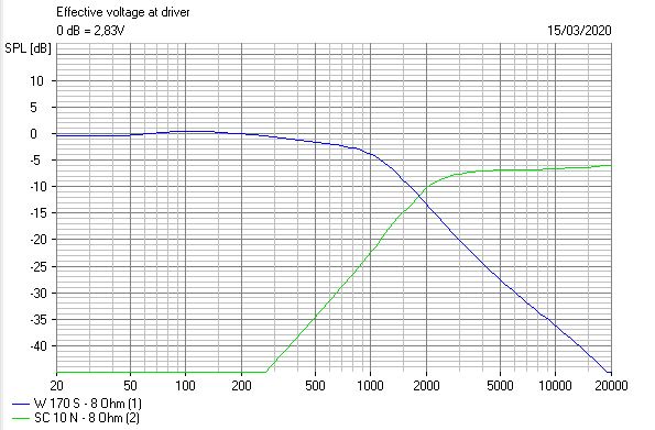

Anyhoo, here's my guesses on the Dynaudio X18.
What's the question? :D

Now we've got the schematic, it really all falls into place:
attachment.php
A 4 ohm woofer doesn't change the general picture, just drops the bass impedance to 4 ohms. You use a smaller bass coil too.
The bass shunt should work better with an MKP replacing a NP. You lose a little damping, but gain in quality.
It's effectively a tiny bit louder at crossover. The 2.7uF Zobel replacement MKP for MKP won't do much at all, IMO. The 10R/2.7uF Zobel damps down the top end above 5kHz very considerably, maybe 2dB. A 1uF might find a middle ground there. Bit more top-end brightness. A zobel can be impedance correction, but when used with series resistance, becomes HF rolloff too.
These are really tiny differences. I'm assuming the tweeter input is already an MKP.
Another way to do a bass filter on a driver that has good rolloff is this sort of thing:
377922d1382302599-restoring-monitor-audio-r300-bookshelf-speakers-monitoraudio_r300-md_final-png
That's a 5kHz tank notch. They sound completely different from a bare coil and sort of quieter. But you need to model these things. IMO, speakers work well in well-damped rooms, but a lively room with bare floorboards an' all that can annoy. Thick carpets and thick drapes, stands and rubber feet usually help. 4 ohm speakers can stress cheaper amplifiers. TBH, I sometimes wonder if these "upgrades" sound better just because in the process you clean and retighten the speaker connections. Copper corrodes quite quickly. LOL.
