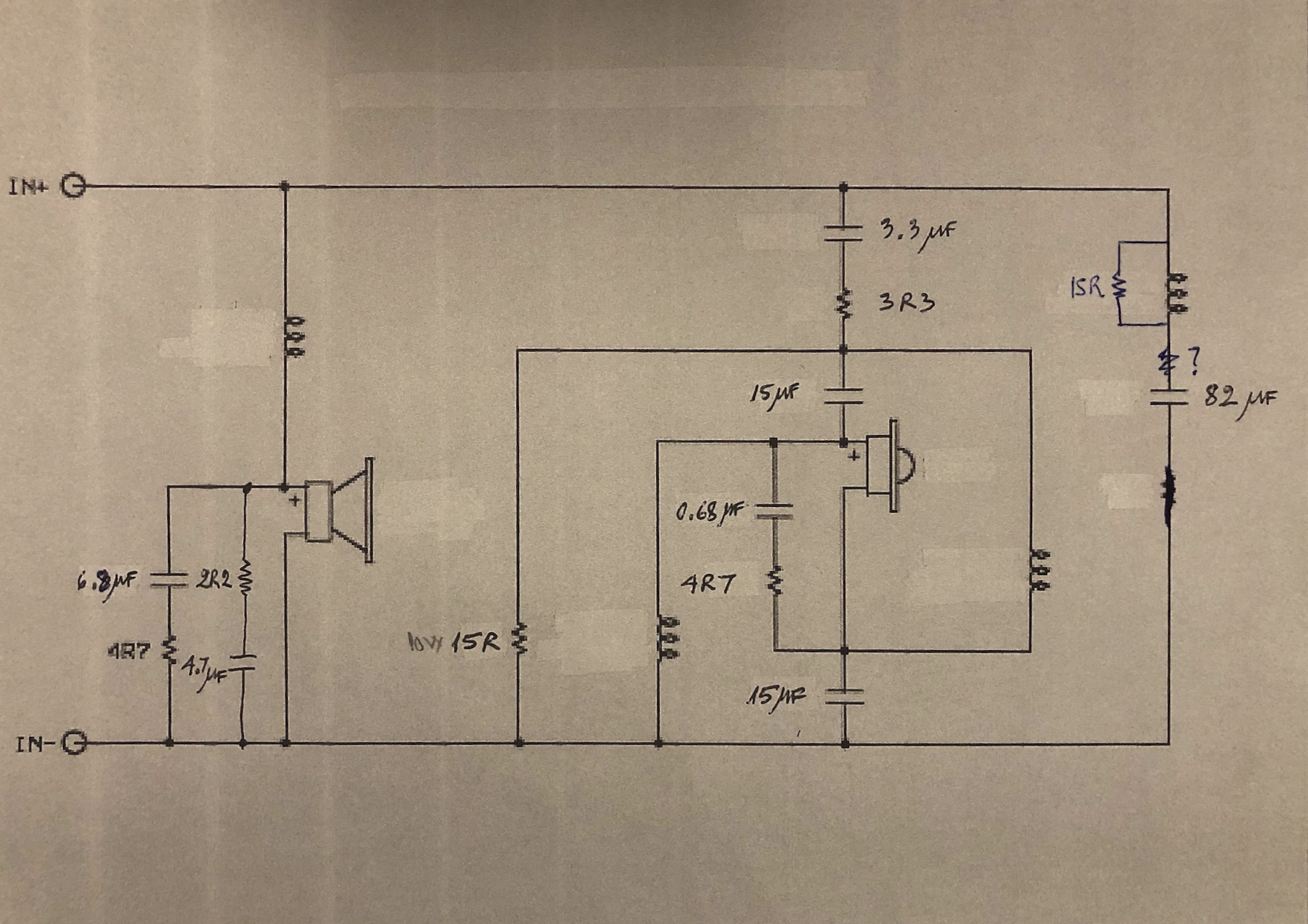

I guess the schematic may look like this one. You can add more components.
Thanks tuantran great help, I think that would be fine.
It remains pending that I have indicated with a question what appears to be a resistance without values, I attach a photograph.
Max
ok but the real schematic ?the first or the second?, a little confusion here.Thanks tuantran great help, I think that would be fine.
Max
that resistor (green/brown like color) is a custom dynaudio, the power is 7W
are you sure that the value is realy not appear ?, try to see down the resistor...
do you tried to measure with a tester ?It remains pending that I have indicated with a question what appears to be a resistance without values, I attach a photograph.
is better if you unsolder it 😉
however that cell is only to plain the load seen by amplifier, none influence on sound
The first and the last schematics are identical. The first schematic was drew by a doctor and the last schematic was drew by a dentist🙂.
🙂 Thank you

The resistor is 5R6 9W and the large inductor coil going to the positive of the woofer is 1.14mH.
I had thought about putting the 3.3uF and 15uF cap that go to the positive pole of the tweeter, Clarity Caps CMR but they don't fit because of their size, the same happens with Mundorf Supreme EVO oil. At the end I will put these two caps with Jantzen Superior and the rest Standard except the 0.68 Cross Cap.
The inductor Jantzen Air Core Coil AWG15, I have also ordered two 3R3 Mills resistors and the electrolytics caps two Mundorf BG35.
What do you think?
What do you think?

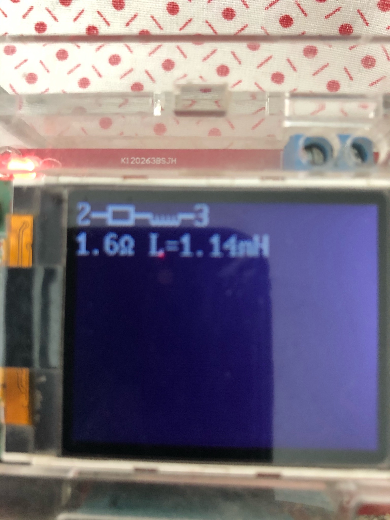

will be fine if you measure also the other inductances 😉
I’m sorry I’m didn’t it.
the inductance you refering is the bass-pass of the woofer ?
how do you measured ?, with lcr ?
I did the measurement with this tester.
could you measure them ? 😉I’m sorry I’m didn’t it.
1.6 ohm is the inductance resistance, right ?I did the measurement with this tester.
what's the % tollerance of your tester ?
I have finished the upgrade of my Dynaudio Facette, I am attaching a photograph with the final result.
As for the sound, fundamentally a greater presence and detail of the treble, a cleaner sound in all frequencies. The sound does not sound muffled, the electrolytic capacitor measured 59uF when it had to measure 82uF.
