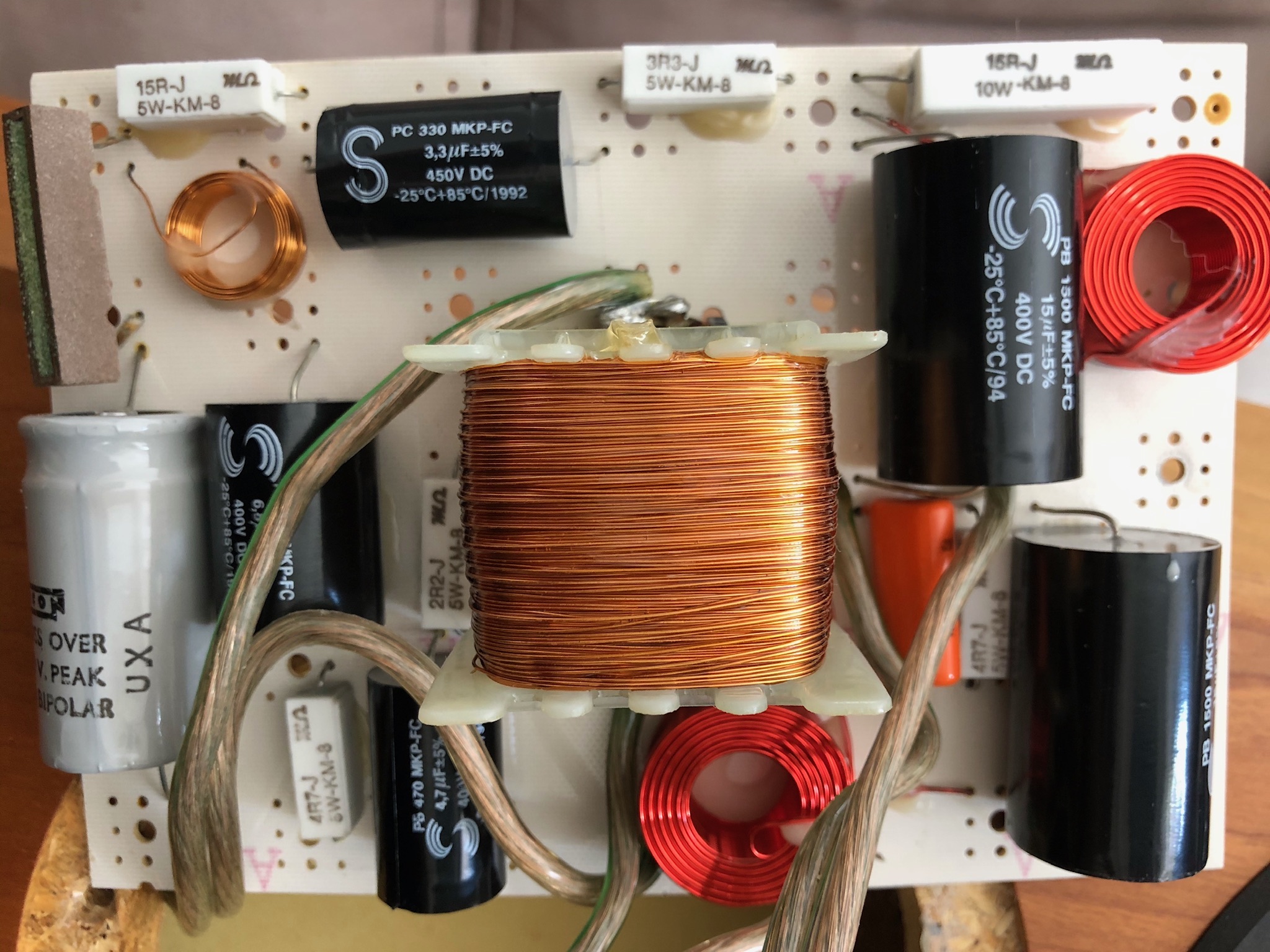

I think the most important capacitors would be cap1 3.3uF and cap2 15.0 uF, correct me if I'm not right. I wanted to have improved them with Jantzen Superior or Mundorf Supreme EVO, but due to space problems I'm going to choose Clarity Caps CSA, any other opinion?
Regarding Cap3 6.8uF and cap4 4.7uF, I could continue with Clarity Caps SA or can I put Mundorf Mcap EVO Oil.
Regarding the cap5 of 15.uF and the cap6 of 0.68uF, they seem the least important, the 15uF would be replaced by Jantzen Standard or Mundorf EVO and finally the 0.68 uF polyester capacitor 6 would replace it by Jantzen Cross.
The bi-polar capacitor would replace it with a Mundorf BG35.
What do you think? Any suggestion?

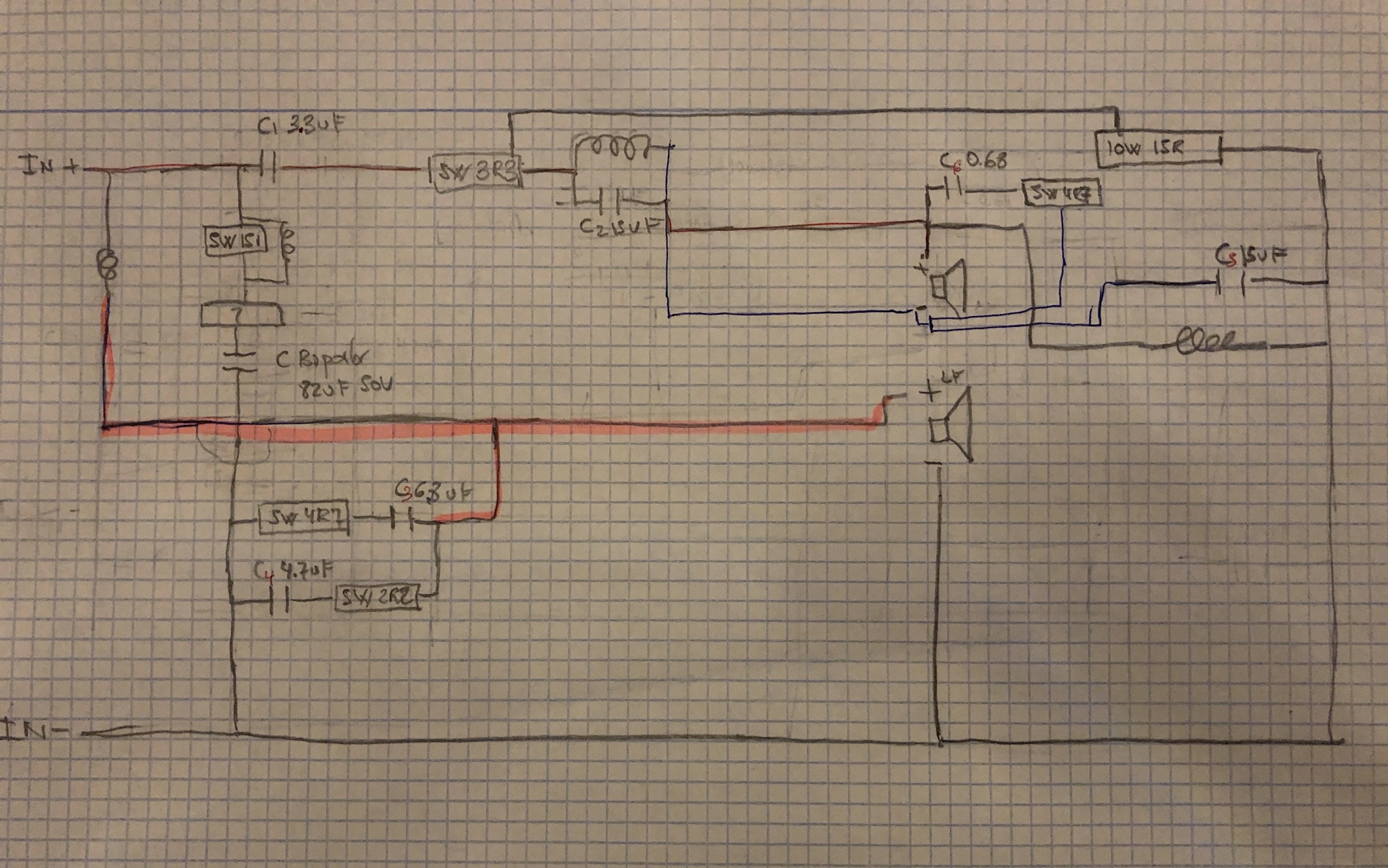

Thanks Miata5 for the photos so far. I would like to ask a favor to post a shot from the other side od the board so I can check the wiring diagram is correct. I'll post a schematic of it once I'm confident it's ok. You just name the cap values of the ones that are hard to read.
Are you sure that is the original filter ?I have also done the crossover schematic, sorry for my mistakes, it is the first time I have tried to do one, and I do not have enough knowledge.

The only cap that will need replacing is the silver electrolytic on the left of your crossover photo, replacing the others is pointless
Thanks Tony,
The you could change the electrolytic and the two capacitors that go to the positive of the tweer and test if there is any improvement.
Does changing the resistors help anything? I'm not sure about this, but I had thought of Ohmite Audio Gold.

Would you replace all or just the ones that go to the tweeter?
I won't be able to take the photo until this weekend.
Regarding the values of the caps are in a previous post, except for the bipolar electrolytic that is 82uF 50V.
The resistors are: 10W 15R, 5W 2R2, 5W 3R3, 5W 15R and two of 5W 4R7.
Max
please first answer to my previous question: are the scheme exact ?
I am not the first owner, but there are no signs of having removed the woofer or tweeer and it has been quite difficult to remove them since they were glued in addition to being screwed. Why it says?
