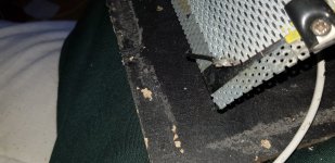

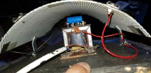

Pictures side by side for easy comparison.
The boards in the left hand image have obviously been worked on (witness the messy soldering), while those in the right hand image look untouched.

I'm gonna have a good look at everything then give it a go. By everything I mean loose cable's indications of over heating etc...
