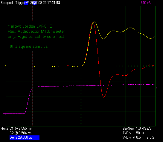

Tell me what difference you hear and I will explain. To me there is a difference.jzagaja said:Quick and dirty measurements tell us - absolutely no difference. I took Jordans and soft dome tweeter probably from Vifa made for Audiovector Denmark model M1 Super. 19Hz square wave stimulus and virtually the same loudness. Please have a look.
Did the picture come from a PC? What software?
