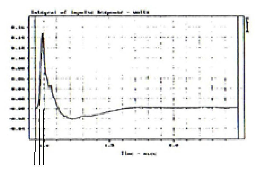

as far as hidhing detail, look at the rising section at the root of the so called impulse, my guess is that curvy region is an indicator of lost of detail.
Impulse rising region - I've only seen Herr Manger who looked in this part but I couldn't repeat his experiment from Holoprofile booklet. Please look on my Jordan JXR6 high resolution step responses . Herr Manger claims that initial curve should be constant with a broad angle of incidence but of course rising time can be different.
Now you are saying that soft/hard dome differs here. It is very hard to tell because:
1) They differ in bandwidth, rising time, in linear region of operation
2) Published impulses have too small horizontal resolution for discussion

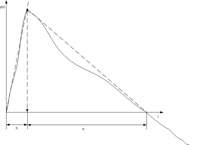

I think Soongsc have in mind only the rising part so that you can imagine it as a set of power curves (y=x^a) and tangential lines at maximum amplitude. Isn't it the ratio a slope order? Electrostatics and compression drivers have a->1 - you see a gentle curve. All in all it is difficult because:
1) Measurements contains pre ringing from aliasing filters
2) You need >500k samples per second AD
