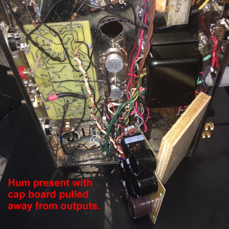

Helping out a friend with his Dynaco ST-70.
Can't get the hum outta the darn thing.
It was modified before he got it, then it came to me for help.
It had faulty wiring from the mods, which I removed and
redid. The caps were leaking on the SDS board, so those
were all replaced.
Moving Pwr tubes left to right,
Moving Pre amp tubes left to right,
Hum remains in the left channel.
Adding shorting plugs increases hum and it's not on BOTH channels.
Pulling only the left channel 7199 stops the hum.
So, I bought a new board and replaced it.
Somewhere, I read about that heater pin2 to pin2 should have continuity
and pin7 to pin7 should have continuity, but if pin2 to pin7 continuity
exists, this will cause hum. This amp has pin2 to pin7 continuity
everywhere in the amp without any tubes.
Still have hum in the left channel.
I couldn't find it with the scope.
Pic attached.
Tube replacements were also made.

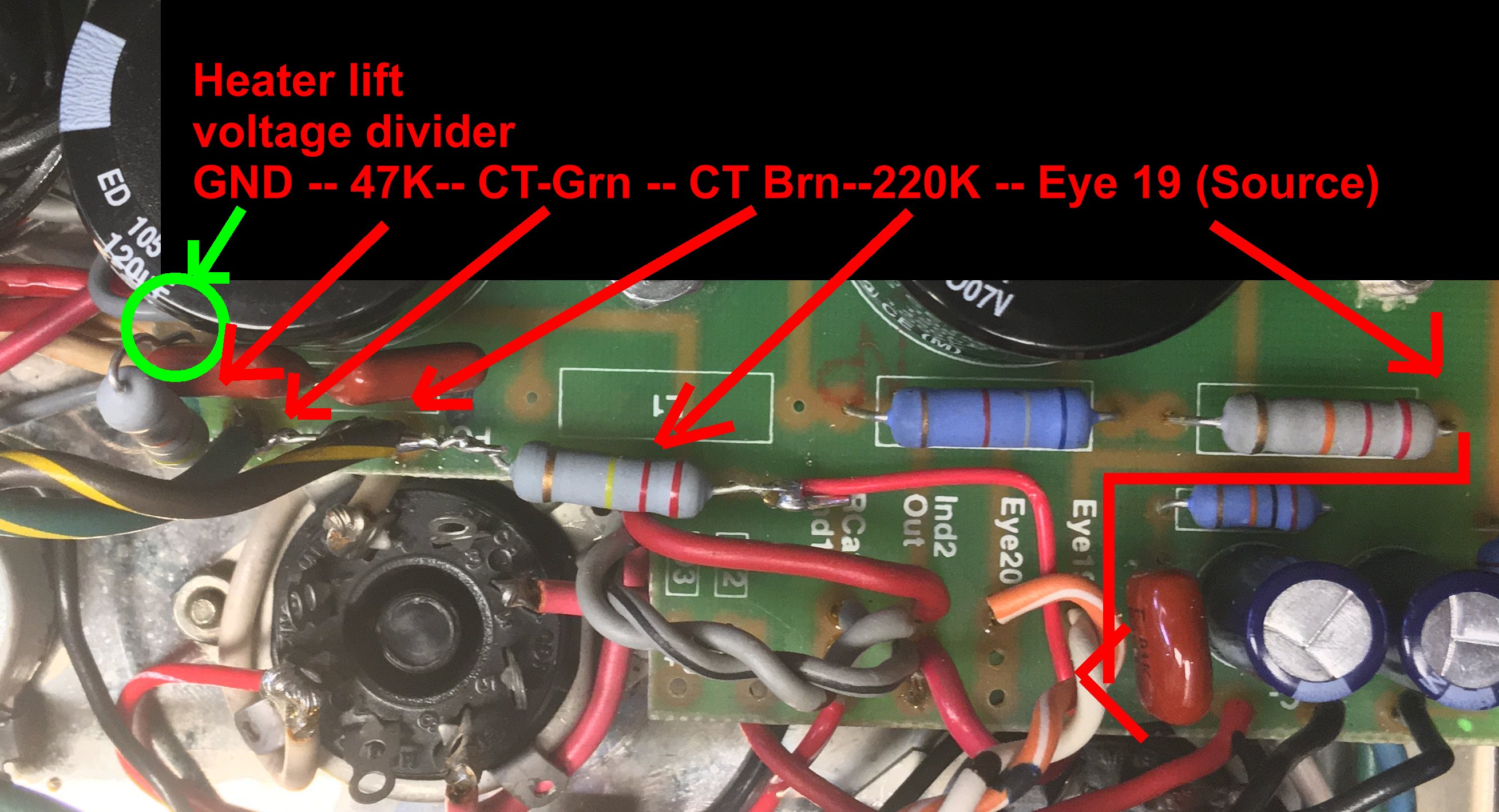

since the pentode was dc coupled to the concertina splitters, i would dc lift the heater, and since that is only one channel, i suspect dc rail decoupling for that channel.....
if i remember it right, the filaments are earthed thru 0,1uf ceramic caps...or did you took them out?

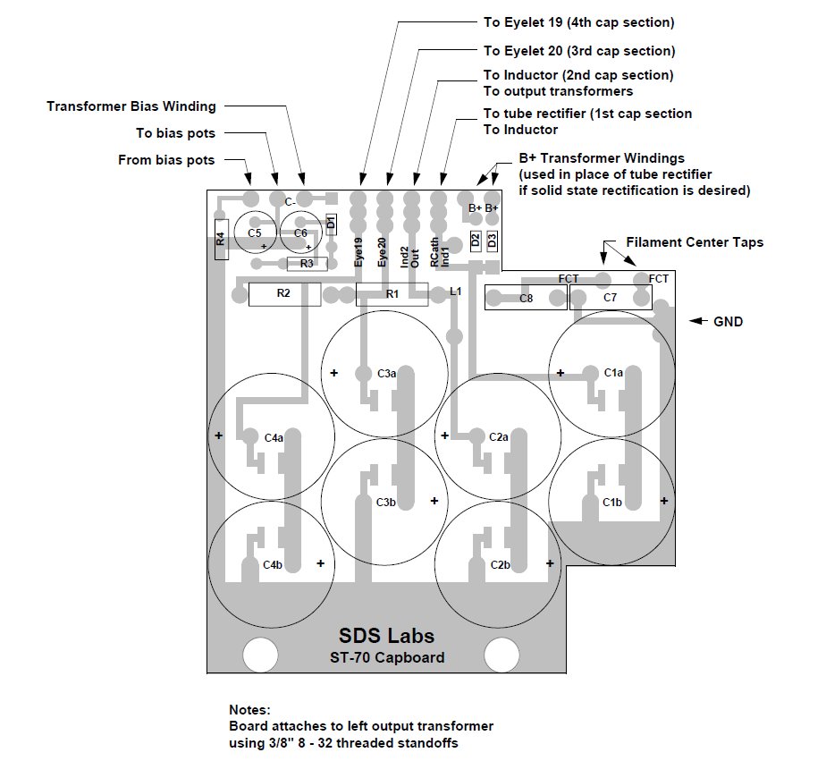

I took them out and replaced with Panasonic films.
DC rail decoupling,
To DC lift the heaters?
By adding series resistance to each end?
It looks to me like the choke is directly under one of the output transformers.
Steel Chassis . . . good luck.
On my original DYNA Stereo 70, the choke was mounted on a side wall, and Not mounted directly under one channel's output transformer.
Very Carefully . . . remove the choke from the amplifier, and use extension wires to the choke.
Try again and see what you get.
Question:
From the picture, it looks like the amplifier has been highly modified, including electrolytic caps mounted inside the chassis.
Modifications often end up with un-desired power supply ground loops, that get impressed onto the input and driver (concertina) tubes.

6A3sUMMER,
Thanks. The choke is on the other channel.
However that would be simple enough to unscrew,
and move the choke outside the amp. it would end
up about 6 to 8 inches on the other side of the Hum channel.
Yes, it has the SDS Capacitor board, came that way with
some leaky caps. I spent a good deal of time un-fornicating
the amp.
I'll replace the SDS board ground wire with a higher quality wire.
I've thought about relocating the CT wires from heaters and bias
tying them together and finding another location.

Thanks Tony,
That's a helpful link also.
So, if I read this correctly,
instead of grounding the heater center taps,
(it has two one for the left channel, one for the right channel,
each drawing 3.450A current[3.0 + .450mA])
the amp would need two of the 30 to 60v
heater lifts, with each connected to +HT.
+HT would be the main b+ line.
There is one 30 to 60 volt feed for each center tap.

Heater CT Lift, Start of Lift;
273Vdc, .006Vac-->220K--48Vdc, .020Vac-->47K-->GND 0Vdc, .004Vac.
But didn't add extra filter cap because the cap board has a .1uf 630V panasonic
for each Heater CT. See post #6, C7, C8. Maybe I can link it here:?
https://www.diyaudio.com/forums/att...o-st-70-60-hz-hum-channel-st-70-sds-board-jpg
Or do I add another 10uf, 100uf, 220uf or larger at 100V or larger?
from local ground back to the middle of the series resisters and CTs?
If it's a heater CT, don't these love big caps? 2200uf or larger?

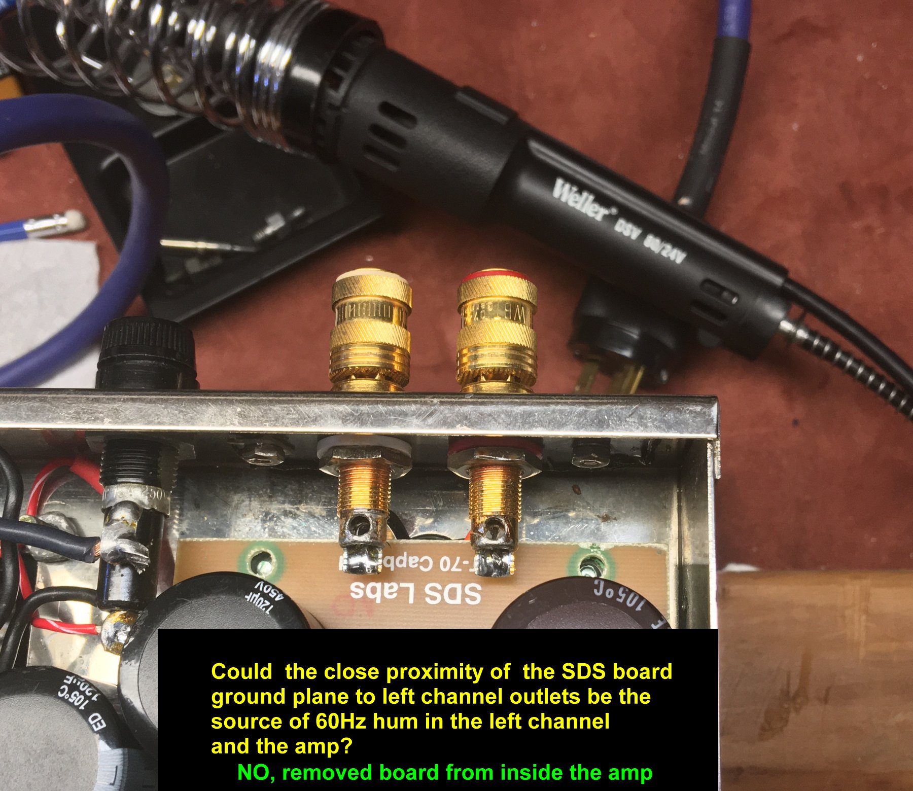

Is the chassis connected to ground or is the chassis floating with no ground ?
As I've stated throughout the posts, a three prong power cord has been
installed, the GND connection soldered to the chassis, on the transformer
hold down screw. Please see the pic in post #1, green arrow call out.
Here is how I installed the CT Heater Lifts.
Cap board close to outputs.
It didn't make a difference - hum still present.
