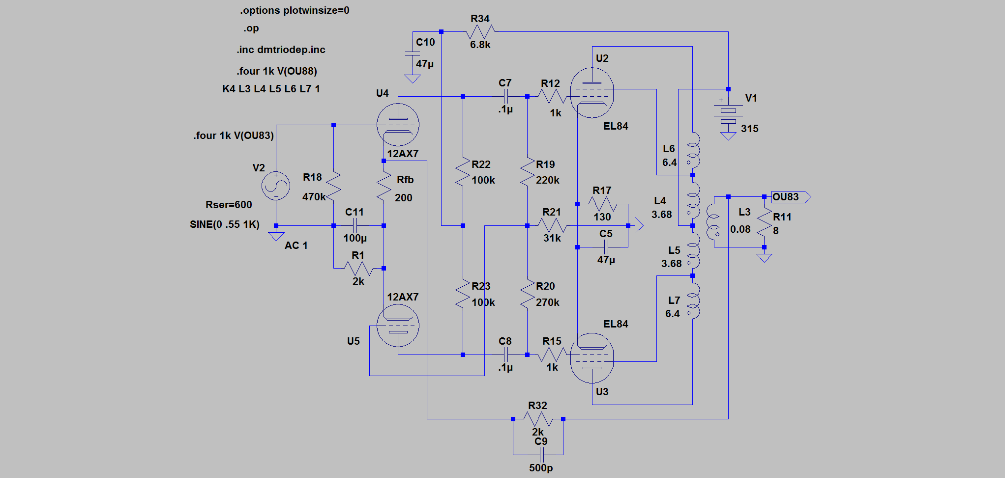

Thanks everyone for all the suggestions. I implemented them all and have a much better amp now. But I hate to say its not quite right yet. The amp sounds a bit too bright. And at higher volumes it is a little distorted. I think it may be there isn't quite enough feed back. I think the problem is the original draws feedback from the 16 ohm output, I don't have one. I'm drawing from the 8 ohm. Which I think means I have about 25% less voltage than the original design. At idle I measure 1.55ma drawn by the 12ax7s. So if I go down on the feedback resistor I will allow the 12ax7's to draw more current is that right? How can I increase feedback without increasing the current? Or is the feedback resistor not acting as a cathode resistor?
The feedback resistor IS part of the cathode circuit. But you can still make some adjustments to it for the amount of feedback.
The feedback R is 1K and on the 16R tap. That is identical to the OPT feedback system of the original ST-70. When the ST-70 Series 2 came out they moved the feedback connection to the 8R tap and changed the R to 680R. I'd find a 1K pot to experiment with replace the FB R with the best value from the pot ABOVE 680R.

I've gotten the amp finished and it really sounds nice. I'm using 6N6C Russian 6V6 variants and Hammond output transformers so I'm not sure if what I found will help. I used an 820pf cap for the feedback. After inserting a pot I found that the best sound was with about 600 ohms on the feedback resistor. I ended up using 560 ohms because I had them. I separated the preamp tube cathode resistors and stuck with the 1k but didn't ground them threw the output secondary. I also changed the output cathode resistors bypass cap to 33uf rather than the 50uf the schematic calls for. The Hammond's don't have the low frequency performance of the Dynacos. I tried a pair of 12AY7's in the front end but it didn't change the sound much and cost too much gain. I tried JJ 12AX7's and EH also. The Electro Harmonix sound better. My Snells are fairly inefficient but the amp had a nice rounded mid range, well defined highs and more bass than I would have expected from a ten watt amp. I think most of the problems were just not enough feedback.

Im also into tweaking the feedback but I'm a bitt puzzled about doing it on the 1k resistor since it also changes the working points of the splitter. My recent plan is to try to locate best value the feedback bypass cap with a scope and also set the splitters balance with the 47 k resistor first.

I departed from the schematic and separated the feedback loop from the cathode resistor. I used the 1k resistor to ground the cathode to the star ground NOT through the output transformer. Then used the feedback loop on its own. The design was nice in that it could use a single loop for the cathode and feedback. But I suspect it only works with those transformers.

Racer,
If you have a 560R feedback from OPT to cathode you have just paralleled with the 1K and now have @ 400R (without my calc.) as cathode resistance instead of the original 1K.
racer; where do you insert the feedback? Can you do a little scetsh of the input cathode couplings?

Hey,
You seem a little lost here!
This way you can adjust NFB anyway you want it, without messing up the working points.
Use Rfb to adjust.
Working points are per the original circuit.
Also note, assymetry from the original driver signal must be adjusted. Make R19 220k and use a 100k trimmer for R21.

If you don´t want a trimmer, substituting R19 with 240k will give you a theoretical assymetry in the ballpark of 0,3dB. If you keep the original 270k, assymetry will 1,5dB. But no worry, it is mainly 2H that is affected.
To get rid of driver assymetry! See post #35 and #36. Gain of anode follower U5 must be adjusted for exactly 0dB gain. Not possible with 270k.
OK Revintage,
I understand the change to the schematic. But how do I measure the adjustment? Is this like an AC balance adjustment?
