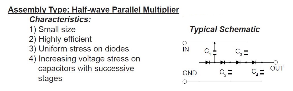

Take no prisoners, when setting up the 12AX7 DC heater supply. A 3 stage 1/2 wave parallel voltage multiplier, energized by 5 VAC, feeding a 7812 3 terminal regulator does exactly that. 300 mA. of 12 VDC takes care of 2X 12AX7s and that should not be problematic. Don't worry about 12 V. vs. 12.6 V., as it is well within tolerances.
The appropriate value of the phase compensation cap. bypassing the 1 Kohm NFB resistor is tied directly to the characteristics of the specific O/P trafo being used. The correct value for the cap. is determined experimentally by feeding a 2 KHz. square wave into the amp and tweaking things to get the best looking product at the speaker terminals, using an Oscilloscope. Let us know if you don't have the requisite O'scope and signal generator. In that event, we'll discuss your options.
