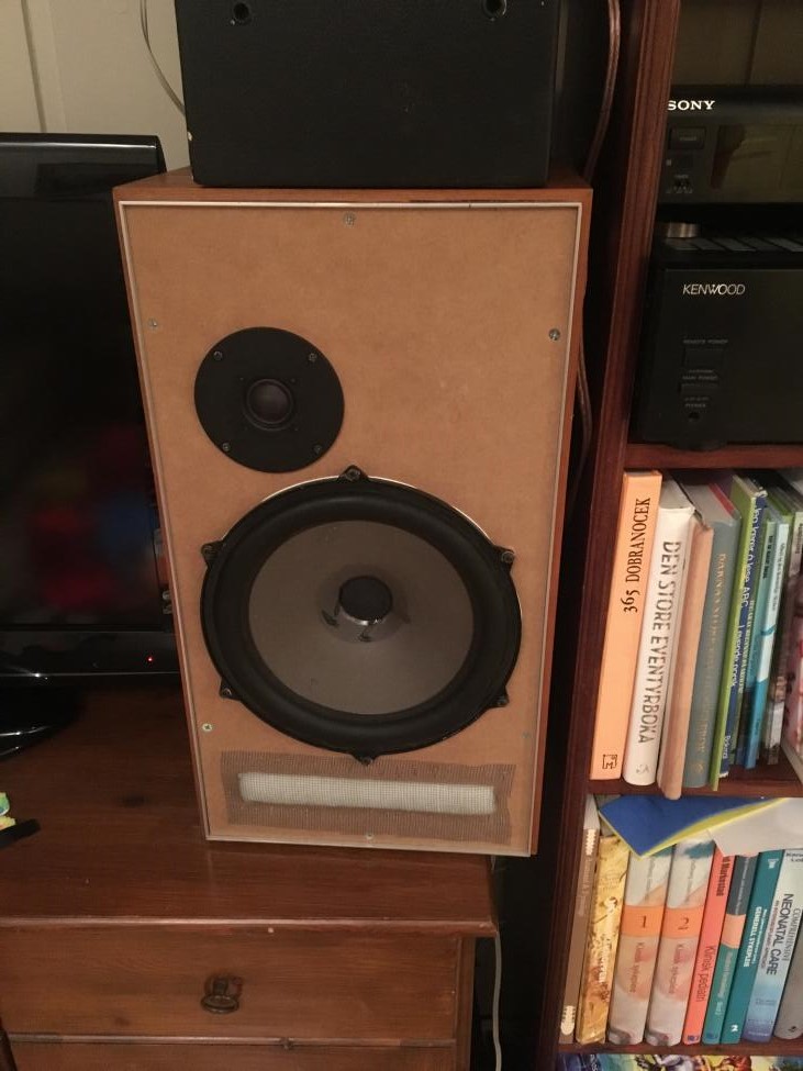

Just built a version of this, but with Seas 27TFFFC instead of the original H087 tweeter. Filter is 4.7 uF and 2.2 ohm. I have never heard the original Dynaco 25, but I am stunned by the sound they make with the 27TFFC tweeter.
It is detailed, and at the same time exremely relaxed. It can play loud without being tiring. When pushed very hard on some music you can hear the tweeter struggling a bit, but this is at sound levels much higher than I ever normally listen to.
It is strange to me that a 10" bass/midrange can provide so good midrange! Both male and female voices just sounds magical. I wonder if this is because the lack of filter on the woofer, or is it just an exeptional good driver? It is hard to be believe it was produced in 1971. Bass is not very deep but fast and always present, without being too much.

This is mine - her name is Trudy 🙂
There is a coil - no switch and 2 caps of 12 µF each
a connected 3 Ω and a not connected 2Ω innit 😉
