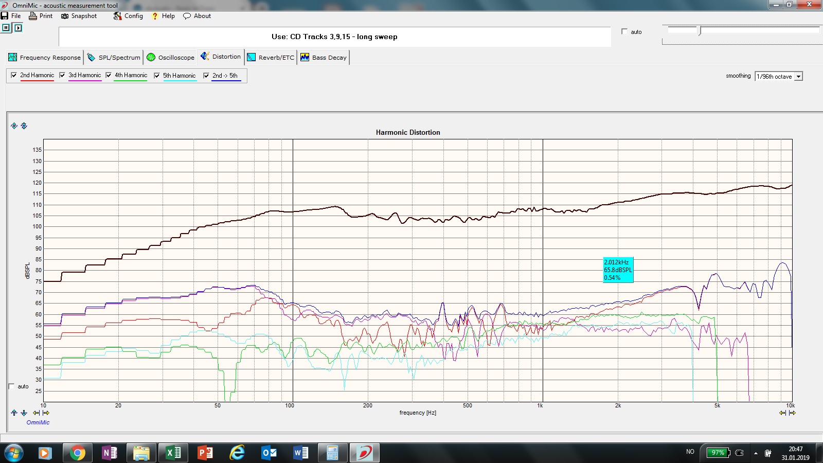

Measurement sound pressure-distortion, Seas 27tffc, without a filter :

I make measurements of tweeters on a sweep-tone, 1 W, 0.5-1 meters, but I do not sweep in the entire band - only 2 times the frequency above the tweeter resonance.
Then I transfer the level of THD - total harmonic distortion from decibels to percentages, according to the table. And I choose the filter frequency where the tweeter distortion is reduced to a minimum.

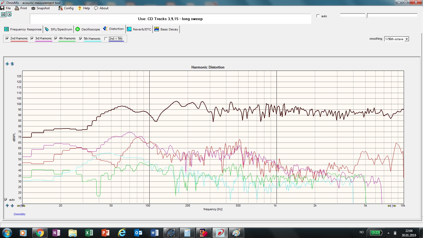

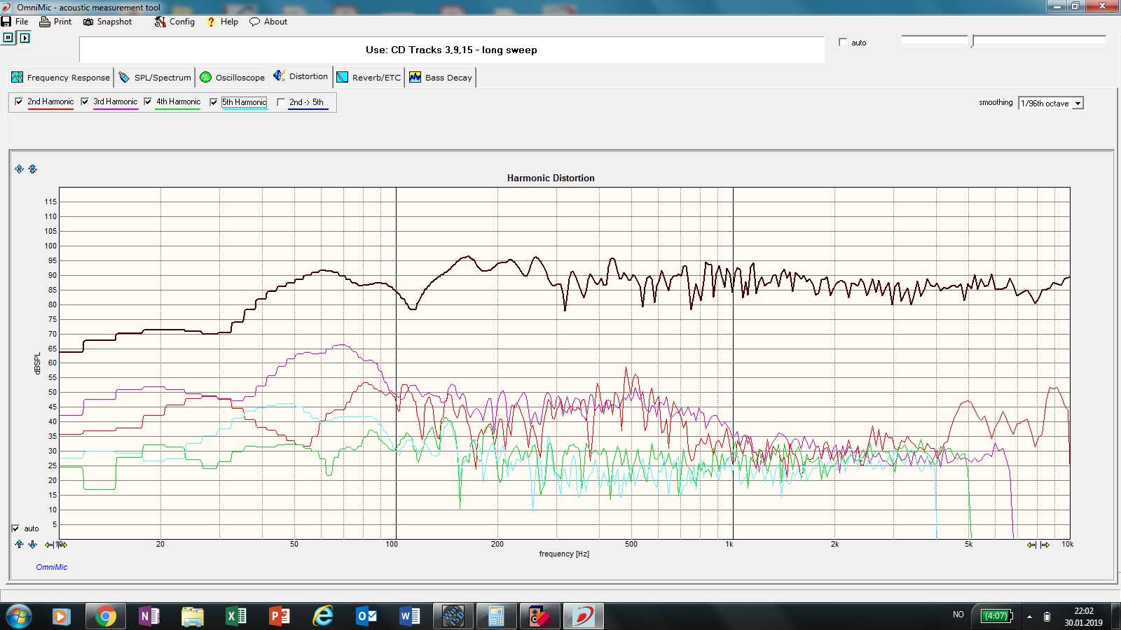

Not sure i do it right but how does these distortion measurements look?
MIC is at 1 meter in tweeter height.
normally, distortion is measured in the near field unless you have an anechoic chamber to measure in. a very large and quite open space will do too. to get accurate results you need to have a large level difference between direct sound and any reflected sound. measured at 1 meter in a normal room then your measurements are only valid at higher frequencies.
That close to a driver only works good on one driver at a time.
If your crossover is biwired then you can disconnect the driver not to be measured
