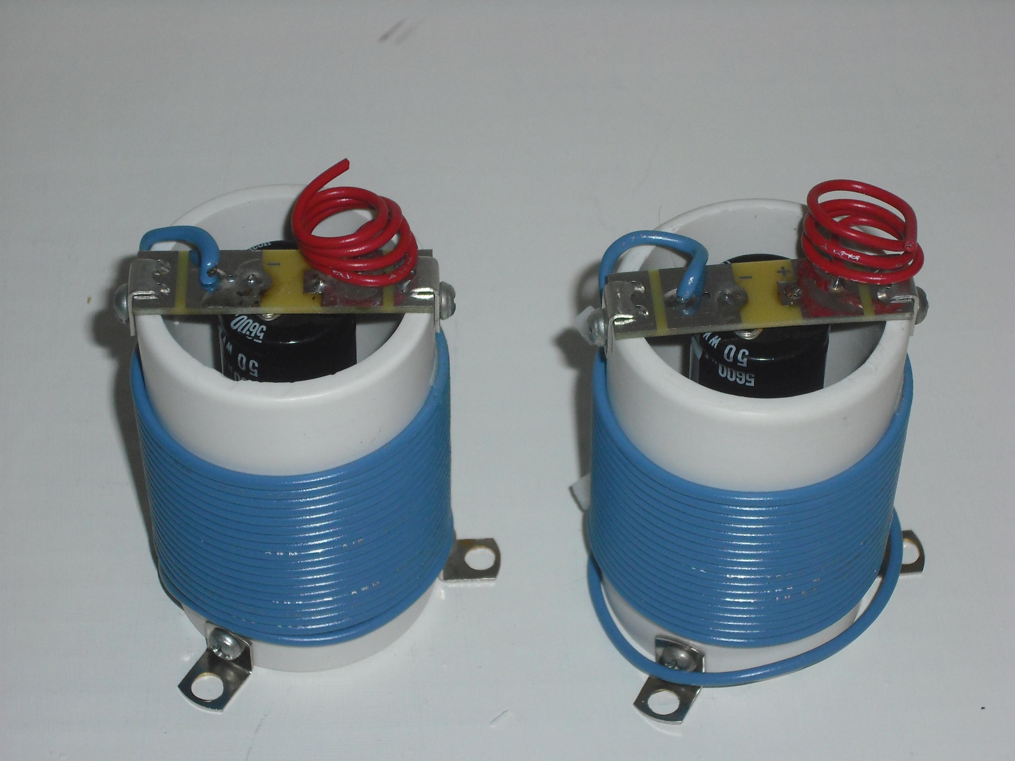

I built two 8 transistor bias current setter circuits on perfboard and mounted them on little brackets above the old output caps, because the new caps are so much smaller. I glued the new caps down, they dont fit the brackets.

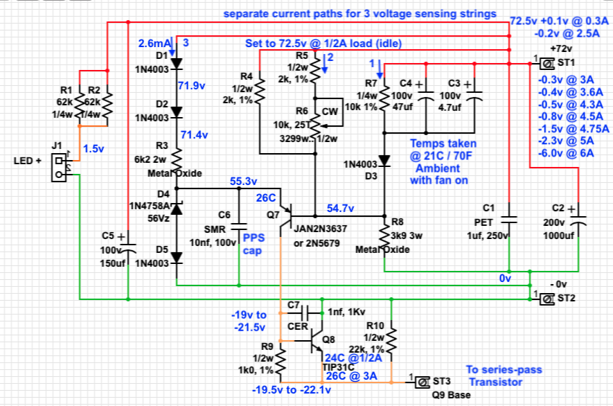

Can anyone recommend which transistors to use for PC-14 in the power supply?
Q7 was 2N4037, Q8 was 2N5320, and Q9 was 2N4347.
I have seen:
Q9 replaced by 2N3442,
Q8 replaced by TIP31C,
Q7 replaced by 2N4036.
I'm thinking of using:
MJ15003 for Q9, larger SOA... mounted on a large HS
MJE155028 for Q8, larger SOA
ECG323 for Q7, higher voltage TO-39... (maybe MJE15029)
I have read D. Joffe's "Circuit Description for the Dynaco Stereo 120 Power Supply".
It describes the current limit in Amps is about:
[β (Q8)] x [β (Q9)] x 0.0014 ≈ 120⋅37.5⋅0.0014 = 6.3Amps maximum.
That depends on the [hfe of Q8] x [hfe of Q9] x [Q8 base current].

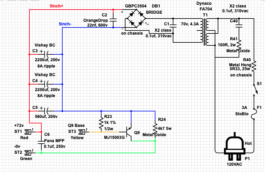

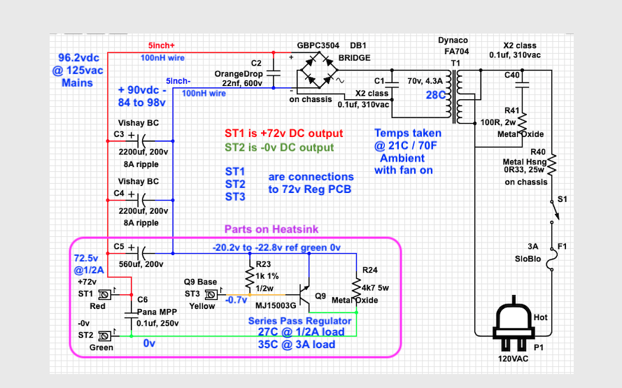

72volt regulator works great now... within 1/2% up to 3A and 1% up to 4.5A.... cuts current above 6A load.
I'm using:
Q7 = 2N3637 JAN
Q8 = TIP31C (100+ hfe)
Q9 = MJ15003G
attachment.php
attachment.php
Note that the regulator PCB has only 3 connections to the rest of the circuit.

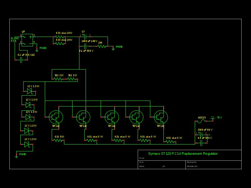

With a NET60 as Q9 and something TO220 I don't remember as Q8, my PC-14 was dropping the rail voltage at 3.5 amps load instead of 6.25 as originally designed. I concluded, perhaps incorrectly, that higher gain of modern transistors was messing up the performance.
Replaced PC-14 with a point to point build of a zener 72 v stack driving 5 parallel TIP142 darlington regulators, to the original 3300 uf cap. Mounted the TIP142 on a Pentium2 heat sink. Replaced the current limit feature of the PC-14 with 10 A fuses to each PC-15. Have never blown a fuse.
With one 3300 uf rail cap driving both channels, I got 23.7 VAC out of both channels on 8 ohm speakers for 5 seconds on Rhianna Shut Up & Drive
70 watts per channel. I do have 2 PCAT fans and extra TO3 fins attached to the original heatsinks. The TO3 fins won't fit under the transistors.
