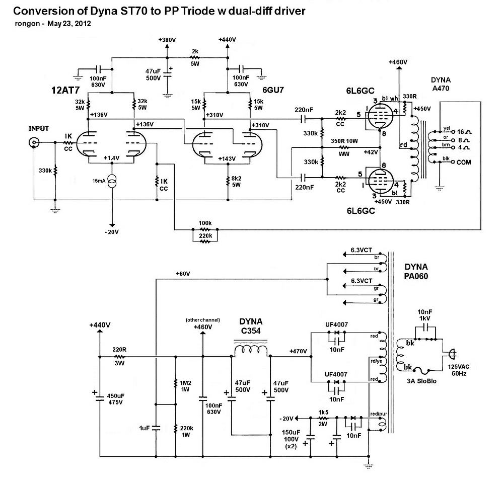

Dyna ST70 to Dual-differential EL34 triode amp project

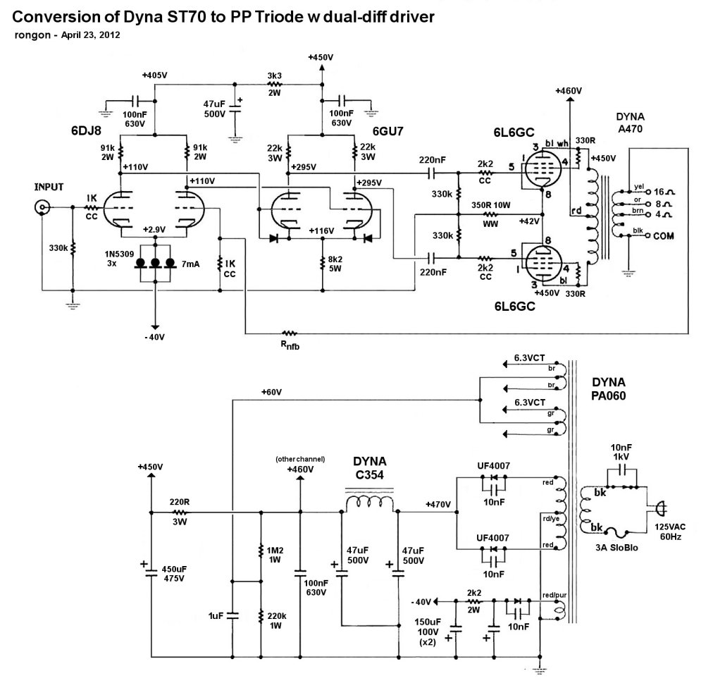

Those CRD's aren't worth using anymore. I got a bagful back in the 1990's, because I didn't know any better. I only used them in this amp because I'm clearing out my parts drawers. I'd use an LM334 if I didn't already have these.
I updated the schematic from April 17's post. It should show the corrections. It also shows the new feedback resistor value (see below).
It also shows some of the updates that resulted from last night's testing. And speaking of testing...

I changed the first stage plate resistors to 91k (actually 100k||1M), and changed the second stage cathode resistor to 8k2. The NFB resistor is 100k right now, which is a high enough value that you can't tell it's there. So I'm listening open loop for now.

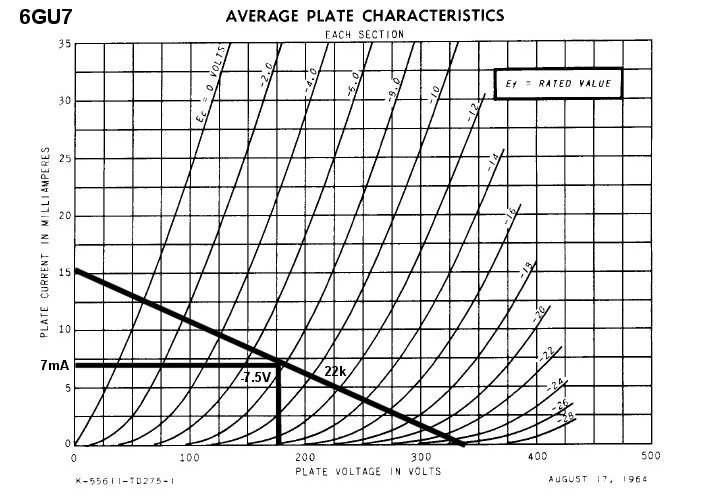

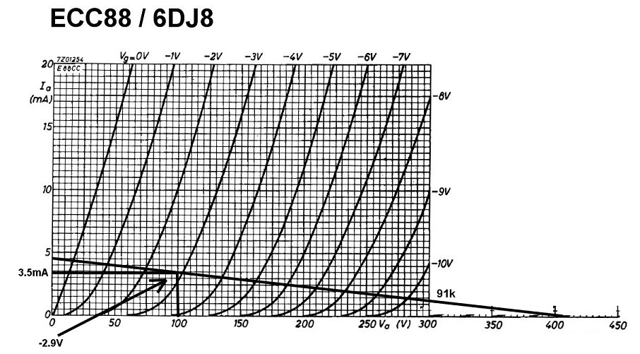

Loadlines for the 6DJ8 (first stage) and 6GU7 (second stage)
The real life 6DJ8 doesn't agree completely with its spec sheet.
Incidentally, this turned out to be a mere tweak of a circuit JC Morrison published in The Tube Audio Primer back in the early '90s. That, in turn, was nearly identical to a circuit by Arthur Loesch published in Sound Practices, in the "Few Stones Left Unturned" article. It still sounds really good.

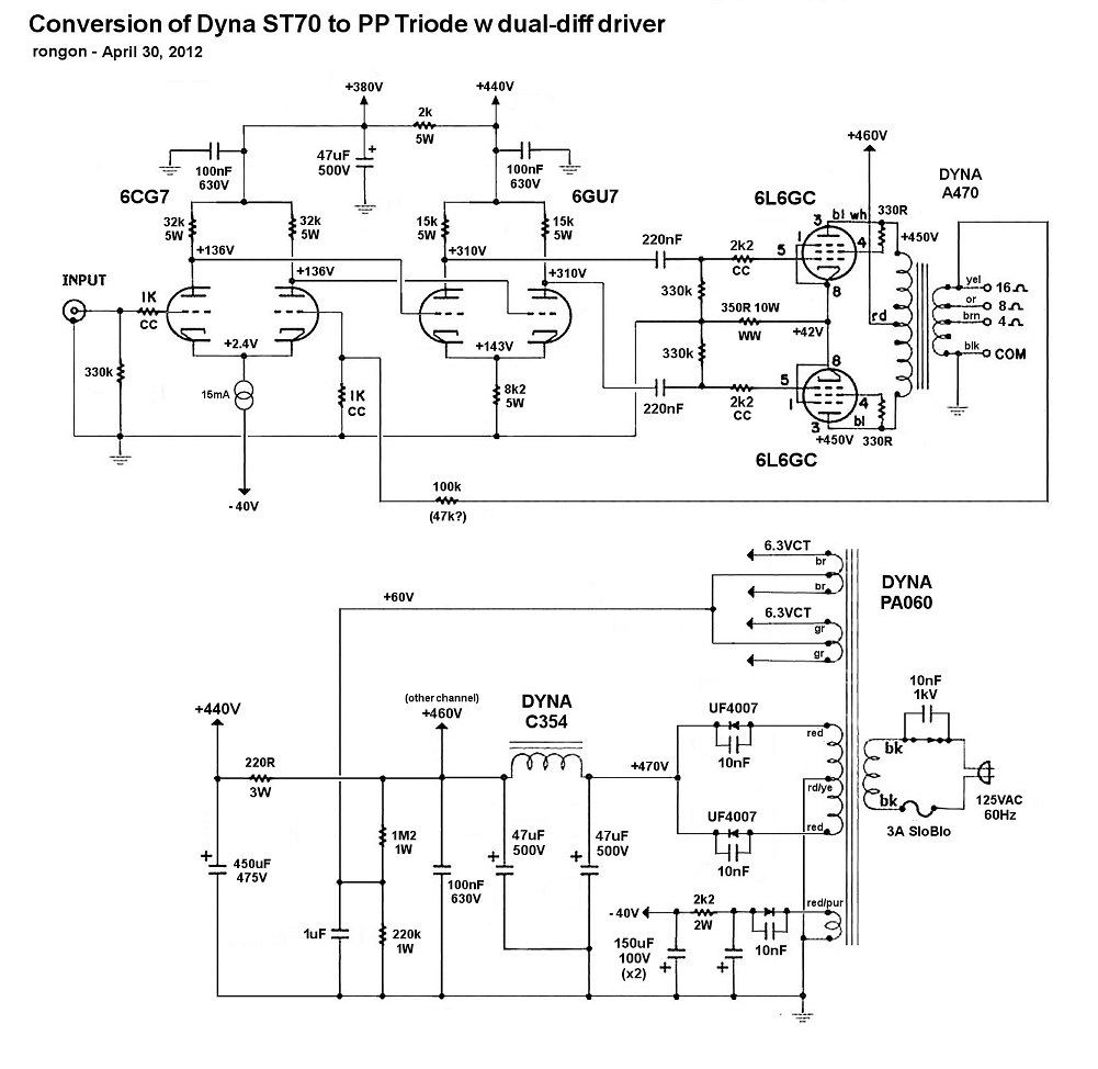

Schematic below.
The loadlines for the 6CG7 (input LTP-phase splitter) and the 6GU7 (push-pull driver).
They're certainly steeper than the ones I used before, yet they sound better. Higher current operation in the first stage sounds better? Maybe I like a bit more distortion from the second stage? I dunno...

After goofing around with the amp for a couple of weeks...
When I had the first 12AT7 version (82k plate resistors, 3mA per triode) of the amp on the scope, it had 10dB of gNFB and showed a little spike of overshoot on square waves. Well-damped and still square at 10kHz, though. The amp at this point was -3dB at 170kHz. I figure that's pretty good for an amp using Dyna OPTs.
Open-loop, the amp is -3dB at about 34kHz.
Then I brought it home, changed the first tube to 6CG7 with 7.5mA thru each triode and 32k plate resistors, decided I didn't like the sound as much as with the 12AT7. I put the 12AT7 back in the first stage, but this time with the 7.5mA and 32k plate load resistors. I like this, even though that is only about a 2:1 ratio between plate load and rp. What the heck, it sounds good this way.
The 6CG7 1st stage LTP never sounded full-bodied enough for my taste, even with a good 4:1 plate load to rp ratio, and after getting the plate current up to 7.5mA. But the 12AT7 with that much current floats my boat.
I reduced the gNFB to an estimated 5dB. The bass is a bit loose, but the mids and highs are nice.
I like it enough this way that I have no plans to change it. I will try to get it to my friend's bench for testing.
PS - I'm connecting my nominal 8-ohm Snell Type J/III's to the 4 ohm taps on the OPTs. That should be doubling the apparent primary load, hopefully from 4k3 to 8k6:VC. If that's correct, then that is a very good load for triode-wired 6L6GC's.
No, I couldn't leave well enough alone.
Well, I'm enjoying this amp. I changed a few things, basically dialed in the operating points to what I think are better ones.
- Changed the CCS in the 12AT7 tail to 11mA
- Changed the 12AT7 plate resistors to 47k
12AT7 op points
B+ = 400V
Va = 150V
Vg = -1V
Ia = 5.5mA
- Changed 6GU7 tail resistor to 9k
- Changed the 6GU7 plate resistors to 13k
6GU7 op points
B+ = 440V (295V plates to cathodes)
Va = 175V
Vg = -7V
Ia = 9mA
I tried increasing the bias through the 6GU7 by decreasing the value of the cathode resistor, but it made for severely imbalanced voltages side-to-side. With 12mA per 6GU7 triode (using a 6.2k cathode resistor) one 6GU7 triode had only -1V bias while the other had -10V bias. Obviously one side was hogging all the current. This is dependent on the 6GU7 I was using, but the one that exhibited the problem tests good in my tester. So I gave in and set the circuit so it would balance well enough with whichever tested/good 6GU7 I put in there.
