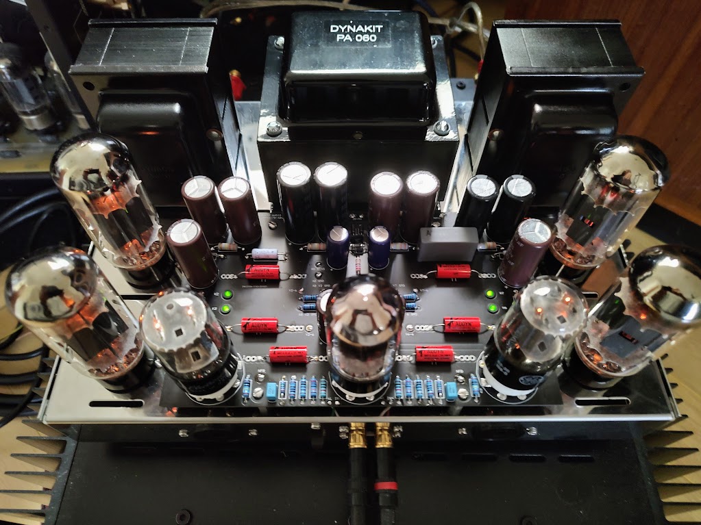

I'm responding late to this thread however, I didn't see mention of the Dyna-70 Ultimate Upgrade as a possible ST-70 upgrade option. Originally offered by Erhard Audio, we purchased the rights in late 2022 and have made several upgrades since its release. It is available in both an Auto Bias and Manual Bias configurations, and unlike most ST-70 audio driver updates, we feature a complete Power Supply upgrade which the ST-70 really needs, however, this upgrade gets expensive fast- but we think its produces the best sounding ST-70 upgrade on the market. Visit milleraudiollc.com for more info.
The PS upgrade gets rid of the GZ34/5AR4 Rectifier Tube, the 4 section cap can, uses parallel "stacked" caps, doubling the operating voltage (800-900V) over what most cap cans safely operate as well as increasing capacitance to 90/110/50/50 mF as compared to the cap can offerings, and uses the more powerful PA-060 from Dynakit Parts. It also features a temperature compensated LM334 and like mentioned above, we have had good luck and great performance when using the temp. compensated mode as recommended by TI / National Semiconductor.

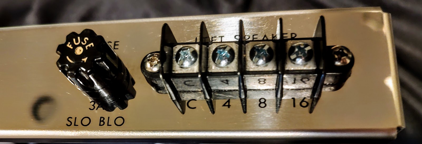

We've introduced some new terminal blocks that are a perfect fit for an ST-70 - no hole drilling and looks as if these were designed just for the ST-70; they also fit the Mk II, Mk III & Mk IV mono block amps as well.

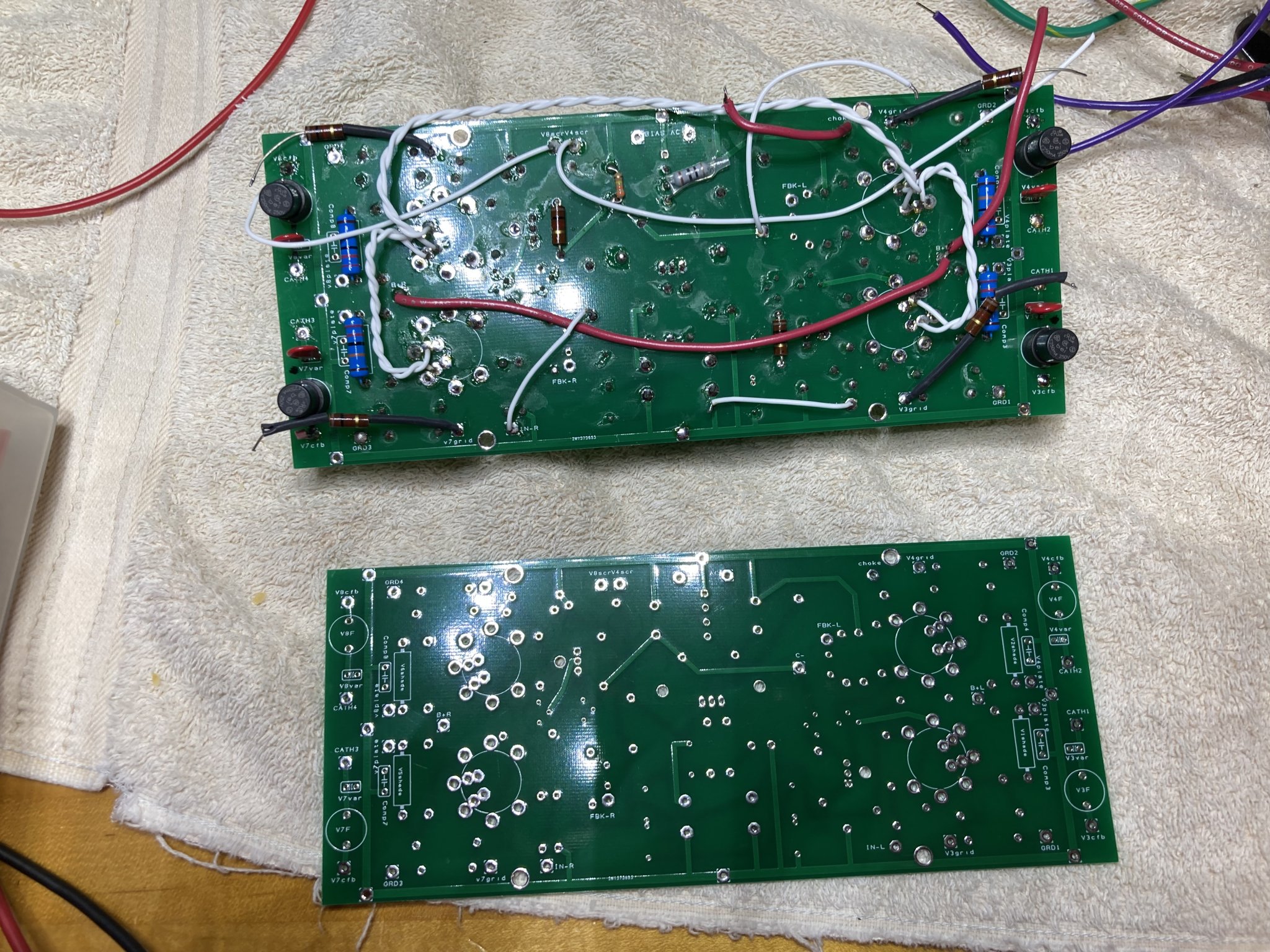

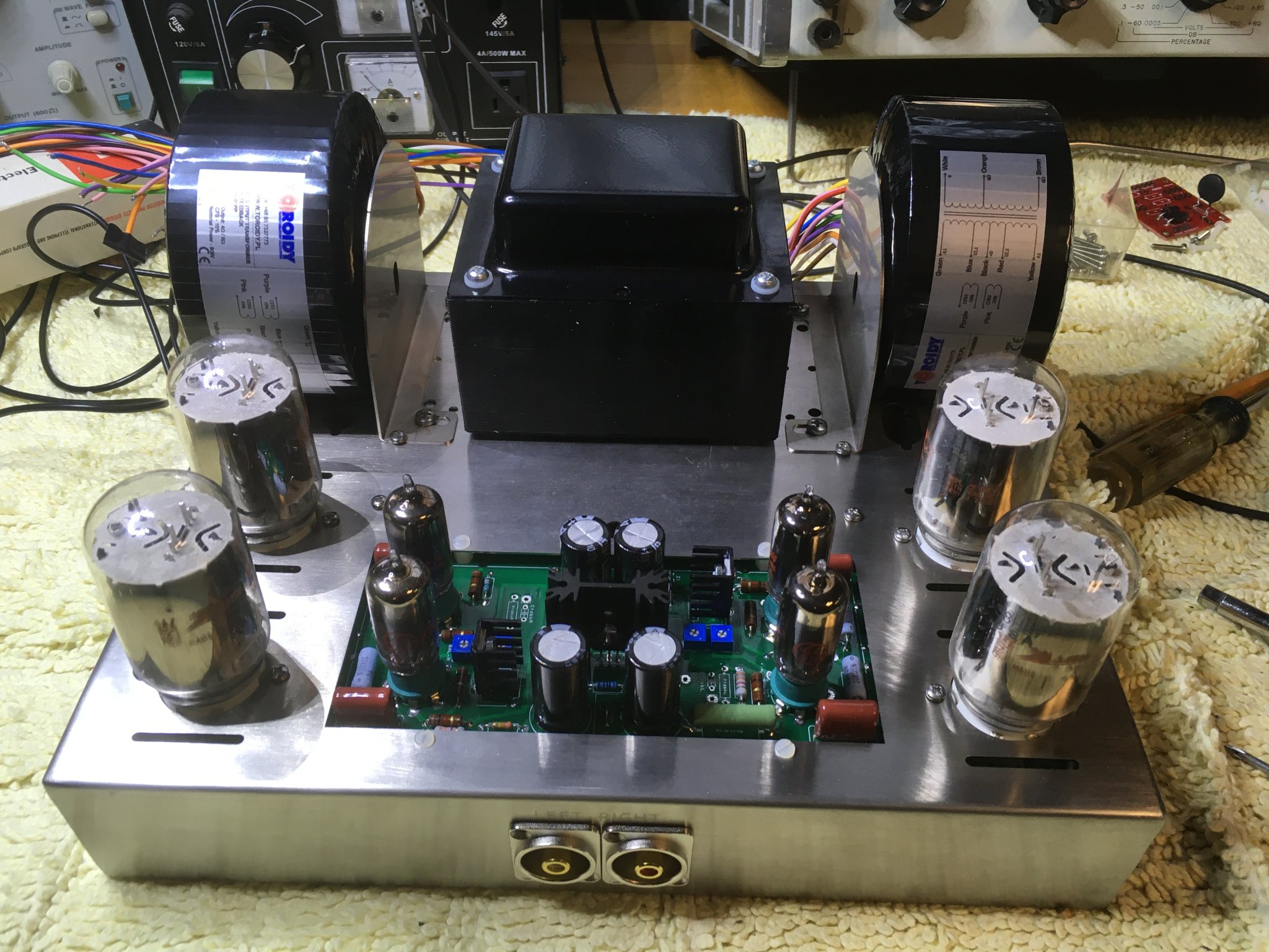

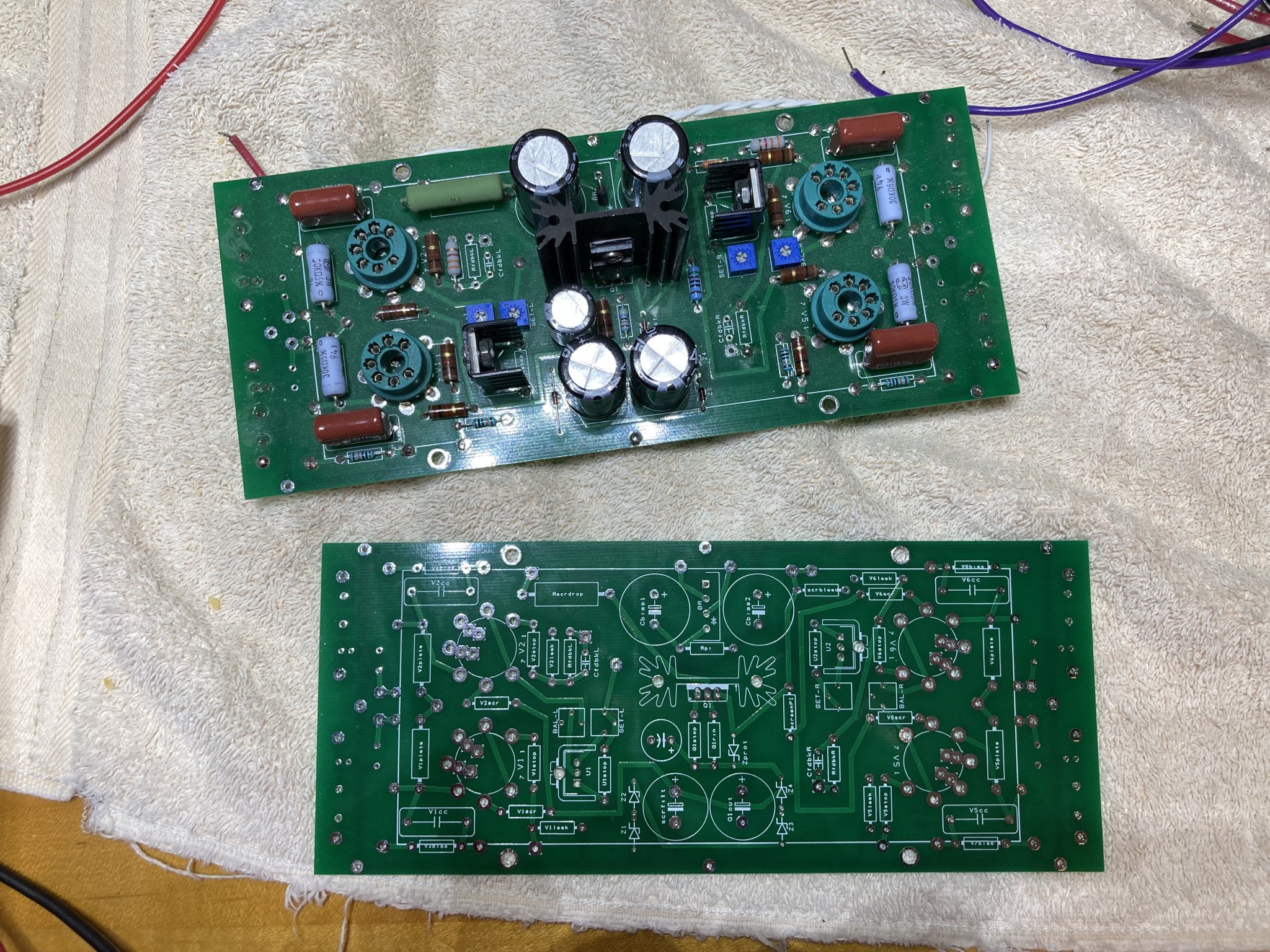

Nearly 3 years ago I made an effort to design some boards in DesignSpark that would fit a Dynaco ST70 that contained, for the most part, the DCPP amp circuit by Pete Millett. It seemed successful as I got it to work with 38HE7 output tubes and 6GU5 tubes in the driver pcb.
Those are Toroidy cathode feedback OPTs.
I designed the board to work with an available auto-bias board. I've since disassembled the amp but I still have the assembled driver board and a few extra prototype pcbs if anyone is interested in them PM me.
