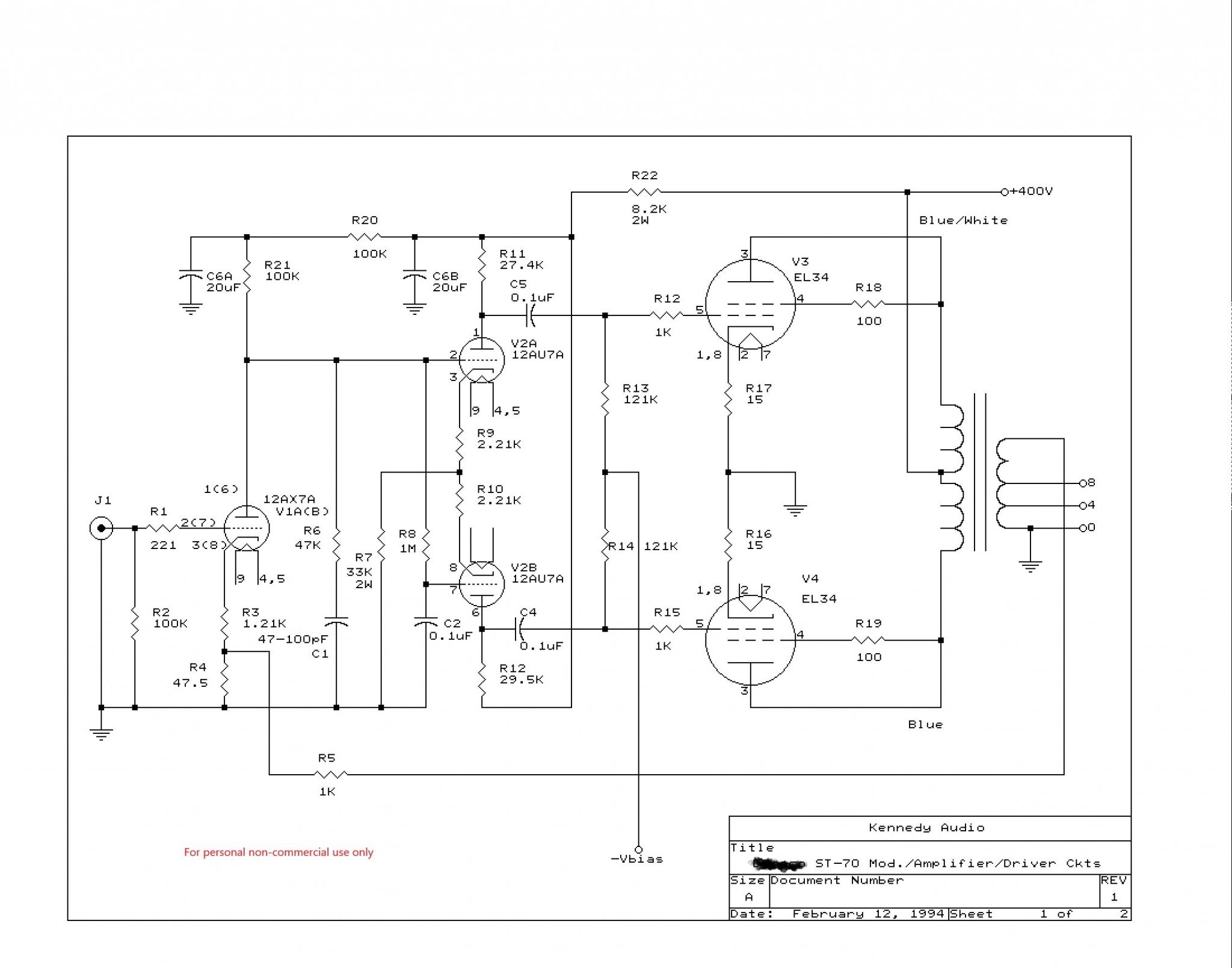

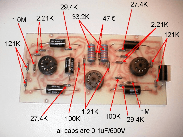

Just so no one is confused the KTA ST-70 mod Dave referenced in an earlier post has not been available since the early 2000s. The design was licensed later to a very well intentioned entrepreneur, but did not do well in the market due to considerable competition from better known outfits and designers. How many of you even knew that I designed audio equipment professionally for a living for >15 years? 🤣
That design is now over 30 years old, hopefully my old competition has innovated a bit over the ensuing years. The design was very loosely based on the Mullard 5-20 topology. I used a 12AX7 shared between both channels, and a single 6689/12AU7A/12BH7A as a long tailed pair to drive the outputs. It worked well. Today I would probably use a 6CG7/6FQ7 in place of the original 6689.
This is what the KTA ST-70 board looked like should you happen to run across one. I hand taped the PCB in the late 1980s using transfers etc from Bishop Graphics. I don't appear to have a modern schematic for this. (Now only on paper if I can locate it.) I think all told I sold about 30 assembled boards, and retrofitted somewhere around 5 amplifiers for customers.

Found the schematic. Shared here for personal use.
