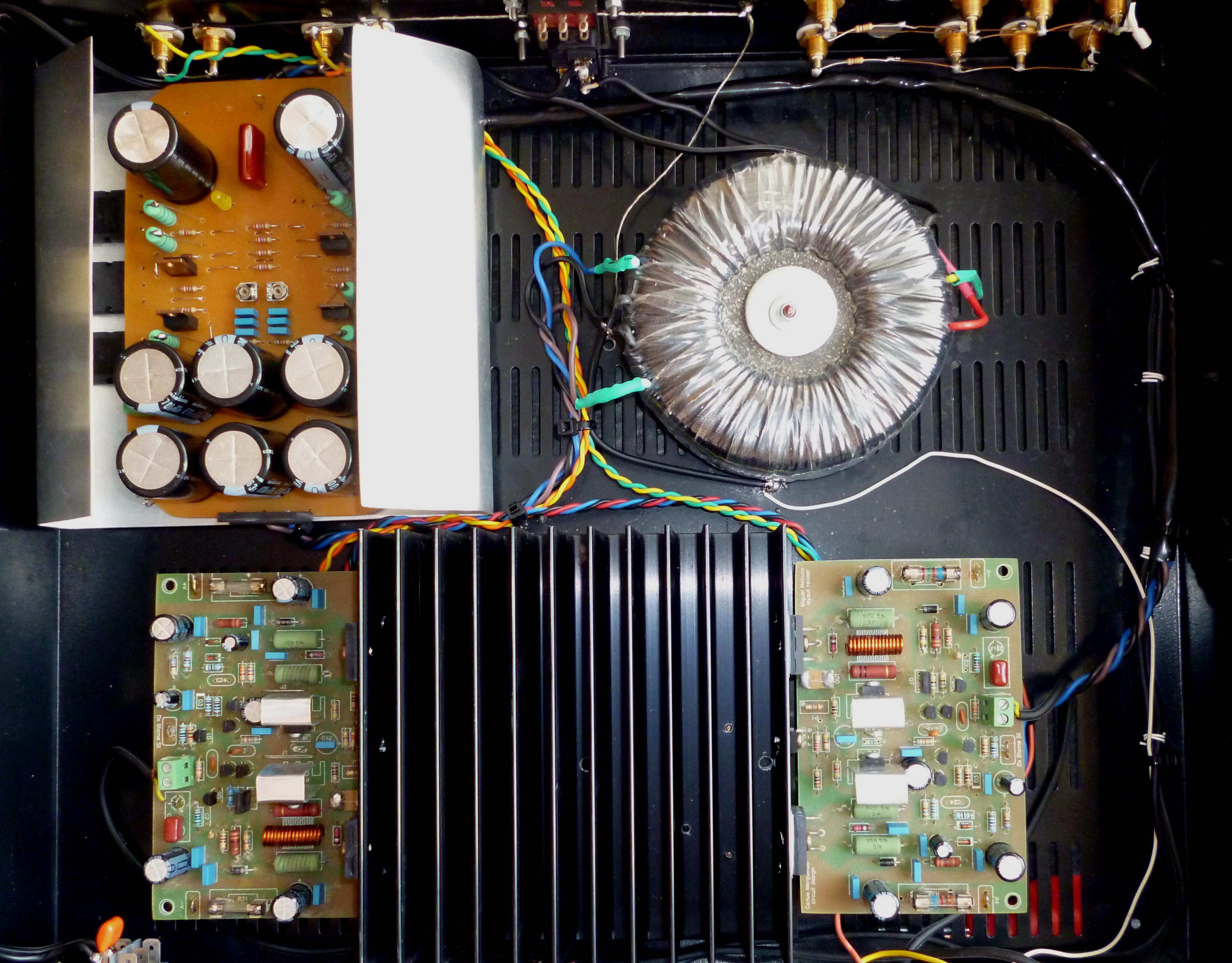

A picture of my home unit
Not finished, this pcboard was for test purposes, it was shorter than needed....this way i had no room for more condensers and will install them rigth side, where you see a clearance.
No boards here are official ones...all them prototype, the supply made at home and the Dx Super A was assembled using Dx Blame ST brazilian group pcboards.
Soon i gonna have the official pcboards from Zimmer and from Juan Vargas..then i will assemble the real thing.
This is my home amplifier, the one i use to have fun, to make modifications and to test ideas.

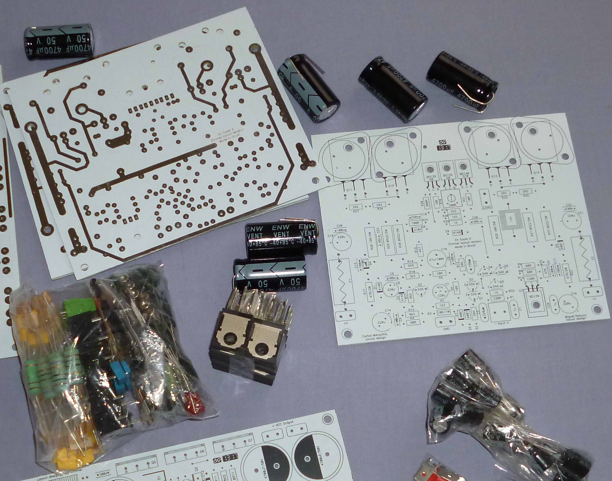

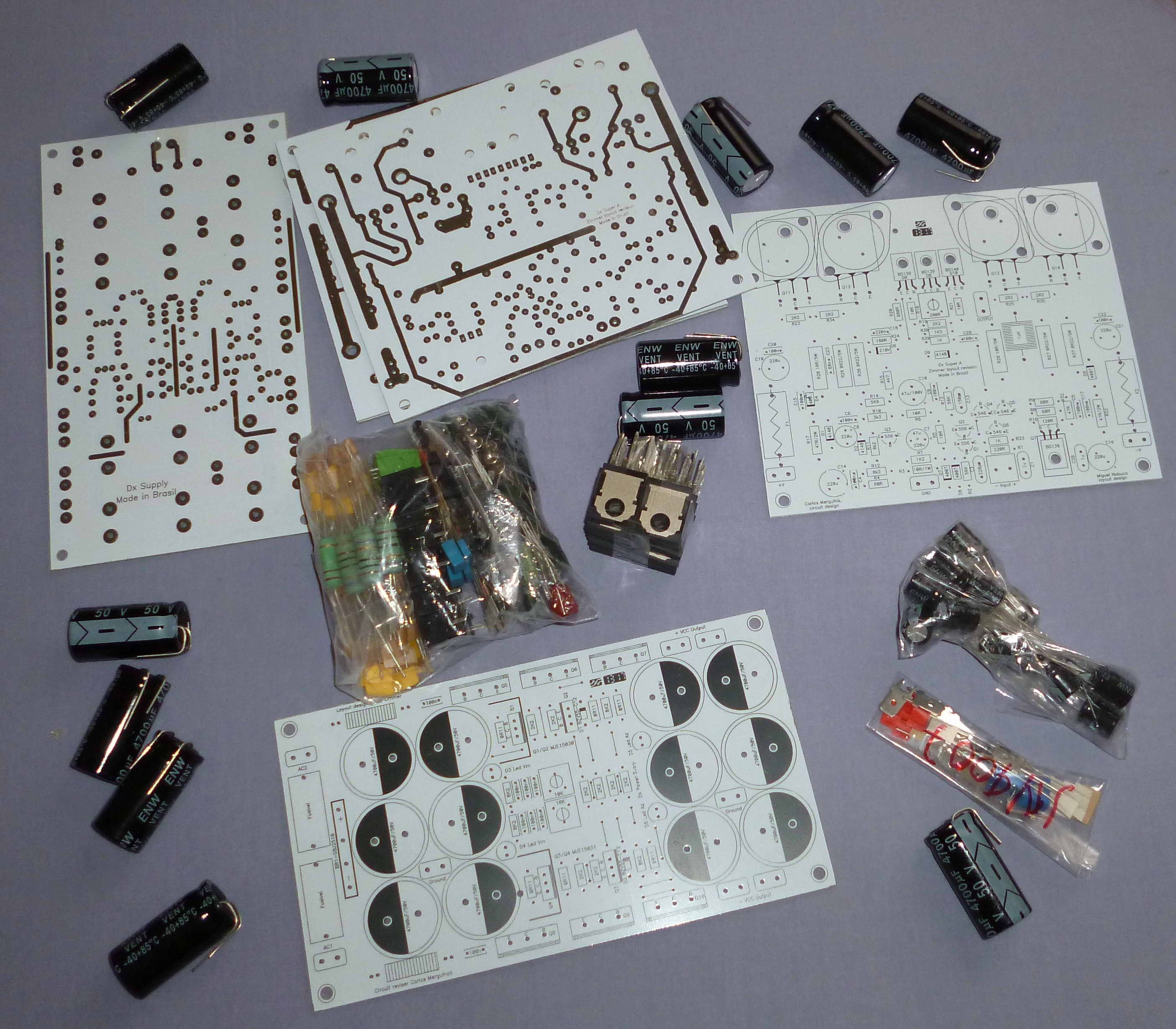

Here you have parts to build a Dx Supply
Here you have some pictures.
We are NOT offering to the international community due to the lack of confidence we have related Brazilian Postal System...in other words..we cannot guarantee the package will arrive your place...if you want to take the risk by yourself..then go to Zimmer:
imap.eletro@gmail.com
regards,
Carlos

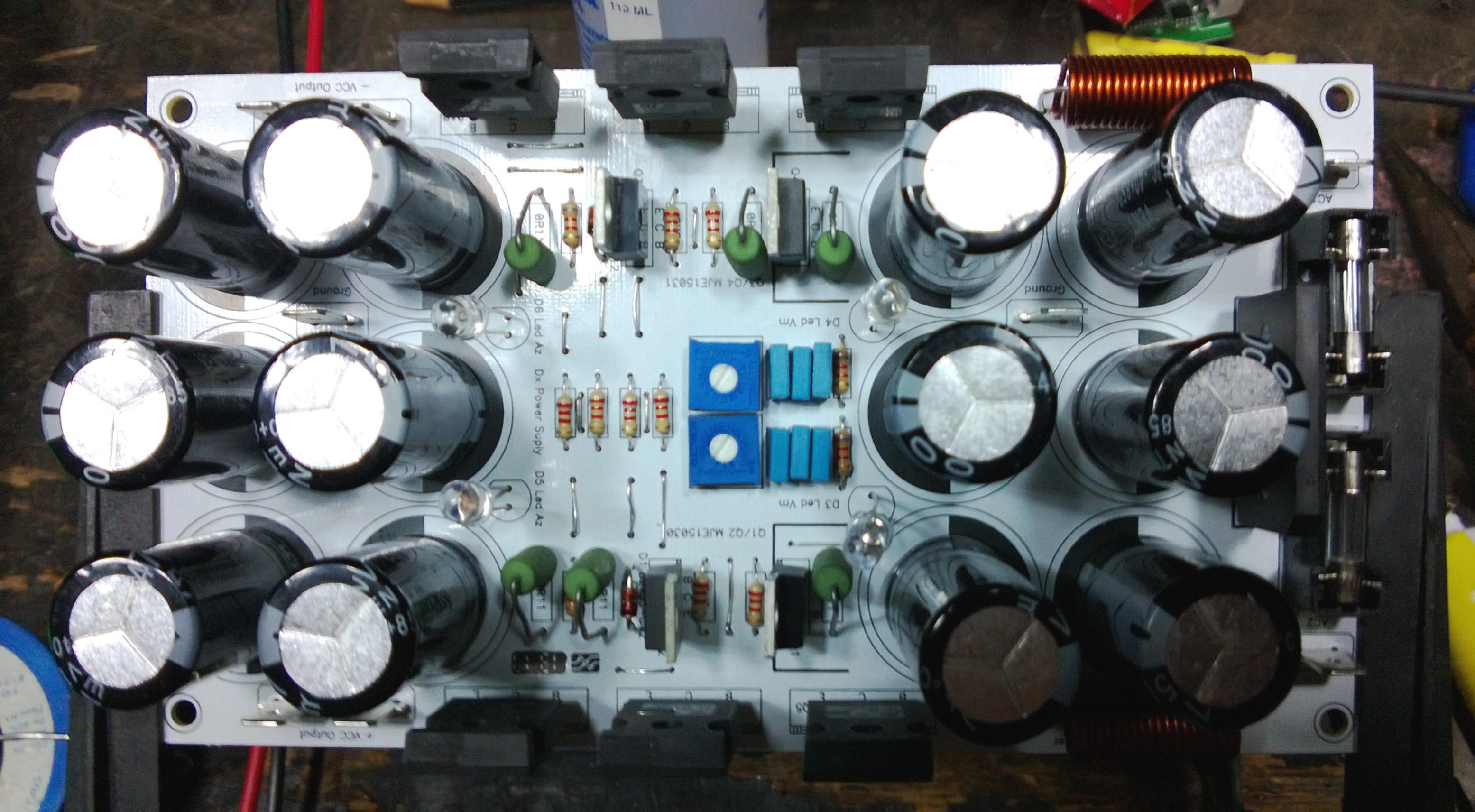

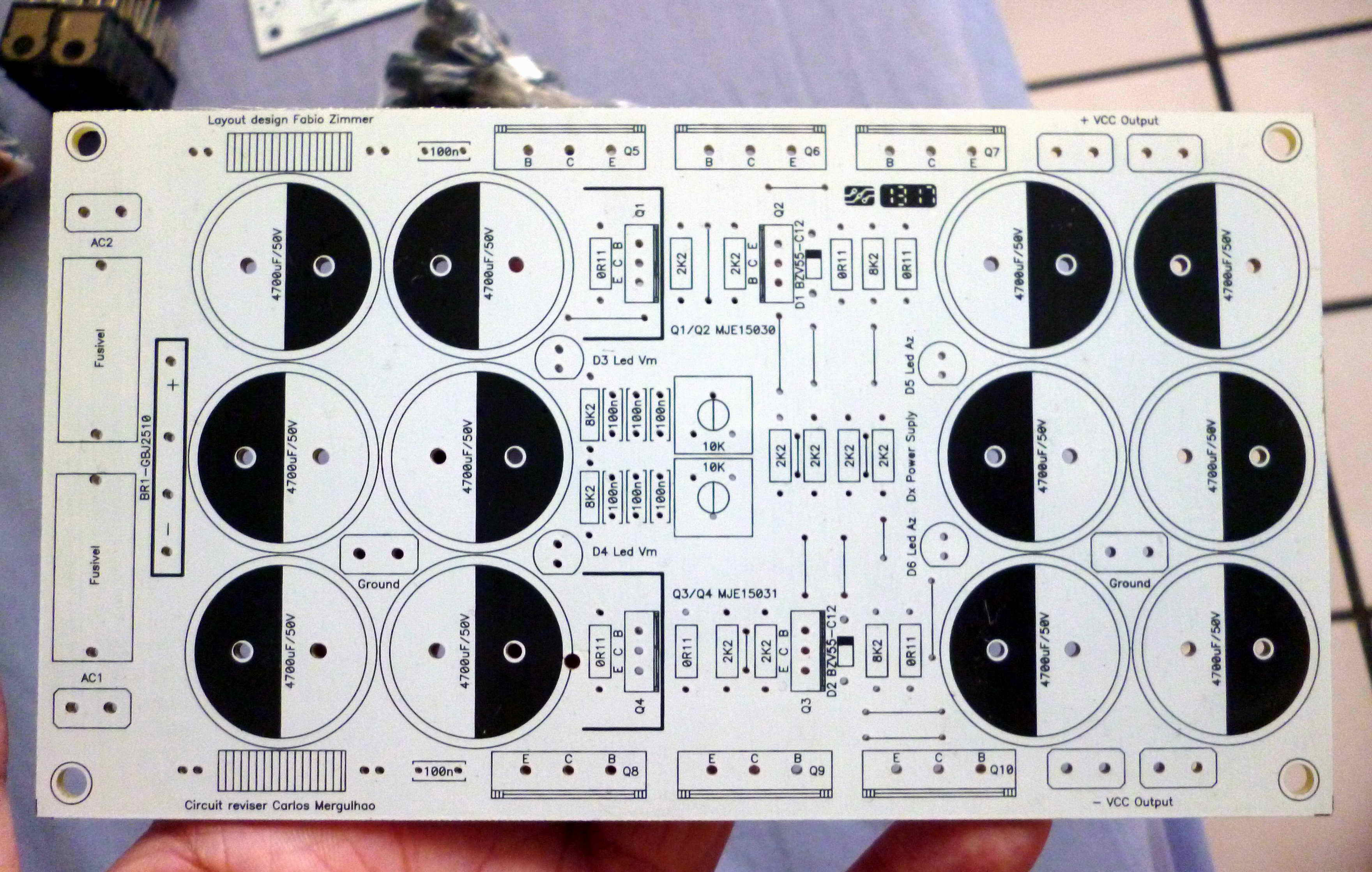

Some folks started to assemble the Dx Supply
It is really Ampex supply...minor modifications i have made...it is still Ampex supply, but so traditional and standard that we can call it a darlington series pass regulator with error amplifier.
Dx Supply because i have tested along 40 or more years, because i have prepared the pcboard, because i have shared, because i have made efforts to distribute and because i help people to assemble and debug....this way it is really a Dx effort, for free, a real diy product, a rarity as people pretend they are diyers...and hate me because i am a REAL diyer.
regards,
Carlos

I found myself reinvented the wheel again. This circuit is VERY good, I simulated one very similar to this one, I used TIP122 as output transistor because I do not need more than 5A output current. From 10Hz to 1MHz the output impedance is less that 50mOhm. Very impressive, better than any IC regulator I saw from their data sheet at 20KHz and above.
A few things different for my design, input capacitor could be larger, so input have less ripple. Not because the regultor can not handle, but the less ripple, less dropout voltage is needed. So you can use more voltage at the output. 1V ripple for every 1A current with 10000uF capacitor at input.
one capacitor(330uF) accross zenner diode you will have better Rejection, but more response time if input voltage is lower than output voltage for some reason(loss of regulation).
capacitor connected to 2.2k resistor need not to be larger than 330uF, 0.2Hz corner against 120Hz ripple. larger is certainly better, but I would use it on input rail.
Output capacitance can be large as needed, but not need to be large due to exceptional low output impedance, I would use it on input capacitor if input capacitor is less than 20000uF. I did not see big difference output capacitance changed from 10000uF to 100uF. Unless your wire have larger resistance, you still want to use one big capacitor close to your load. Or wire a sensing wire(the wire connected to output 2.2k resistor) seperately to your load to be more efficient.
