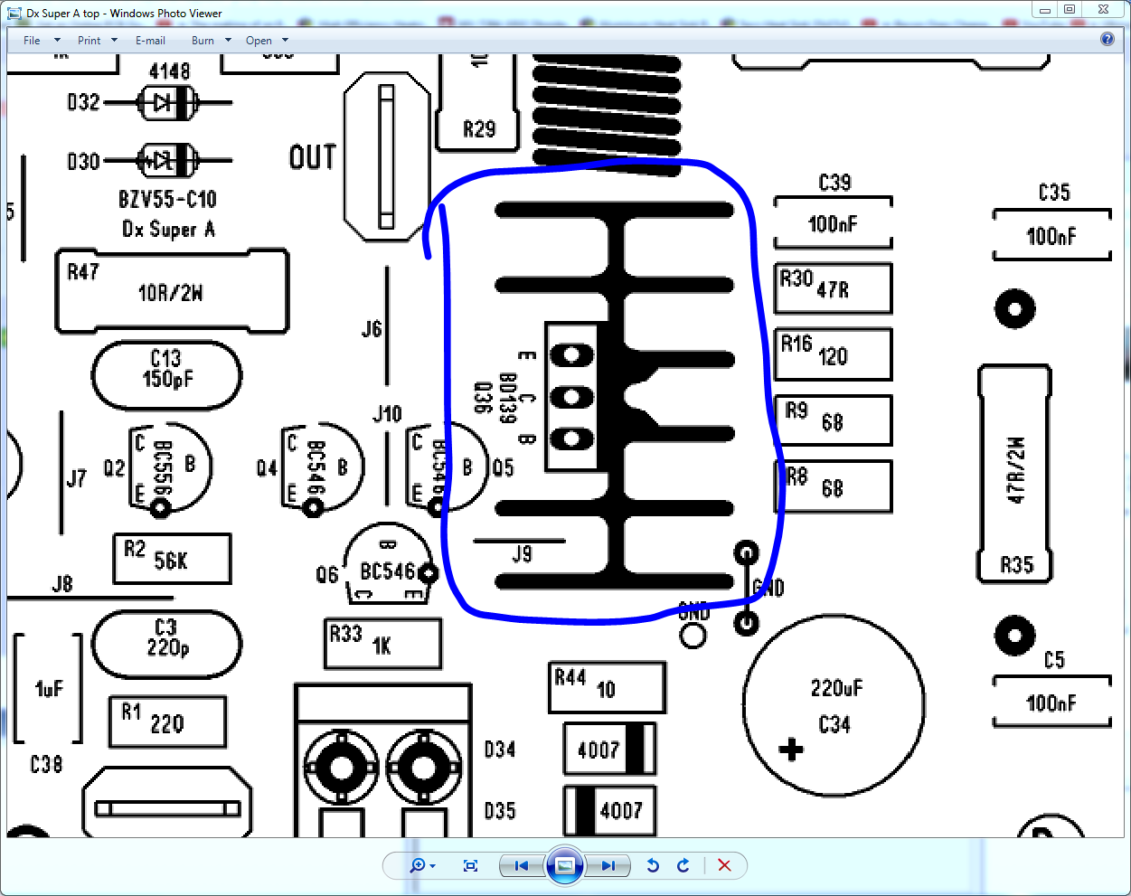

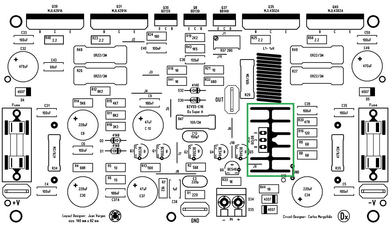

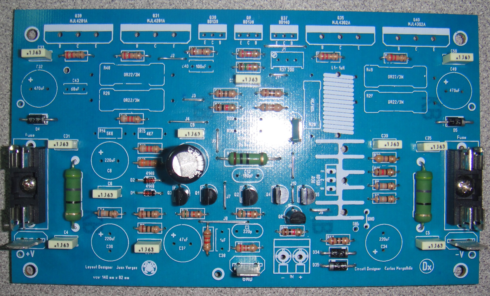

Show me the position Terry.
But, no transistors should be wired..they must go into the pcboard the way they are in the original schematic....VAS transistor is critical, the one that has a heatsink...others, drivers and heat sensor also must stay in their correct position.
Wire should be avoided anyway..they behave alike inductors, or coils, also they produce capacitances with reference to other leads or metalic parts surrounding....dangerous to have wires...they must be as short as possible and twisted in a close way to produce small capacitances in between transistor electrodes.
The VAS (Voltage Amplifier Stage) took from us many ours studying it, to avoid pick up of interferences, or to avoid IT to generate interferences... magnetic interferences...it is the one has a heatsink on board...this one is critical...very important device...the most important stage in an audio amplifier...all audio is generated there to excite the output...the gain of voltage is there.

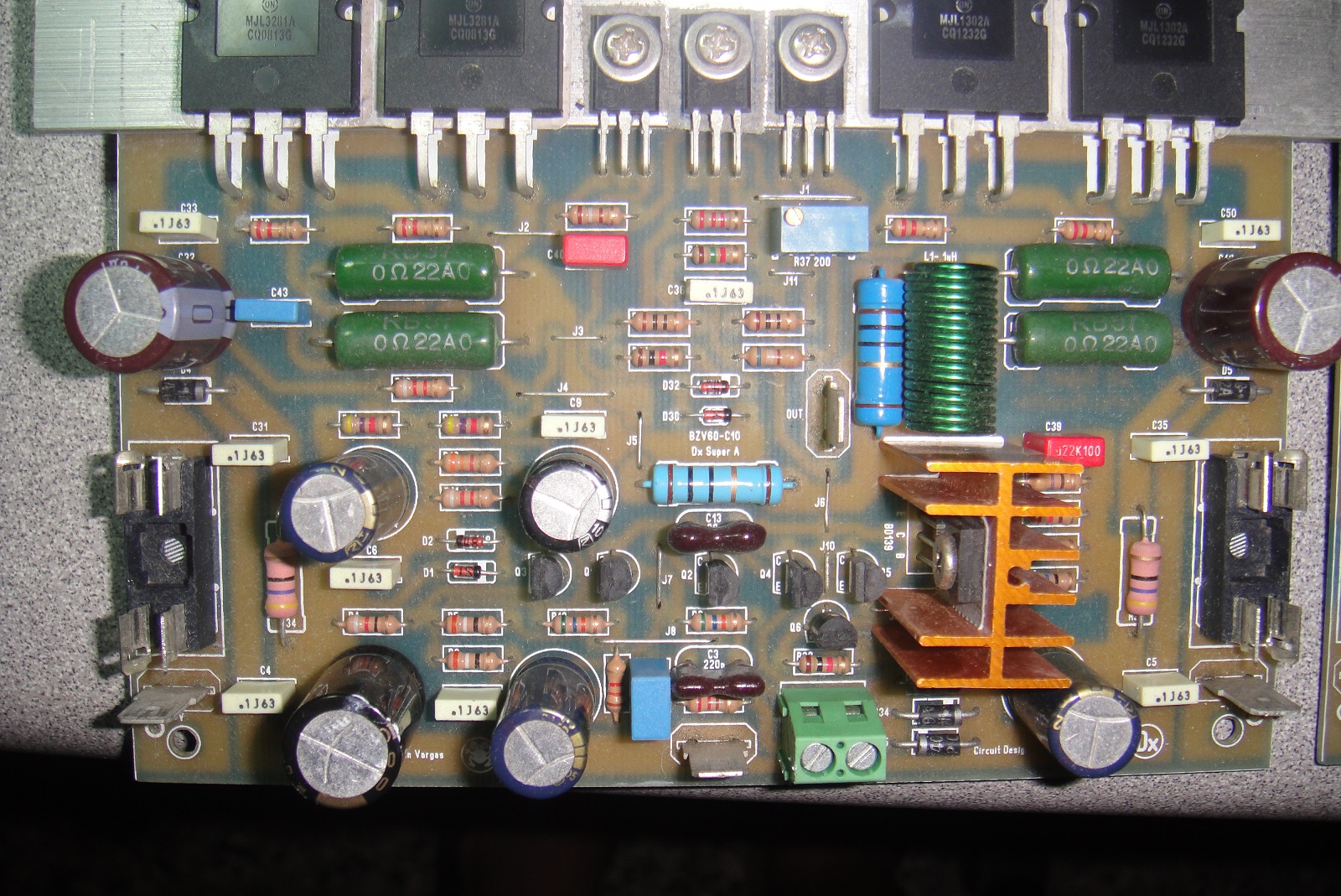

Hi Carlos,
Nice chair. Yes, if they allow export of your national treasures, you will soon not have any. Before long you will have to buy from China like the rest of us. 😉
You had me pegged, I was asking about the VAS transistor. Tight to get a decent sized heatsink there. I have ordered some that Juan showed me, but coming from China it may be a while before I see them. Just checking my options.
Do you think headsinks like I used in my X-BosoZ would be sufficient for the power supply? You can see them here.
They have a 7mm x 35mm x 120mm plate with ten, 50mm x 35mm 3mm fins each.
Thanks, Terry

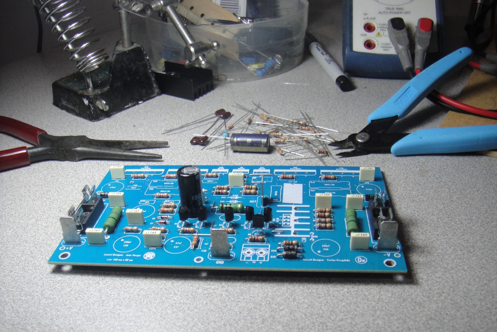

Hello guys I was putting together my boards is taking shape I will orders caps and a resistor and I need R14 and R15 I'm tired I will continue tomorrow my eyes are burning
lol good day guys 🙂
Regards
Juan

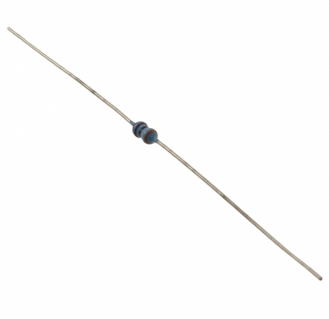

those are Stackpole Electronics brand 1/2W mini 5%
I should get metal film but this is what I have one hand, I measure each one to the closes value, I always try to get the must closer number example: 1K can be 989 ohms or 997 in reality only military resistor can be accurate , but you are correct maybe one day I will use metal films like this one 🙂 by the way here is and amplifier a build a couple of months ago sorry is a litte dusty I'm using the same resistors 1/2W mini
Regards
Juan
