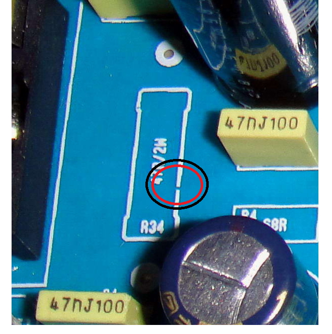

I told you Ranchu...small failures..interrupted lines only
These pcboards that have failure will not be sold...will not be shipped...will be used by Juan and by me.
regards,
Carlos

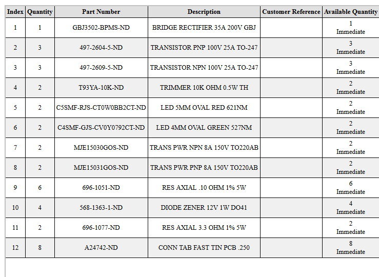

Has anyone put together a Digikey or Mouser BOM for this amp? I am trying to figure one out from the schmetic but without the boards in my hand, it is tough to know the lead spacing for capacitors as well as the voltages needed. I was hoping to get most of the components gathered by the time I received the boards.
Thanks, Terry
I do mister Terry must of the electrolytic caps are 5mm pith distance, the mica caps are 5.90mm pitch distance use 63V rated for the electrolytic caps
the 100nF caps are 5 mm pitch distance all of them, the trim pot lead are 2.5mm
I have this part list from where I order for my Dx Regulator I hope this helps while I'm making the new BOB using Digi Key reference sorry I was busy ;)
I will do the same for the Dx Super A too
Digi Key

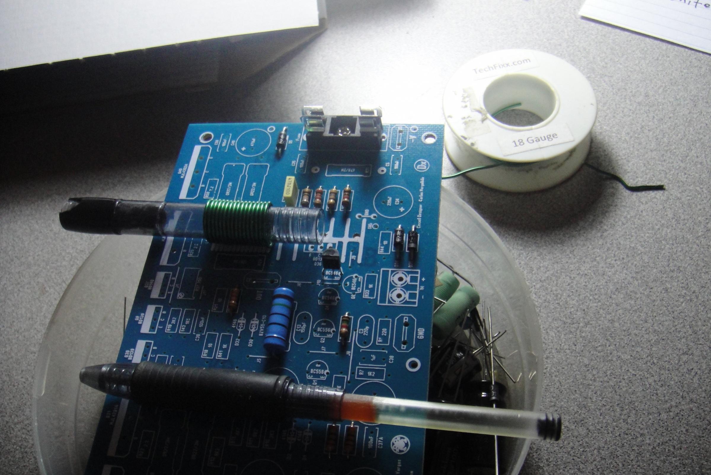

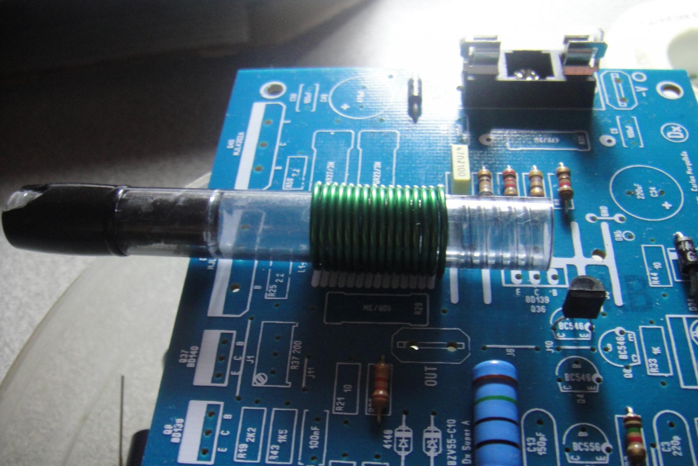

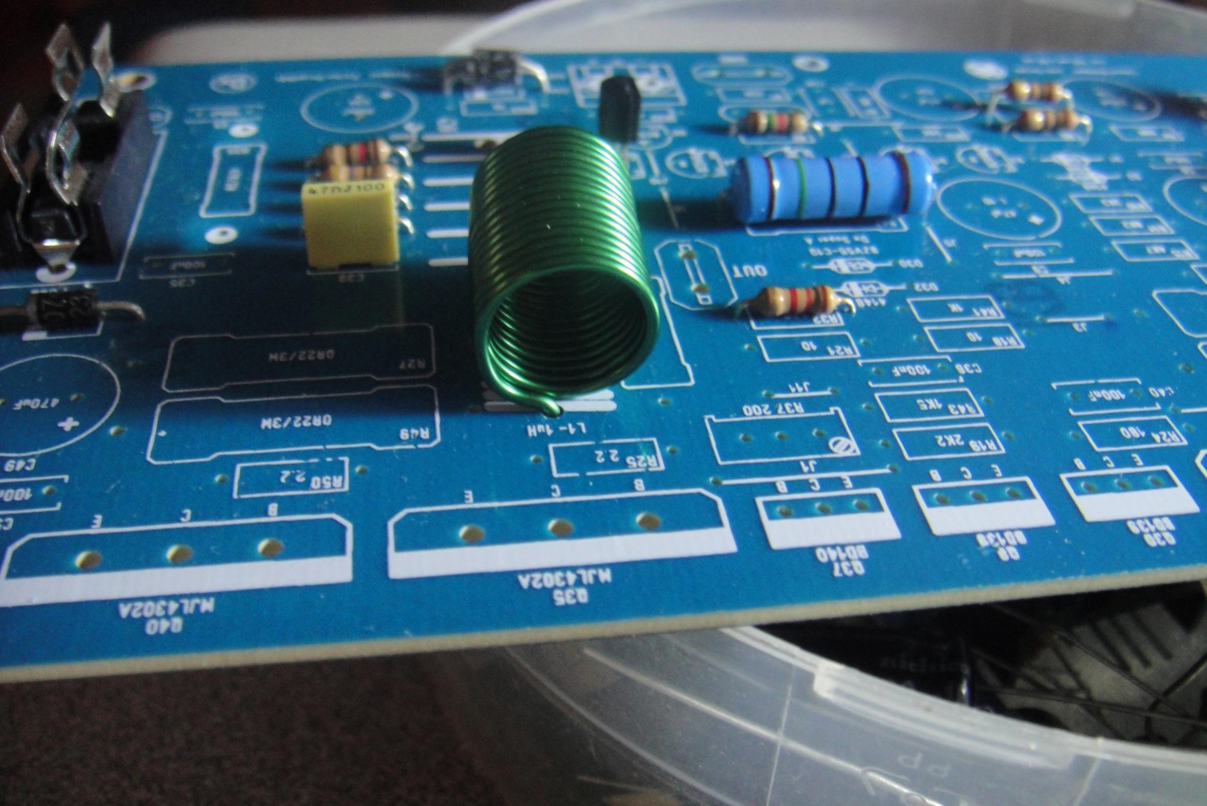

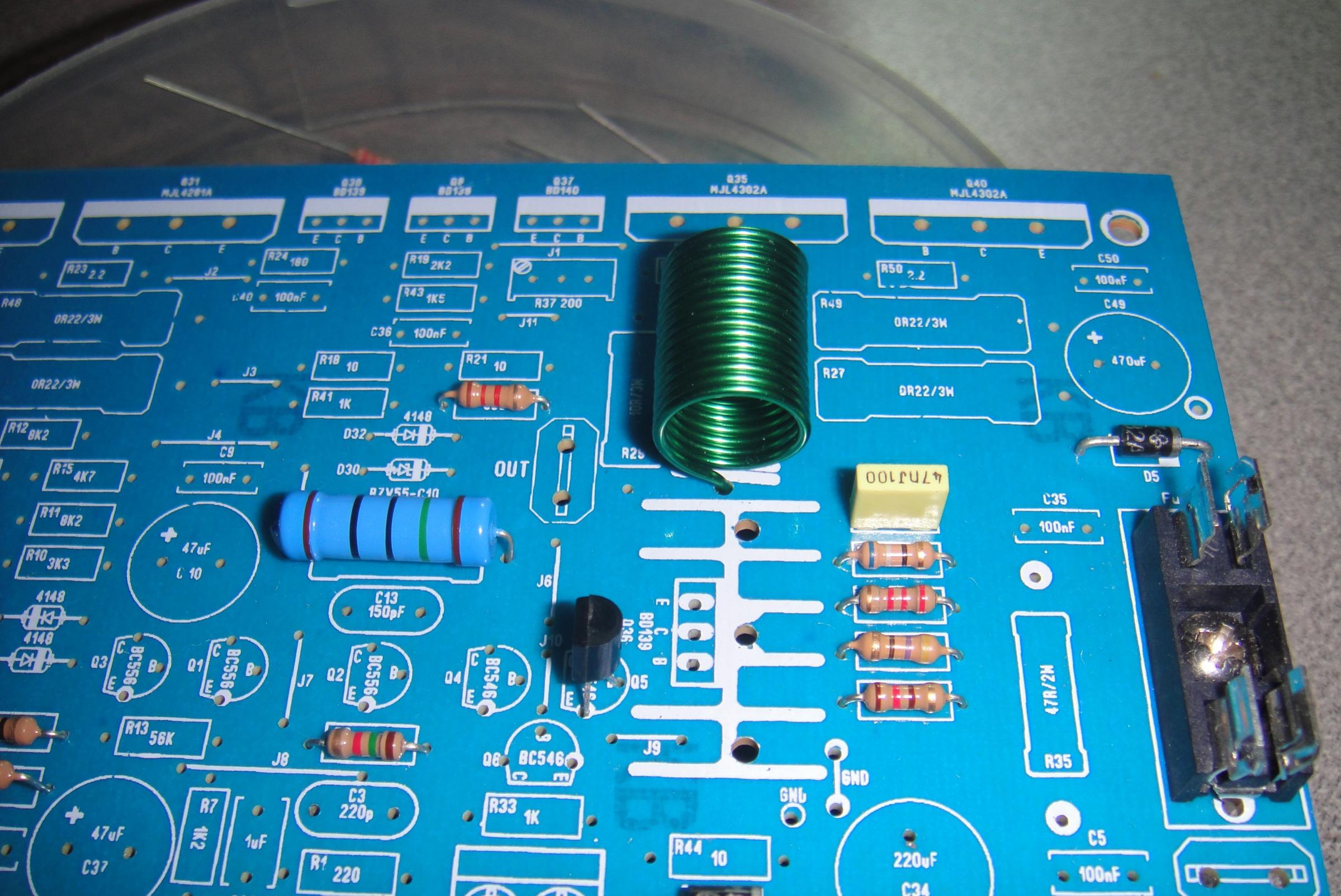

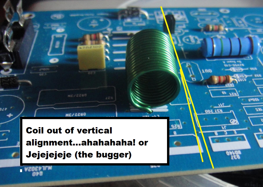

I was making the coils today so I just want it to show you guys how my coils look like, I use a broken pen that is about 9 mm in diameter and I did about 16 turns of 18 gauge enameled copper wire.
for those guys who notice the resistors I always bend the leads and shape them after that then I install them to it correct location I always do that jejejejeje :D
Regards
Juan
