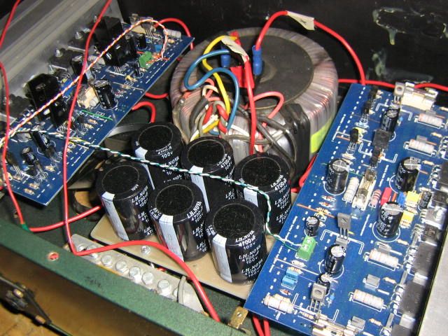

next ......amp ....for Twaksak
Hi, Twaksak ,
Realy nice art work Twaksak , bee happy like Carlos ....
now, u can try to build the next amplifier
regards alex mm .
Hi, Twaksak ,
, another nice sounding amplifier from Dx Corporation 🙂 more powerful .....😀 regards alex mm .

Picture...i am building the Krill once again...nice amplifier..very nice!
regards,
Carlos

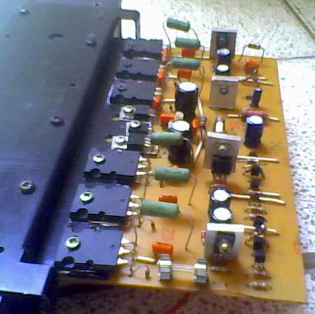

One more local friend has built the Precision 1
I will post in portuguese and will translate:
"Carlos, Seu amplificador precision esta funcionando aqui na oficina, que amplificador do c a c e t e! Meus ouvidos vão ter um orgasmo porra! Que qualidade, grave lindo teu amplificador é bom todo! A placa esta correta não tem erros tudo certinho, quem montar e não funcionar é porque errou. Depois tiro umas fotos dele pra vc ver. Um abraço."
Carlos, your Precision amplifier is operating in my workshop (repairs of audio equipment)... what an amazing amplifier!...my ears will have a sonic orgasm!.. what a quality!... the bass is wonderfull.... the sound is entirelly beautifull... the pcboard has no errors and everything has worked first time try... if someone found problems was his own mistake..no errors.... latter i will produce some pictures and will send you... a friendly hug to you.
The guy's name is Sergio Vaz (portuguese descendent), he lives in the State of Pernambuco (northeast of Brasil) and the place is called Janga
