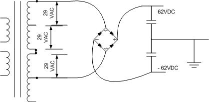

My term "floating ground" was probably not the correct term to use. Perhaps I should have called it "floating secondary", because the power supply itself is grounded.
This is shown in the jpeg attachment. Would you kindly look and give you assessment now that the picture is more complete?

Hi F,
that does not work.
You must tie the power supply zero volts back to the centre tap of the transformer secondary. But you don't have a centre tap!!!
that does not work.
Exactly this one you are showing me
Please, do not use it dear François, or do not use it with my baby beautifull amplifier, please!
I know some brands use this way..... but do that with those brands please, and let my baby working into a more safe way.
Or do it under your risk.

Re: Exactly this one you are showing me
Carlos, thanks; also to Andrew.
The verdict is in -- I will not use it this way with Carlos' baby.
Francois

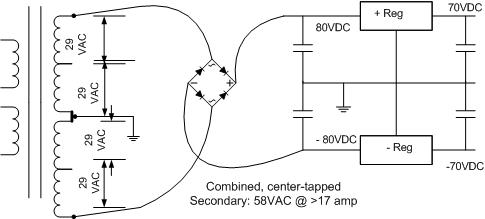

Regulated supply?
Would the baby compromise for a regulated supply like in the attached?
I have tested my transformer -- after rectification it can deliver +80 0 -80VDC (loaded) @ ~ 8 amps. (Max is 17 amps but I have not tested VAC at that current)
Then regulate that for a 70 0 -70VD supply, like Nordic. Also re-read comments/changes about a Precision on a +/-70 V supply.
Would Precision be happy with this arrangement?

hi Francois G,
The "basic" circuit looks right to me, but what regulators are you going to use?
Have you thought about the power dissapation of the regulators, (Vdc - Vreg) x current ?

Thanks Greg. Currently I don't have a regulator design, but a suitable design should be easy to find. (The AudioXpress magizine's had a PC board for regulators used with Adcom 555 amps (200W/200W) which should work here.) Do you have a regulator design to recommend?
The regulator heat dissipation is something I will account for in my heatsinks (big!). The regulator pass resistor(s) will be mounted on the same heatsink as the Precision PC. I will probably add a fan to help at high power.

Here is one supply, Dx Regulator this one
It is an Ampex alike design made in the seventies, also used by Sony Corporation for long time.... that topologie, other values and some overcurrent protections and some crown bars used too...huge supplies worked in large videotape machines those years.
I have used them to Radio Amateur transceivers, entering 24 VDC and adjusting to 13.8 and 30 amperes into 5 percent voltage error (voltage loss, voltage drop).... only 390 watts supply..but i have build to test the Precision..... i have not appreciated the sound and i give up.
A good idea to read a little bit more my dear friend...all this was published, the supply, the test, the comments and everything was already discussed and posted.
The circuit is reliable, and works fine, stabilization needs some tuning but goes from 3 to 10 percent, depending the transistors used and the voltage adjusted compared to the input voltage.
If you enter with 80 volts simetrical, you can adjust to 64 in the place the seventy volts used by Nordic...he did that because he had not the regulator and had the supplyes to use...he joined two Dx Standard amplifier supplies together that resulted that voltage.
The Precision was designed to 64 volts, and God bless the one that will have the courage to open full volume of this little monster amplifier...very strong man...can make powerholic very satisfied with the power using the standard 64 volts.
You can adjust 64 volts, and three transistors up and 3 transistors down will make the job to you...the series power ones
can use 2SC5200 and 2SA1943 or others powerfull units you have...because 400 watts will circulate, and it is safe to install 3 units to each rail as series pass transistors...drivers can be 2SC4793 and complementary, 2SA1837... also for error amplifier the same transistors can be used...heatsinks into the drivers, better to go together the output heatsink.
Because of this reduction of voltage...from 80 volts unstable to 64 volts stable you will have 16 volts and a lot of amperes entering the series pass rail transistors.... 3 units in parallel each rail.. and emitter equalizing resistors are not a bad idea to them.
This will need enormous heatsink to hold the power... that will be the current multiplied by the voltage drop over the series transistors... and two channels into sucking energy from the same supply, under 4 ohms loads.
The salvation is because the supply will go down...under load the voltage will go 69 volts for sure...and this means you will have only 5 volts multiplied by the current, to each rail current, when two channels will be driven full power simultaneously and this will reduce the heat...you may be able, even to reduce your output units quantity if you want....but not a very good idea.
The idea is to use your transformer...but something expensive, enormous cost, another enormous heatsink, a lot of transistors more and i have found the audio quality, using electronic supplies not very good..... i found the passive supplies better in sonics.
Well.... your decision, it is up to you...i think, if you wanna know, that the use of your supply will create much more problems than solutions to your life.. it is not a good idea.
But, if you want....be happy...pleasure in life is very important...better than money, and sometimes some stupid things make us very happy...why not to try.
Be happy, but please, let my baby survive, be beloved amplifier..use 64 volts and please, forget that idea to use regulators..

Re: Here is one supply, Dx Regulator this one
Carlos,
Many thanks for the "DX regulator" schematic - It will be used some day. But for the Precision you have persuade me - no more regulators!
Now I need a new transformer for 46-0-46 V - have any of you North American builders found a good source of 46VAC CT transformers?
