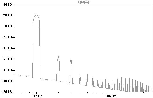

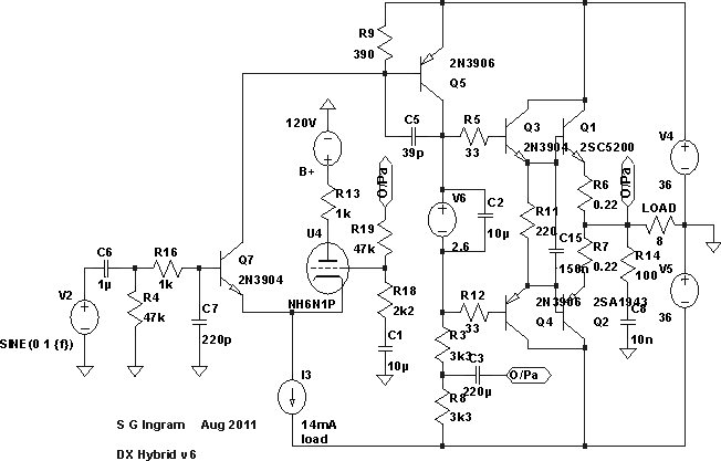

As requested - distortion profile from simulator. I likes it 🙂

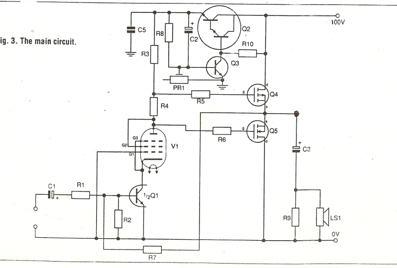

It seems a pity to let this thread fade away - are there any veterans of Carlos' amplifiers that would like to take up the challenge of doing a hybrid worthy of DX approval ?

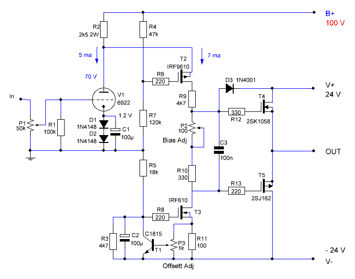

Is there any progress? I have a proposal, how about this simple little circuit? I believe it still retains more than 70% DX original concept and use a low 100V for B+.
Very clever.🙂

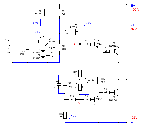

hi indra1
had you tested or build such amp...
I am very much interested with hybrids...

Junm, Indra1 - you guys need to take charge of this thread and build it 😀
T4 might be replaced by a BJT (higher transconductance and not static sensitive)
Put a capacitor across R22, the quality of the voltage at the gate/base of T4 is very important, it needs to be as clean as possible as any noise here will be heard.

. . . had you tested or build such amp...
Not as posted, I'm building a 6922 hybrid with latfet output. The circuit on post #52 is meant to preserve authentic DX output stage but needs tweaks for output offset adjustment and probably a DC servo. I actually hope that expert folks at TGM lab will proceed with the DX authorized hybrid development. It is very difficult to find a good FET for input nowadays. I think triodes are still plentiful enough as an alternative for a continuing development of good sounding amplifier.
. . . T4 might be replaced by a BJT (higher transconductance and not static sensitive)
Yes, as you already know, Rod Coleman successfully used 2N5401 and MPSA92 in the "Shunt Cascode Power Valve Driver" and the "does the 3A5 have the stones to drive a 2A3?" thread. But base current related distortion will tend to dominate total distortion as discussed in "My folded-cascode VAS linearity investigation" thread. One solution is to use high gain transistor, but another is to use FETs.
. . . Put a capacitor across R22, the quality of the voltage at the gate/base of T4 is very important, it needs to be as clean as possible as any noise here will be heard.
Yes, the quality of the psu is very important, a very clean HV supply is a definite must. However, if power is not clean enough, a cap across R22 will exacerbate hum problem because input of T4 is referenced to V+.
The attached circuit is what i am playing with, in no way finalized. I am still tweaking the PSU. Any comments, suggestions, and other alternatives are welcome. However, since the circuit is in no way resembles a DX Amp, this is OT. I hope Carlos does not take this as an offense.
