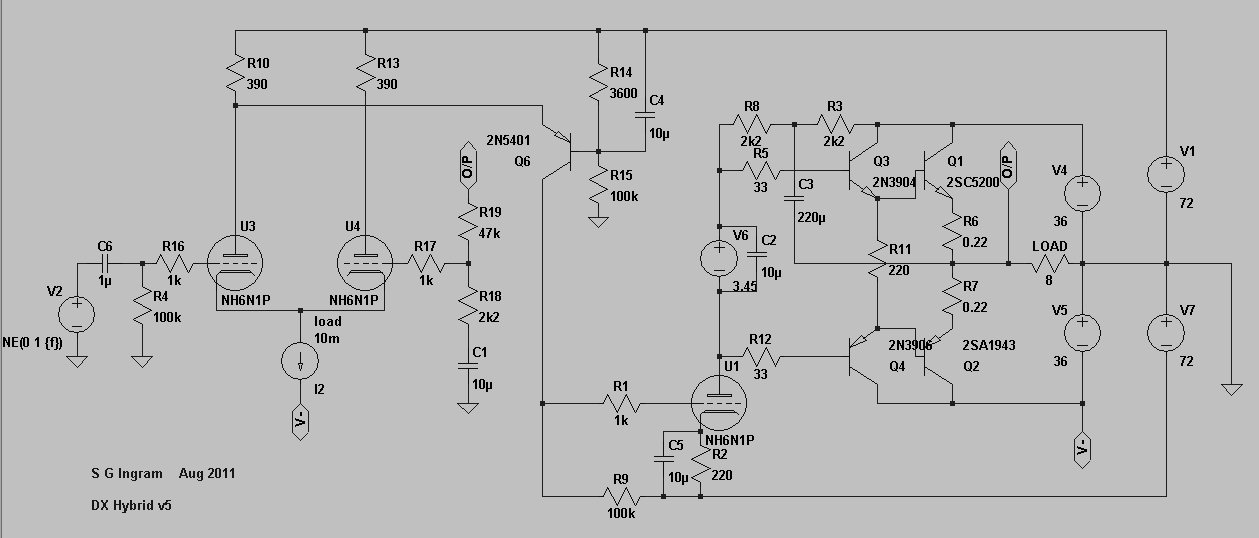

I do have a hybrid in mind for the TGM labs, but it is a different topology and progress will be some months away. I don't think DX will mind at all to see progress with your schematic !
The dc offset will drift as the tube warms / ages so a servo might well be the better approach.
Perhaps in your schematic you can place caps across R4 and R7. The idea being to adjust their ratio so that you can null out the B+ noise across the gate-source of the FET ?
Yes, I remember my 3A5 thread. Rod's idea is an old one, from a chap called Taylor, although it was used to make a Follower. But I also remember that it turns the load-line for the triode vertical and this is not how triodes are usually operated so I am quite curious about the 'sound'.

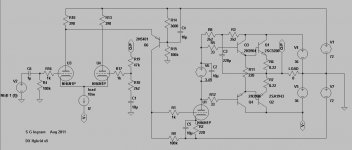

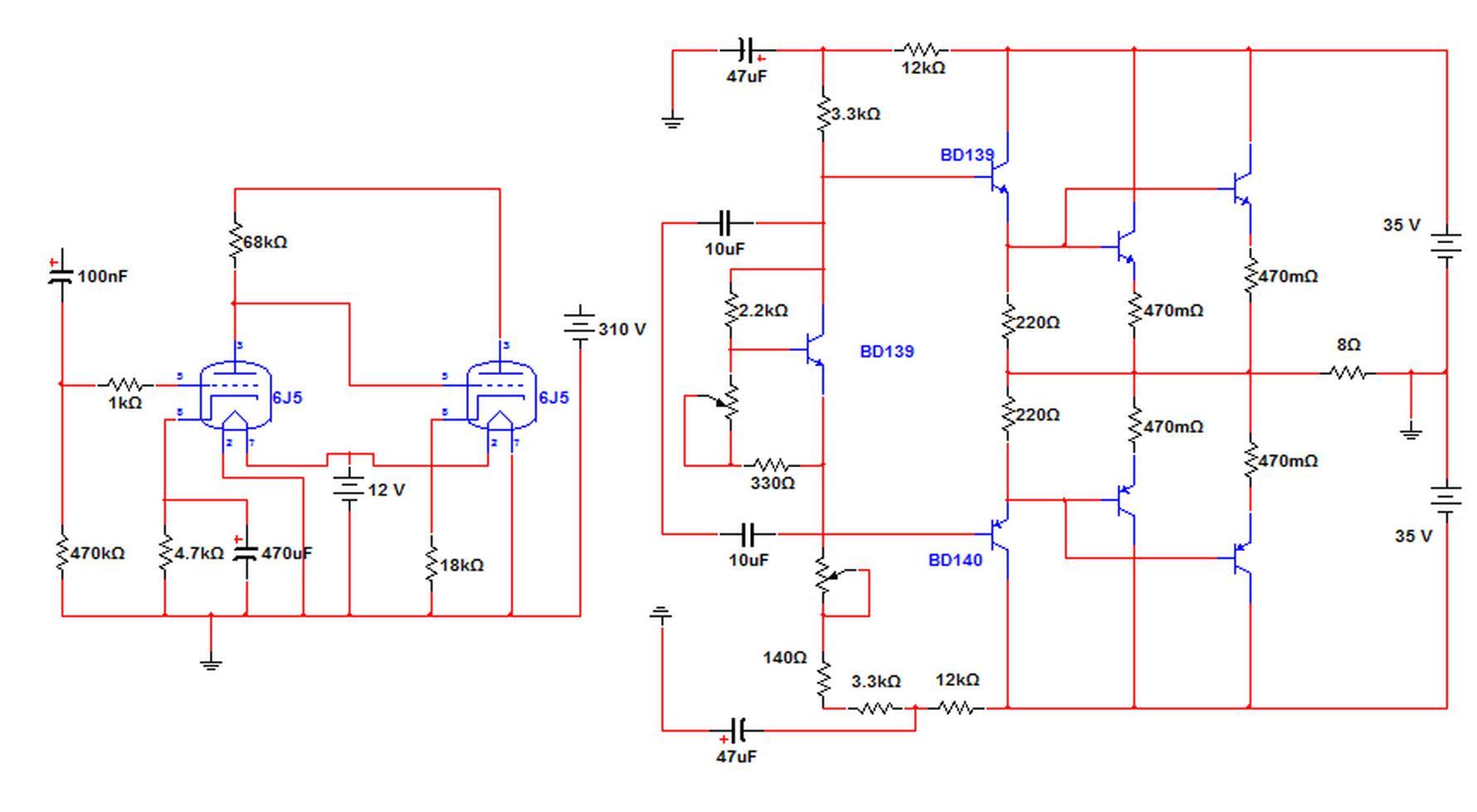

Well, I am now understanding that a DX Corp. amplifier is expected to meet some stiff requirements:
low measured distortion, no triple outputs but only double EF (tubes like to drive light loads which favours triple outputs), good PSRR of course, good stability and gain matching between channels, high damping factor for bass response and no pesky dc-offset issues.
All this favours use of global negative feedback and dc-coupling throughout. In short, the familiar DX topology. It doesn't appear suited to a hybrid.
Carlos suggested why put tubes into DX topology, use for LTP and VAS. Well this ain't easy since tubes come in only one flavour, n-type.
I thought I would post an idea of how to do this.
I use tubes for LTP and VAS. connect the output of the LTP to the VAS using a technique invented by a man called Taylor, it's known for use in the Taylor Follower. It requires a pnp device.

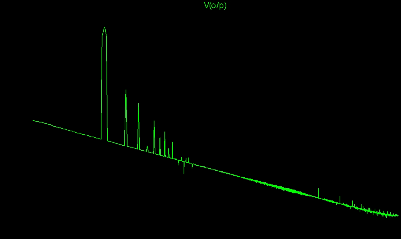

I'll attach what I came up with. First the schematic, then the Spice file (change .txt to .asc before running it).
Hi Bigun
what is the way of controlling the offset, R9?
tube as input device and vas too = no memory distortion😉
