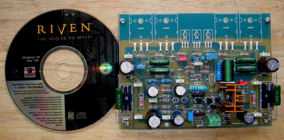

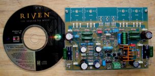

I don't know if a different pcb needed for this low voltage modified Super A.
What you say Carlos?
Hi Thimios,
Pcb size is smaller,more compact (only one output pair and no Super A circuit) so enclosure can be more streamlined . Other than that,you are right,probably can use old board and modify.

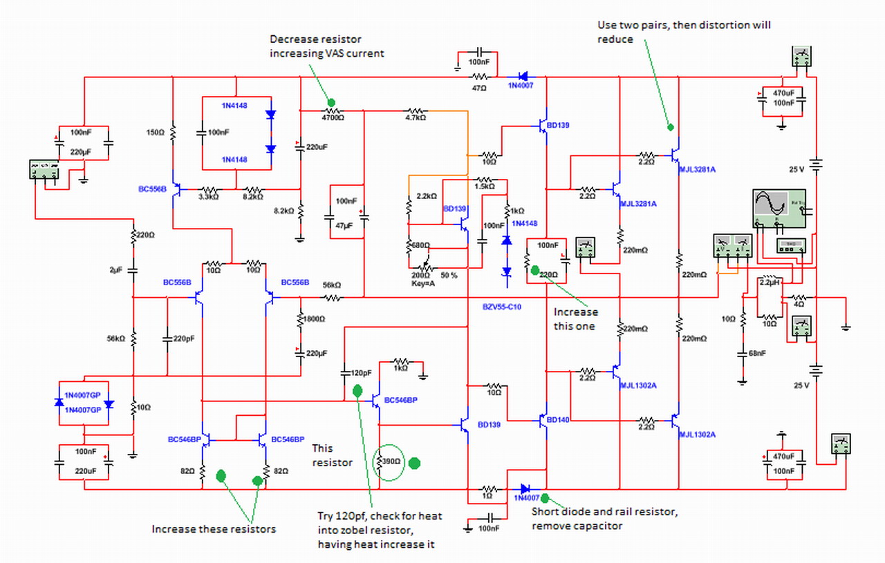

I was tweaking and i have found we need two pairs to reduce distortion
I could not reduce below 0.002% without the second pair.
So, a good idea is not to reduce pcboard size to let room to the second transistor pair.
You can perceive the sound, in special in the treble range.... resolution, audio becomes more defined.... if you listen to claps it will not sound alike rain falling in metalic ceiling.... sound of a bell become more clear.
I have not tested...this is just a simulation... real world can be different due to different specifications of components and tollerances of values.
At simulator, all parts are optimized and precise...you do not have NPN gain different than PNP gain.

Will the simulation result be more or less the same with 20 volt supplies, or need to change component values?
Regards
Regards
Not exactly Junior35, first of all you have to reduce....
The input level when operating with 20 volts (compared to 25 volts) because this modification in power supply voltage makes your amplifier more sensitive and will need less input voltage to reach the threshold of clipping.... of course you can understand in the opposite way..it clips sooner, while you advance the volume control, you will need less signal to drive the unit into the clipping.... in this case we cannot call exactly as sensitivity...or we can.... it is more sensitive to destroy the sound clipping...less signal clips...so, it is a little bit philosophic stuff related the point of view....alike when the amplifier has not bass...maybe it has too much treble in the place to play less bass...got it?
So, to simulate you have to make adjustments... cannot just decrease voltage or increase, simulate and compare..this does not work fine..you have to optimize variables in each one of these two cases....input level and stand by current must be checked and readjusted if needed...to compare in the same conditions...to simulate under the same preset sittuation.... level into the threshold of clipping and stand by bias (no signal current to each one of the output transistors) must be readjusted.
Also you have to feed 40 mA to each one of the power transistors adjusting bias trimpot.... and to check reducing it and increasing it to each particular model of power transistor you may use to simulate...in some transistors you need 30 mA, in other you need 80 mA.... so...you have to simulate fourier analysis under several current presets.
Even this way, with 20V distortion increased in 0.000004% .... this is nothing, but to answer your question i have to be precise...yes, the distortion increased...no one can perceive, even meters have problem to measure, this means nothing...but to be precise:
Yes, it increases!

Hi Carlos,
In post #1573 you did simulation for 20 volt supplies,but with one pair of outputs. Since that time you have suggested different component values/changes/removals. I'm not an electronic engineer. No oscilloscope,just simple tools. Do you mind to do some simulations for two output pairs with 20 volt supplies? I have Juan's DX Super A boards and BOM. My aim is to convert standard DX Super A to low voltage version. I don't care if distortion number has 4 zero's or 24 zero's. Just perceived sound is important. I understand that I will need to tweak some values for real-life amplifier,but if you can post suggested schema that would be great.

Last diagram posted is good fro 20V and 25V
Let me say something to you dear friend.
Simulation is simulation and nothing more than a simulation...as i use to say, everything while simulating is optimized.. fake optimized results..... something you may not achieve in real life or may achieve... matter of luck.....real life, usually is another stuff....tollerances can change the performance a lot....your particular transistor used...the one you bought, can produce better results than the simulation i have made or can produce worse results...only God can tell you...i cannot.
It is very possible you achieve great results...better than you can achieve with competition...but numbers cannot be guaranteed.
One thing is simulation...other thing is real life.
I do think it is enough from simulations...last schematic provided is the one.

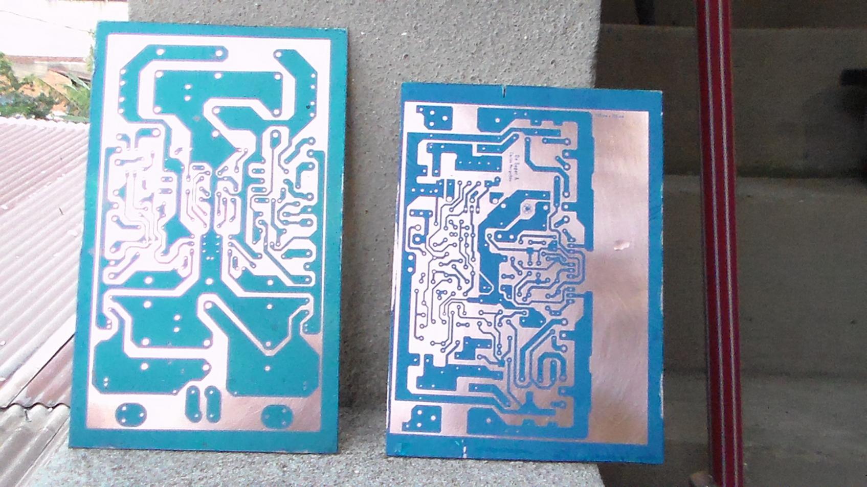

Home etched pcboard.
Sadly i have not the builder's name..... a pity, i am not that organized.
But, considering the cement colour, the type of construction the wiper holder (broomstick) and the ceiling, i can say this was made in South or Central America.
We can see Banana tree too...this is Central or South America, for sure.
