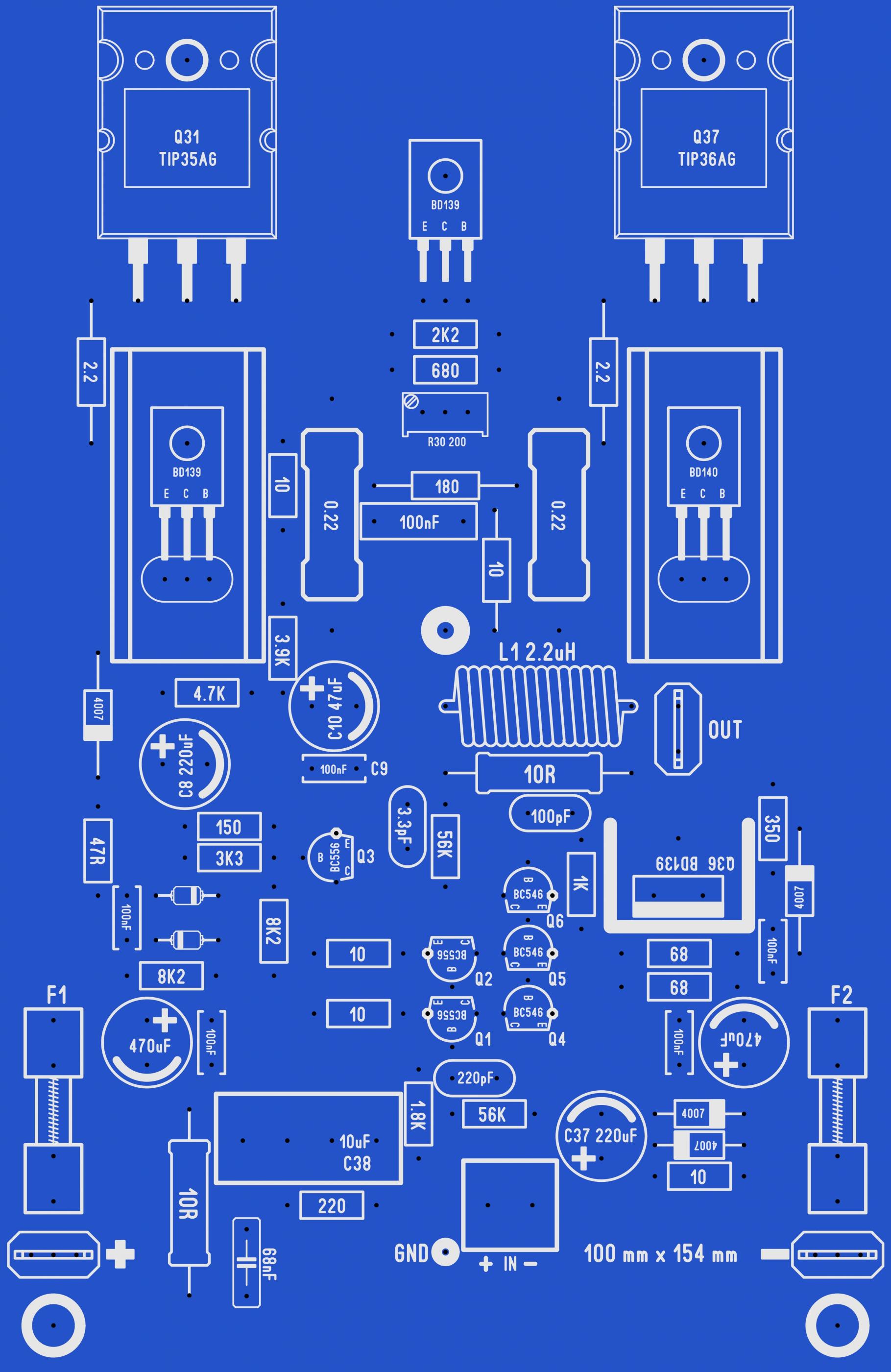

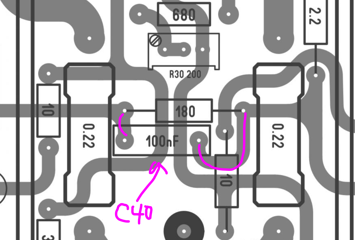

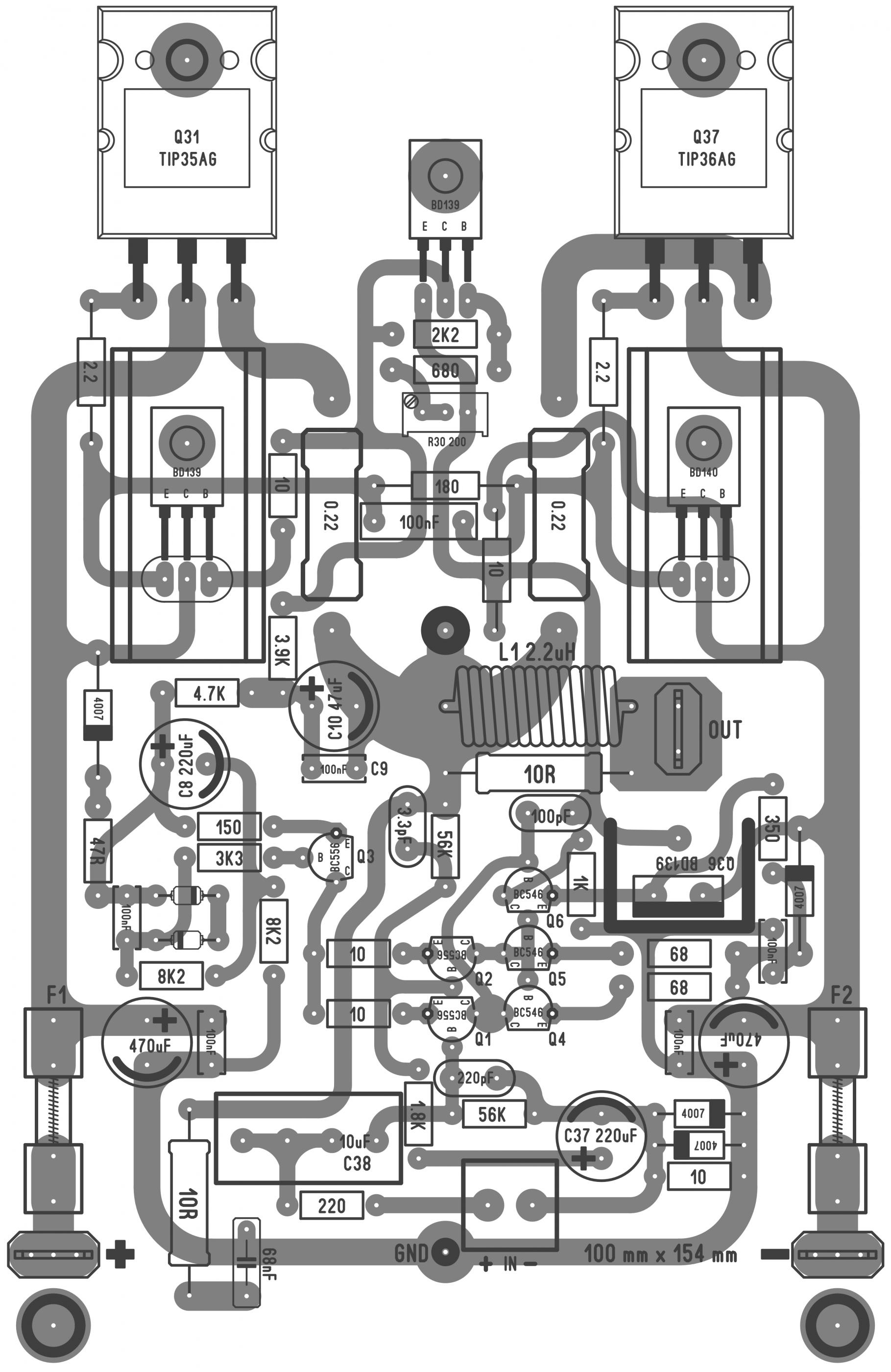

Hi sir here are the file but I have not test it yet I was working on it and I forgot a few components to place there so I just add them R47 10R and C43 68nF this time there are no jumpers on the layout if any error you notice or some one see something please let me know 😱
so I can fix it, no matter how many times we think "that is good to go" there is always something and it happens many times to me 😀

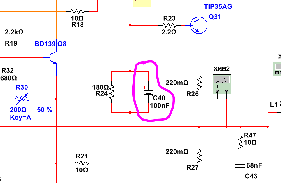

on the layout C30,C4,C5,C34 are not present that is my mistake, I use the simulation and no changes with them or with out them so for now the layout is only "prototype" not final 🙂 for fun please no for been so serious 😛
Regards
Juan
  • Dx Super A components layout.pdf
  • Dx Super A Invincible, 20V-2 up.pdf
  • Dx Super AI etching.pdf

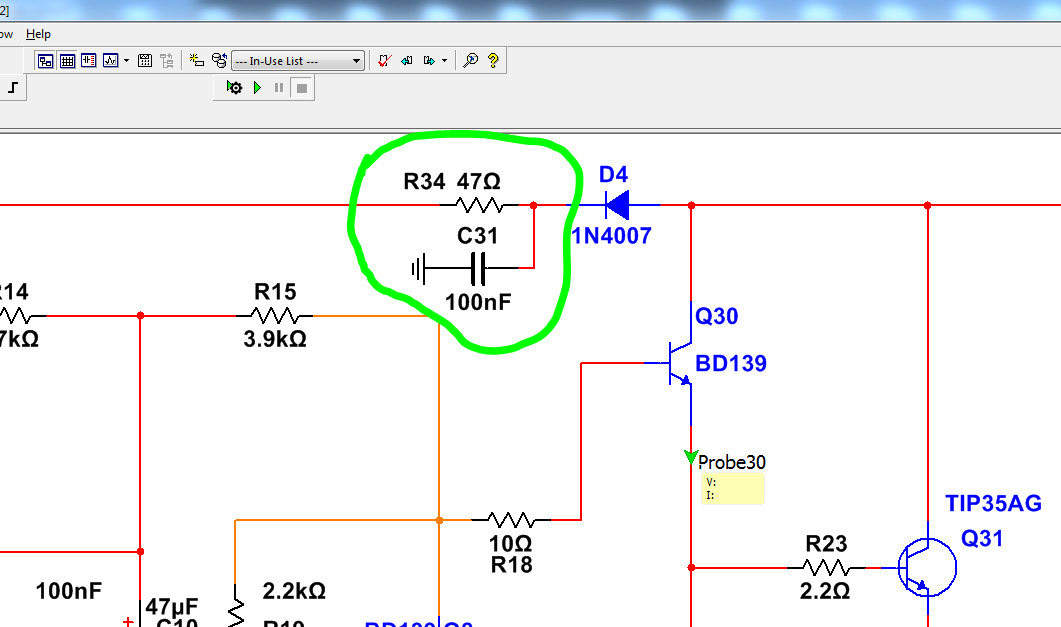

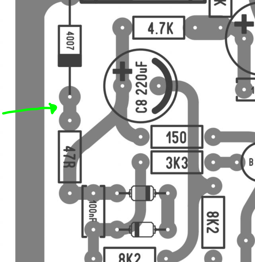

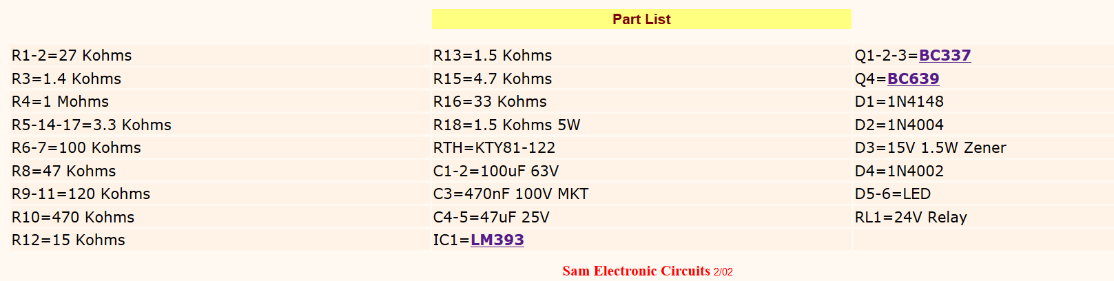

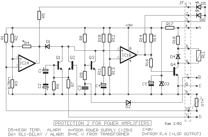

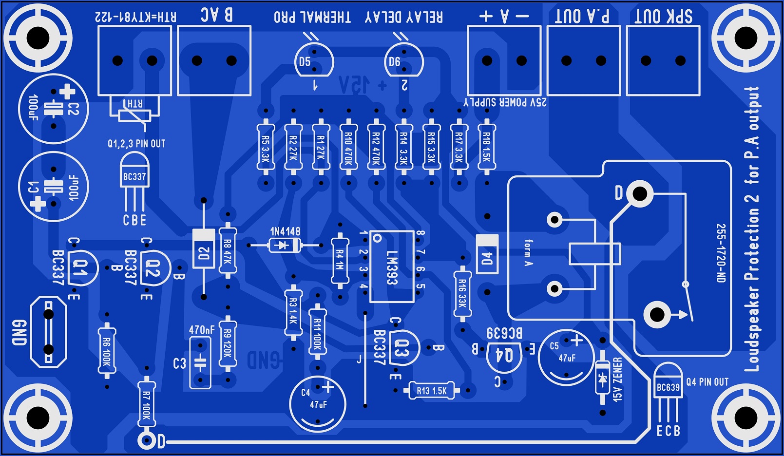

Yes C31 is missing I can fix that 🙂 I'm also working with a new toy this speaker protection circuit I have been checking it for 2 days now 😛
Regards
Juan

about the layout schematic Dx Super AI I did simulate with out those C's and it respond the same way no problem, I guess is how well the layout is place and how well the power supply is filtered, I spend some time reading about magnetism and placement of parts traces length copper thickness here and there and is a lot of information to gather and learn.
Regards
Juan
