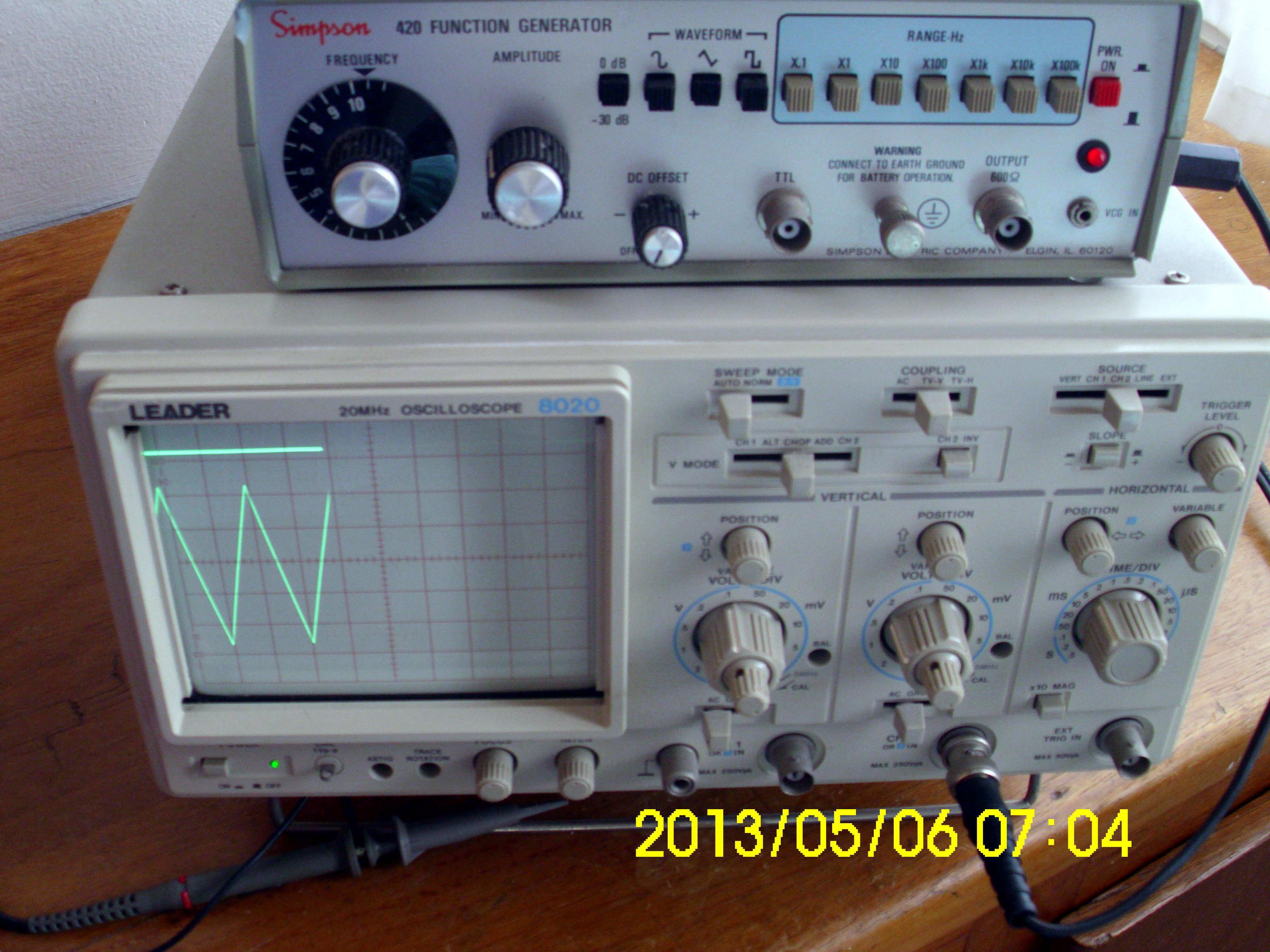

My scope is back, repaired and working perfect,

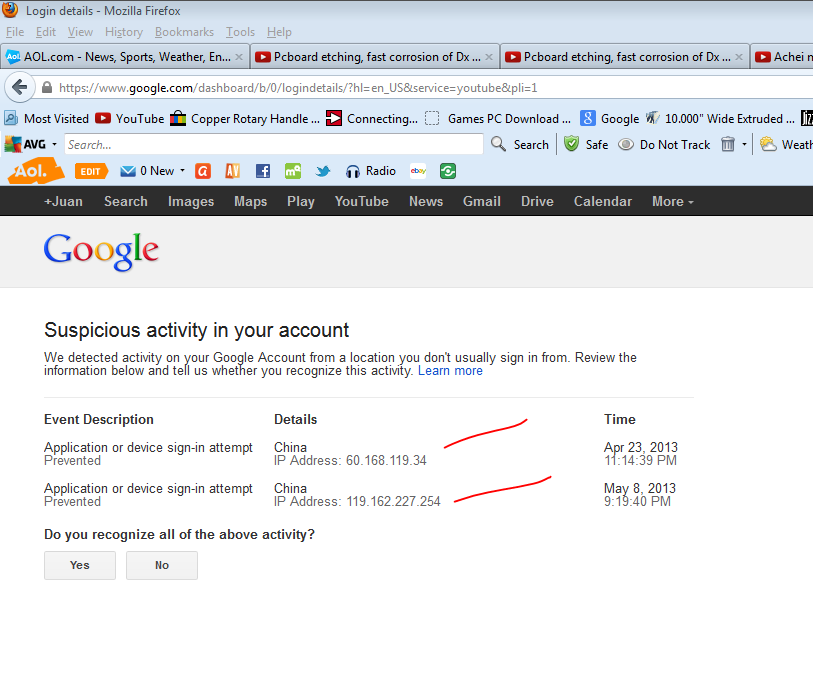

I'm really upset 😡 sorry for the bad words on the video but I'm really **** up right now. that is way I haven't put new videos for that reason
Some one is traying to steal my account from China - YouTube

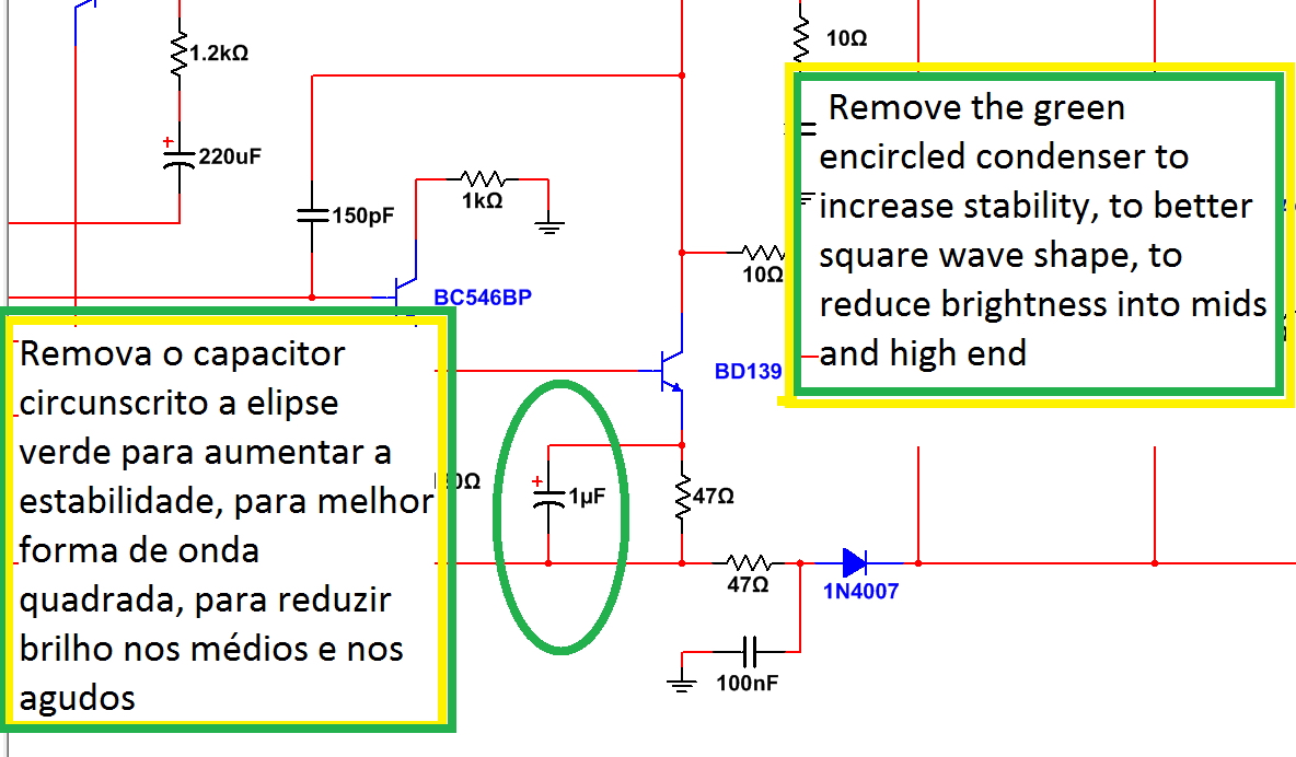

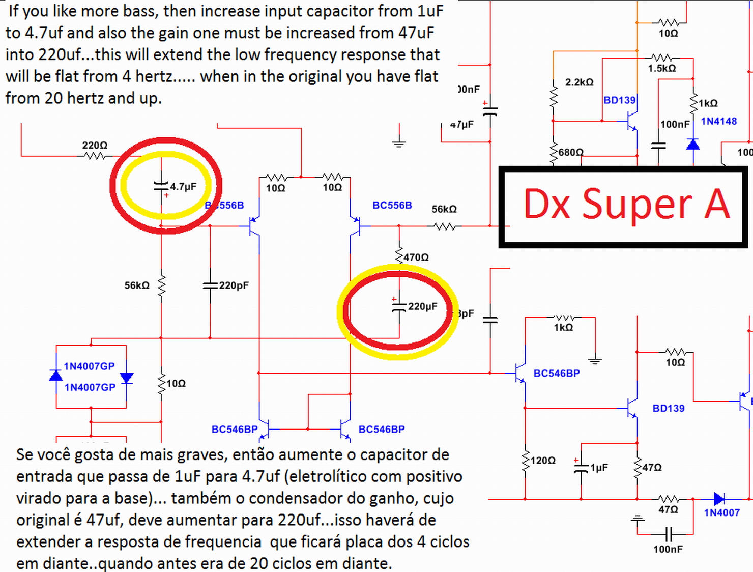

Yes....the capacitor removal is a very good idea
Dx supply installation & remove Dx Super A capacitor - YouTube

Well Carlos to be honest I never installed the 1uF cap I trust the first schematics always but maybe the 4.7uF and the 220uF I want it to try that because I love low frequencies 😀 music BASS!!!!!!!!!

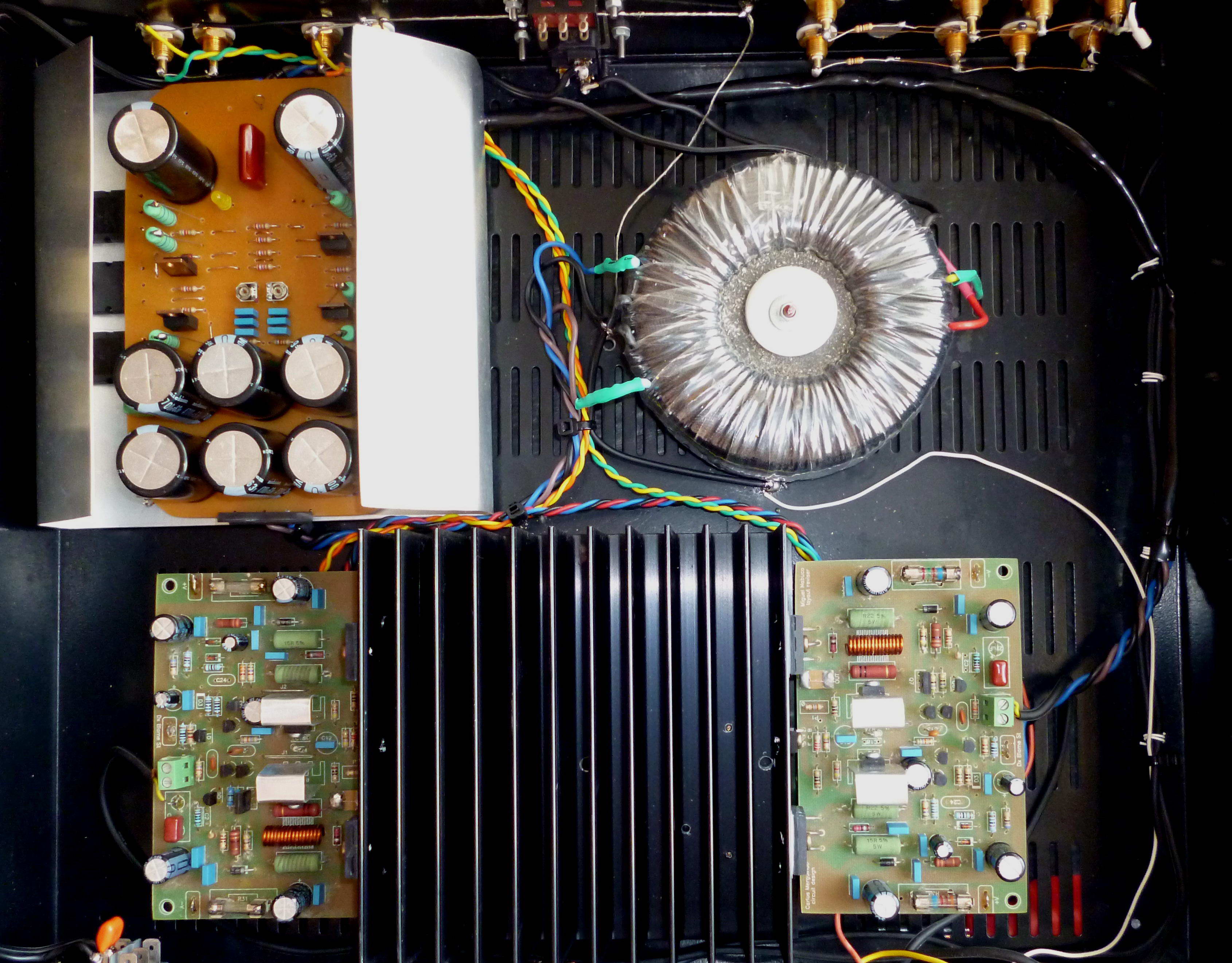

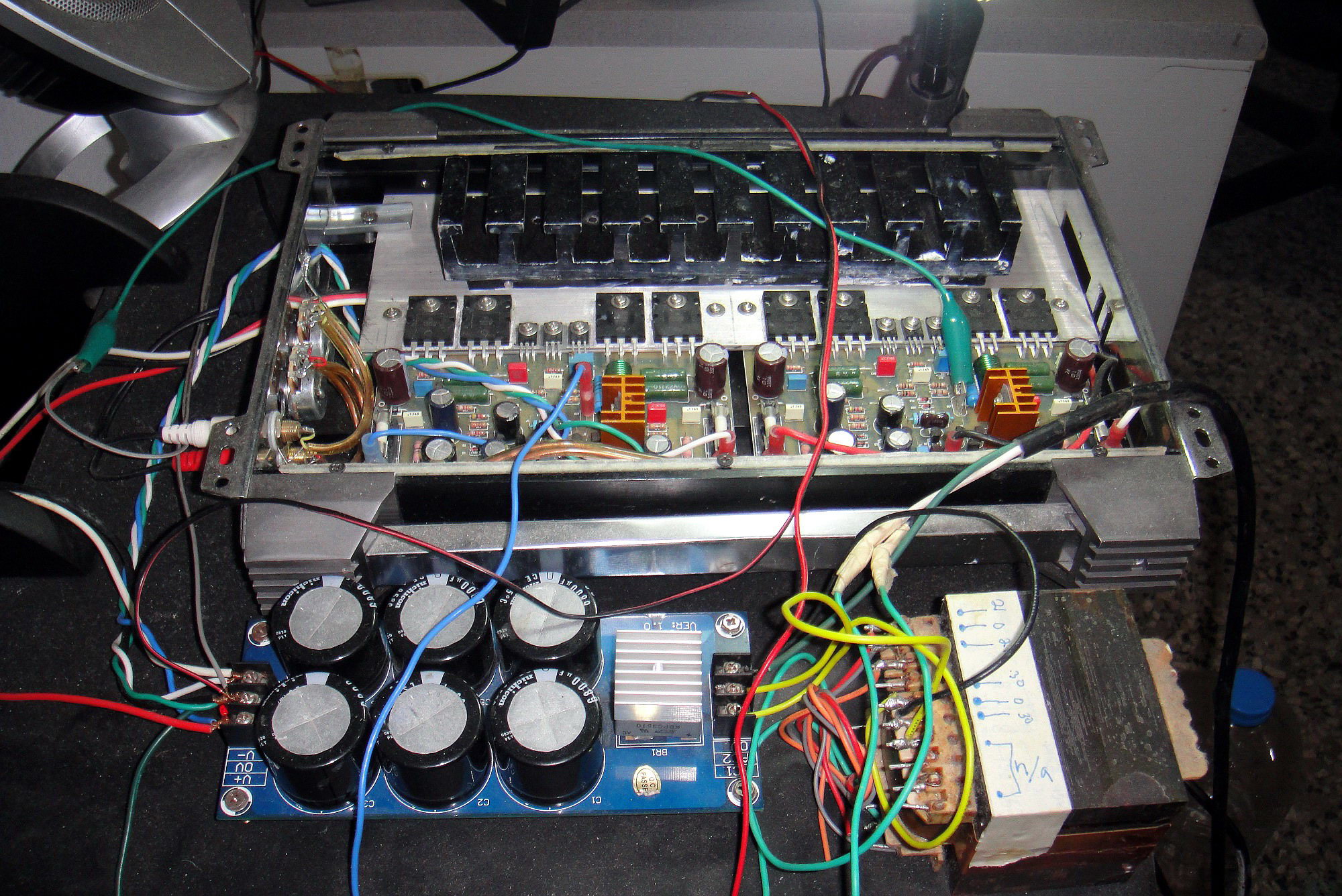

Juan Vargas has installed his Dx Super A inside a power amplifier enclosure
result nice.
He needs Kerozene (aviation fuel) to remove the white stains from the thermal grease only.

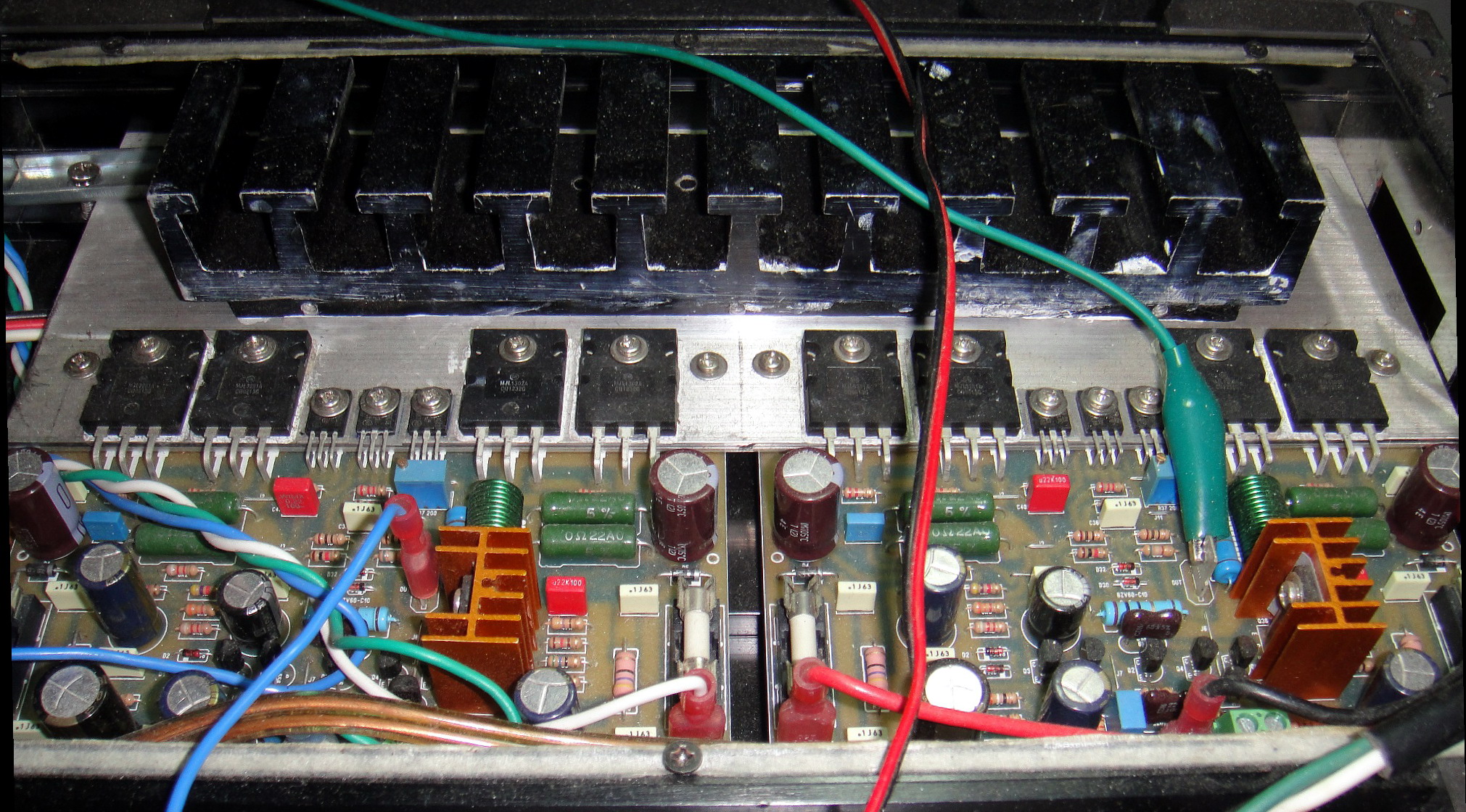

It is a bass amplifier made to Mitchel (Miguel Nabuco)
He will install a variable slope input filter and will sell it using his home page...it is for Brazil only i think..but not sure.... this is for the future...he have not even started the project... he just have the power amplifier that was an order made by him...just that...this may take monthes to be acomplished..for a while...i am having fun myself, doing one unit, my style, for my own use and fun.
Amplifier design was sold..not mine anymore... i am just producing a pcboard with his amplifier and an ampletos modified active low pass filter (traditional and regular operational amplifier working as an active filter..something normal that you can find in any electronic book with OP Amps application).
This is to have fun, as i said...doing the stuff to test the power amplifier deeply, as prototype was already made and already tested..but i want to see it in a long run, to figure out what gonna happens in daily use, when abuse, ignorance, monstruosities, abnomalies and these things often happen when young folks decides to make parties and to have fun bothering people around 🙂
Only me and Juan Vargas doing it..... for our use only.... to have fun ..... the real thing, the real bass amplifier will be offered in Brasil together a kit with supply, speakers and all stuff together assembled or not assembled in a metalic panel including protude heatsinks, switches, fuses, power cord, power on lamp and all needed stuff.
No schematic or layout is inside my computers or inside Juan Vargas computers..we had a lot of tries of invasion from China and Sweden Hackers...they could not have the schematics of MAKO and others because these schematics are outside the Hard Drive..they are in CDs.
While i wait mine unit (will be a gift, made to me, that gonna be send to me from Miguel... next year maybe) i will be having fun together Juan Vargas.
I am using a modified Ampletos (Low pass filter - Ampletos and Video Rockola from youtube... a kit internet company from Colombia, South America) and the sold dedicated bass amplifier sold (different from my amplifiers...made to subwoofer... exclusive design)

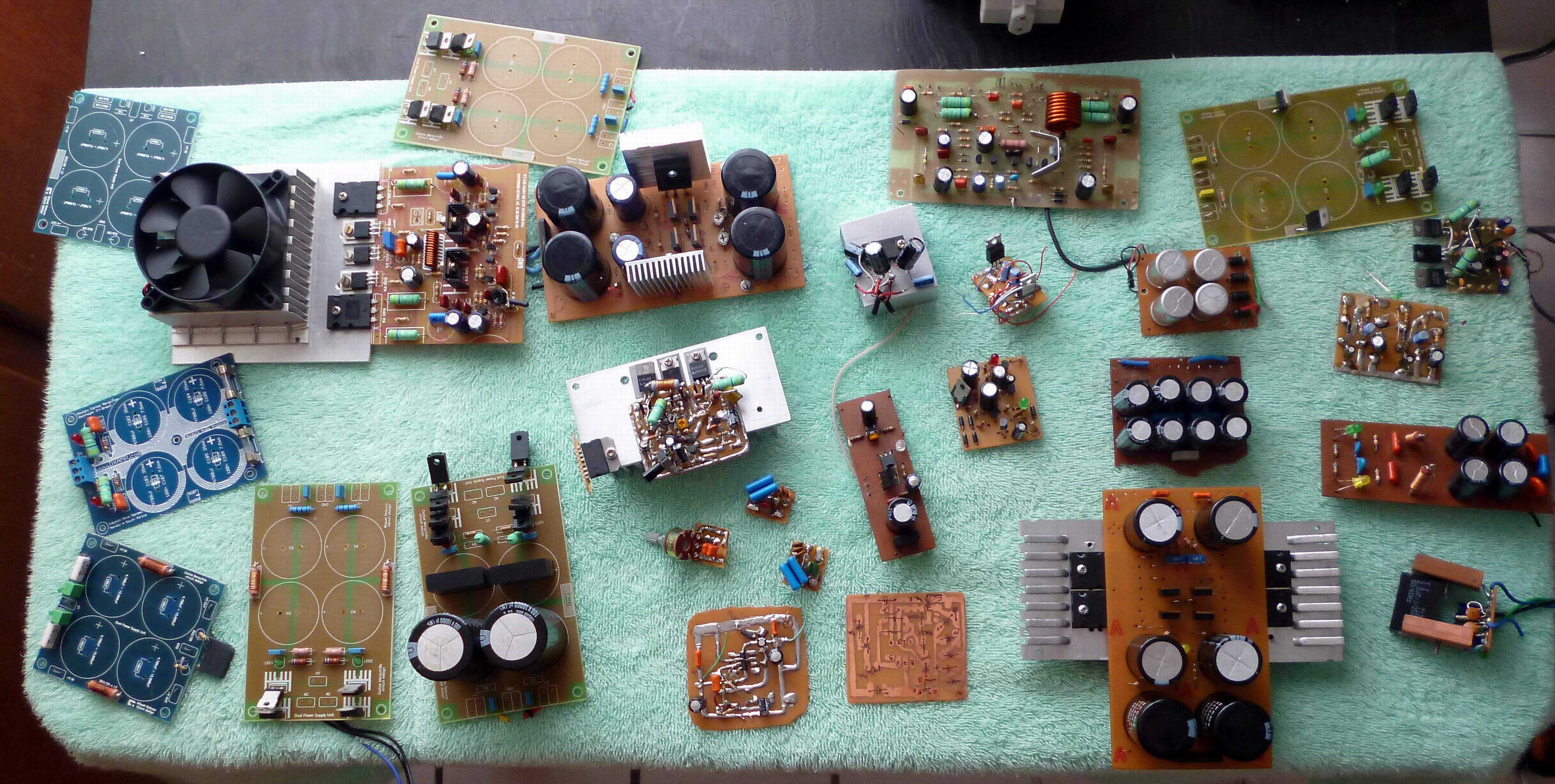

As i cannot show schematic...i can just post pictures showing i am having fun.... showing i am still active, doing things..but not sharing them anymore....i am more centered in myself now a days...more selfish and teaching electronics nearby my house at nigth.... in the morning i am at my Government Job.
About Mitchel...he has not started..this may take several monthes and i do think he will not sell outside Brazil because he already have too much customers in my country...much more than he can produce and sell.
You can do it by yourself...use a Dx amplifier..the one you have..then assemble the low pass filter from Ampletos..or buy his kit.... then install two resistors in the input (22K, 33K, 47K or 100K) that gonna colect audio signal from channel left and rigth (without disturb too much the stereo effect into the main stereo amplifier) and install also a trimpot in the low pass filter output...remove the 220N input capacitor and increase the feedback capacitor to 220N instead of 100N.... then you gonna be happy.
This one is simple.... a very simple, cheap and home made layout to have fun..nothing to advertise, anything to sell..it is not even mine anymore.
Here you have ampletos... something from Youtube..... these guys from Colômbia are making a very good job...the best job in kits and audio appliances from South America...i am proud to be in America because of them....not only drug traffic in Colômbia...there are good people there with nice know how in audio electronics...well..i love them deeply.
Filtro pasa bajos para subwoofer - YouTube
This circuit is in the application of any Operational Amplifier chip...it belongs to mankind.... it is the same to any operational amplifier and any operational amplifier will fit there...anyone....and the power amplifier can be a normal one... a Dx power amplifier or other.

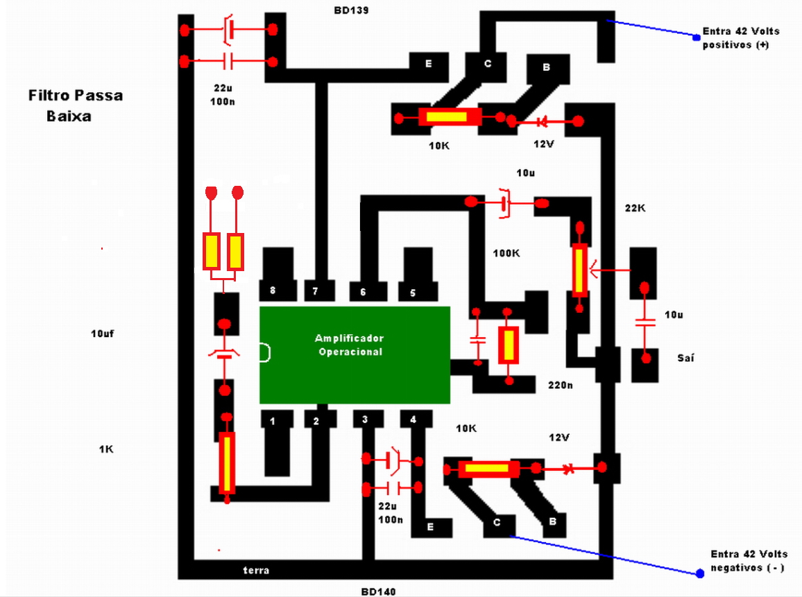

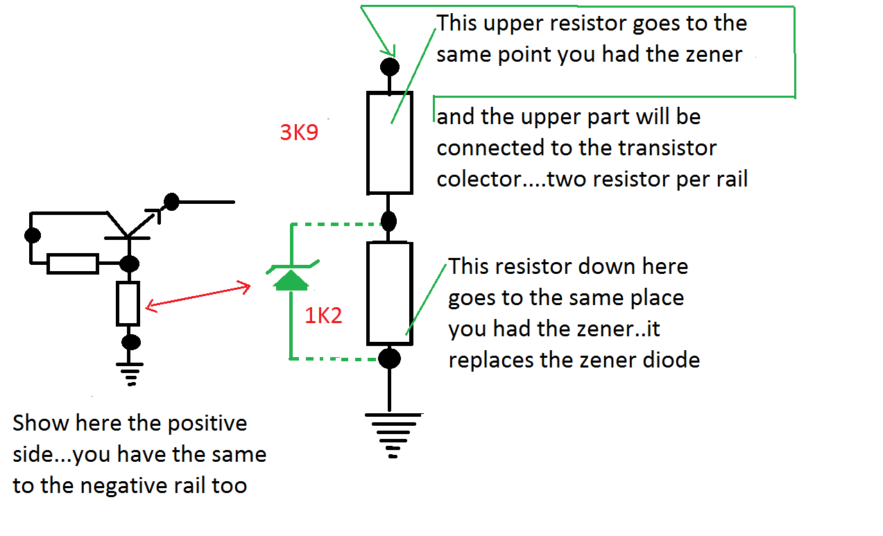

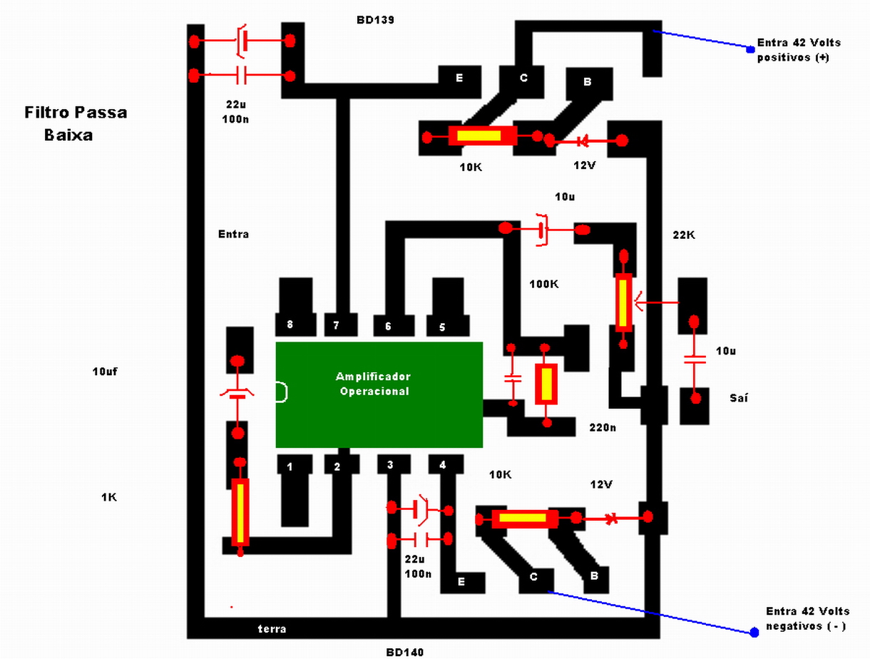

Here you have the low pass filter.... some kind of layout
Well...you can make it better..... this is just to show the idea and was made to help Juan to produce the pcboard layout to me (i still hate to use pcboard layout software).
Juan had no zener at home..then i suggested him to use resistor in place of the zener (image attached)
As he gonna use 49.2 volts..then the ratio of the upper resistor is 3 to one...the upper resistor is three times the value of the lower resistor...the one is in the place of the zener is the lower resistor.
You can use several values..not only the suggested ones...the zener can be even substituted by a trimpot to allow you to adjust your voltage..but be aware that some operational amplifiers gonna be damaged if you install more than 12 volts on them (plus and minus 12 volts).... so...trimpot is dangerous.
If you decide to use trimpot..then remove the chip, the operational amplifier should be installed in socket for easy replacement and removal..then you can mess with your operational amplifier supply voltage without harm the integrated circuit.

Here you have a better looking layout...this one has the input resistors missed
