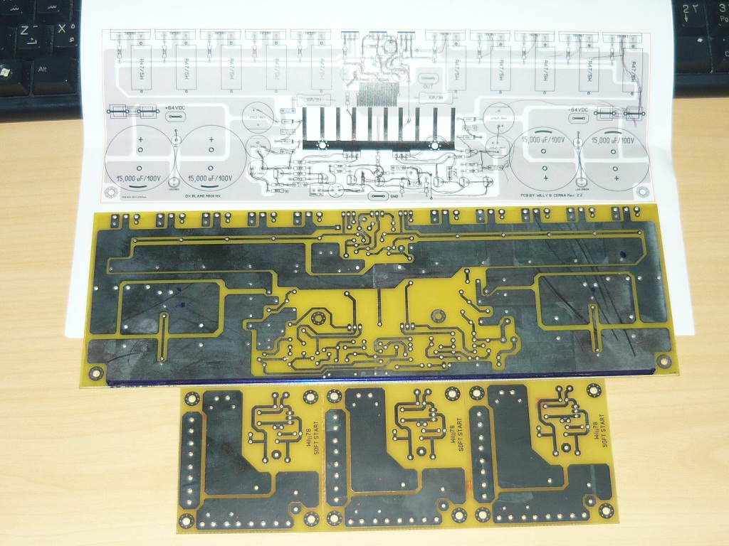

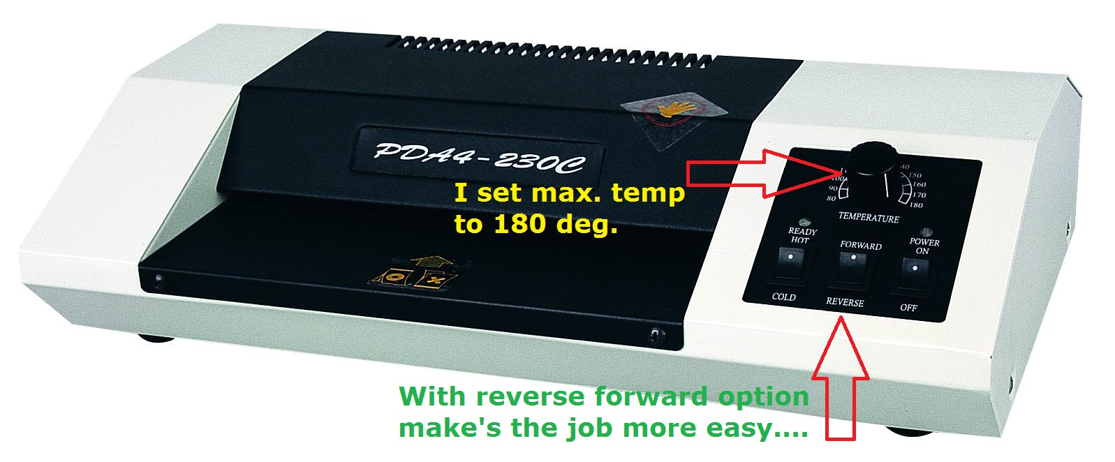

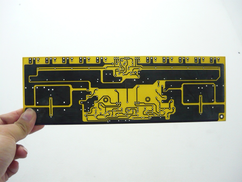

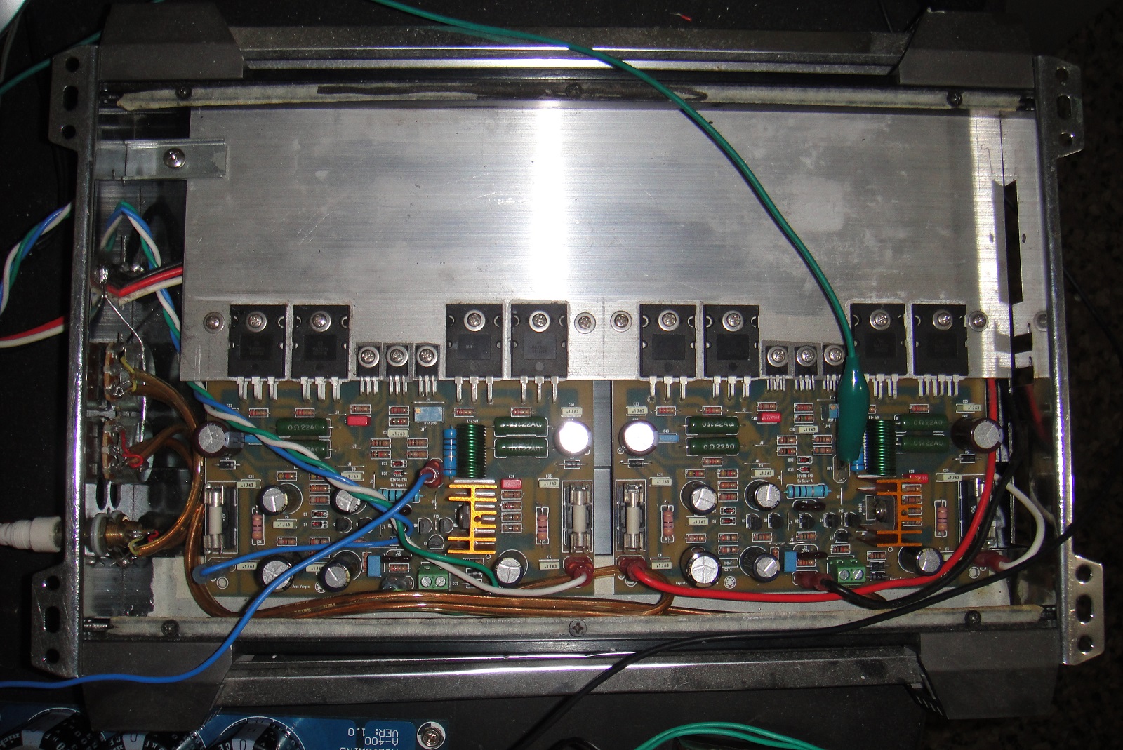

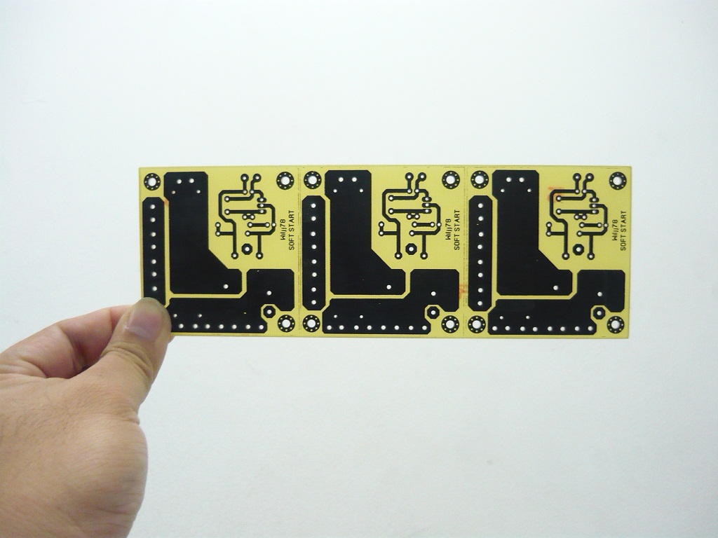

I'm using this laminating machine, see the result i have etched today the second channel of MKIII.
One supply per channel may be good....but avoid 2 ohms

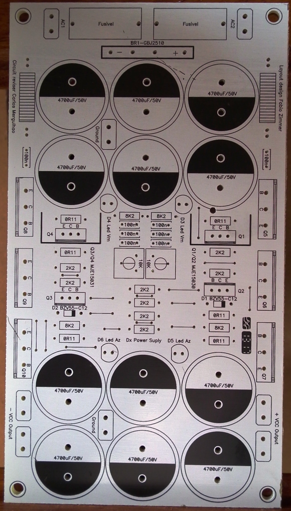

Your supply looks good Project ... très bien!

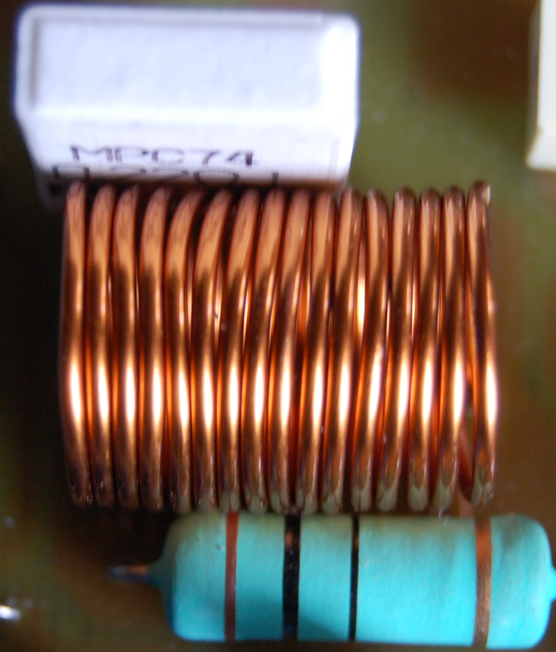

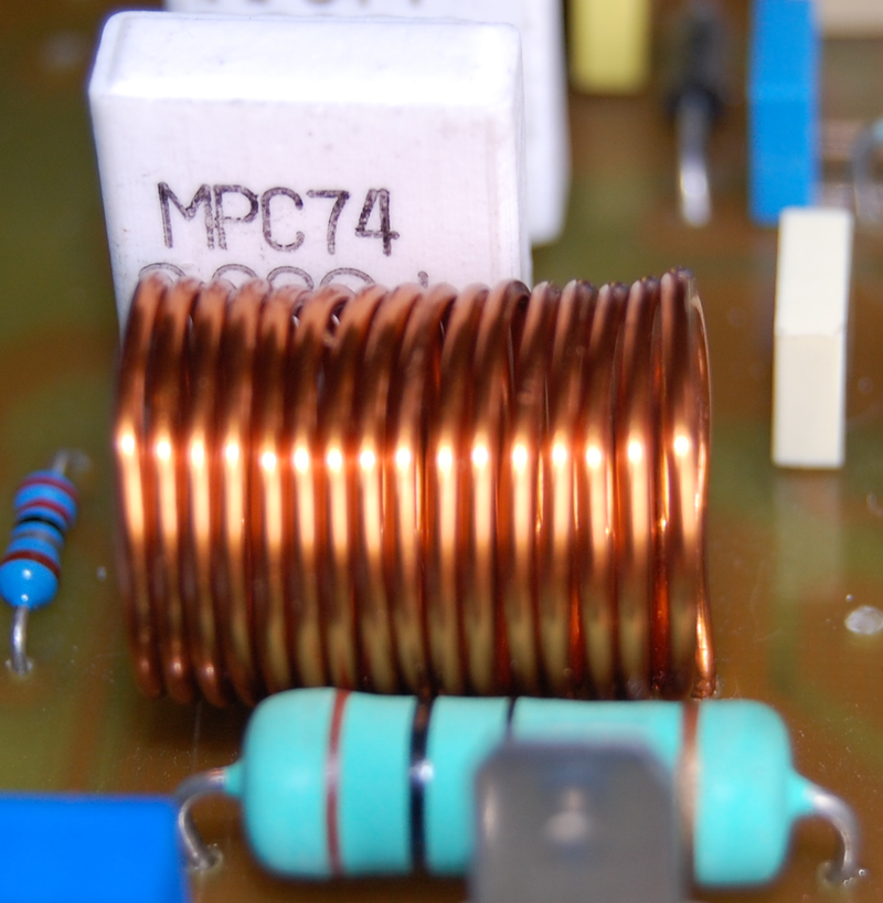

Not beautiful Inductors
Hello Carlos!
I can not make perfectly round inductors, my thread has small twists.
Is this is a problem or not?
PS: To finish my DX Super A, I expect the decks power!
Thank you and happy holidays!

Well as Carlos explain me many times the zobel network is a ( "just in case" ) to avoid frequencies from close by FM stations, that is how he explain me also add stability on the output of the amp, and the speaker wire length too will help avoid distortions , there is more to it but I bet you already know that, 1 mm wire is about 18 AWG is ok, so you are putting together Dx Super A? don't forget to post pictures that give me a lot of motivation, about Carlos he is having fun with his families he deserved, have a great day sir.

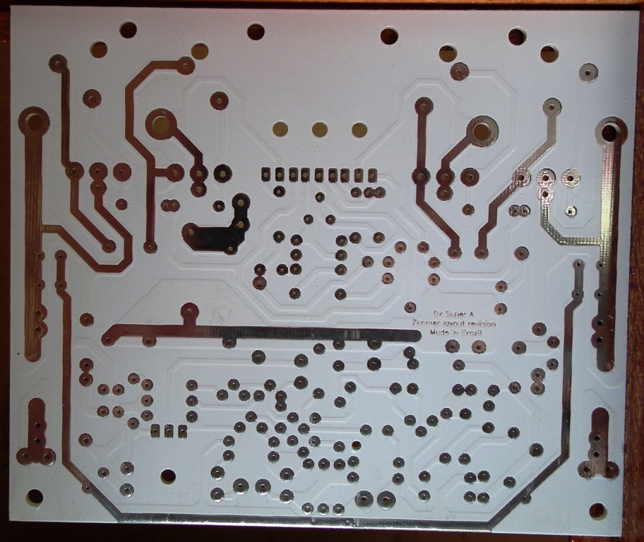

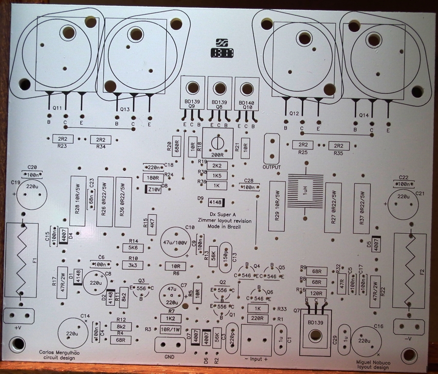

Sorry sir I didn't not pay attention you say you got Sanken tran since 80's holy cow man ! I knew someone like those Sankens lol well here is my future project that I can not take out of my mind this will be later I hope you like it sir.
Regards
Juan
