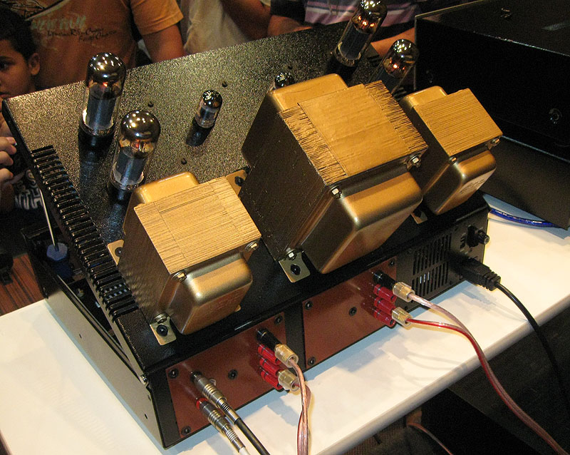

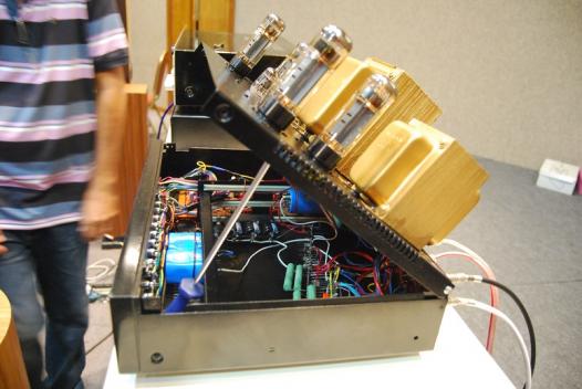

Here some more images..Audio Fest Rio 2010
attached,
You see..audiophiles looks the same all over the world.
regards,
Carlos

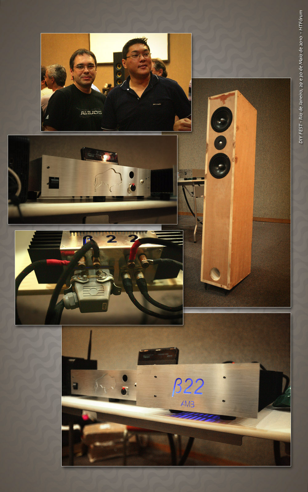

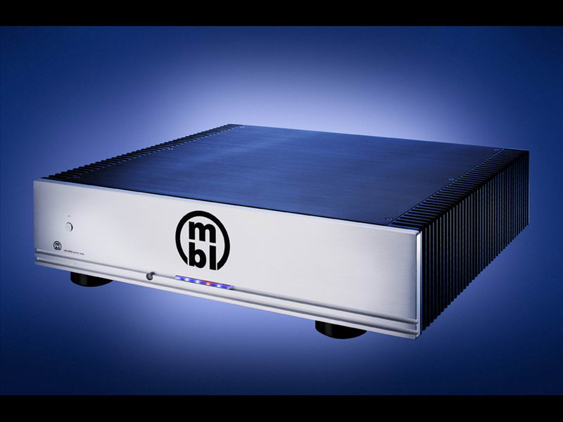

A clone of this one was presented, and sounded very good too
almost have matched the Dx Blame (same circuit in my imagination), but had troubles with the protection circuit..entered in protection.
Sergio said the Dx Blame was the best... despite some guys found them even.
I can believe that...also left and rigth channels in the Dx Blame are even.
The first image, left side one, shows the original amplifier.. a clone, a copy, was presented in the audio fest...an amplifier made in China...the center one, the B22 is another amplifier presented in the festival
regards,
Carlos

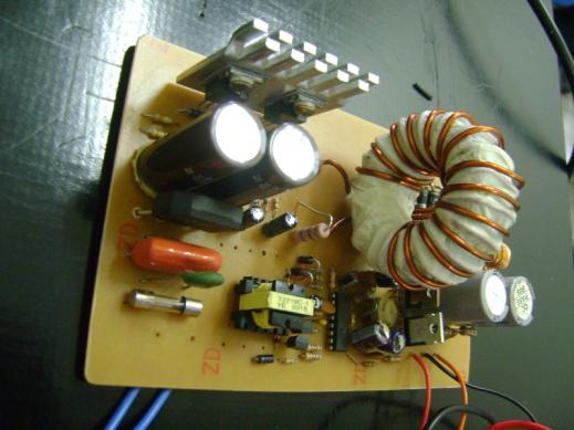

Exclusive supply, a brazilian design, a simplified supply is under test
to be applied to Dx Amplifiers...not a Dx Corporation design..will be tested and included as a suggested supply only.
Werley Brito, a brazilian designer is the one made it...will be used (if aproved) by license.
I cannot post schematic for a while..i have to ask Werley
a SMPS
regards,
Carlos

That's interesting one Carlos, tell us how the Dx Blame sounds with an SMPS please.

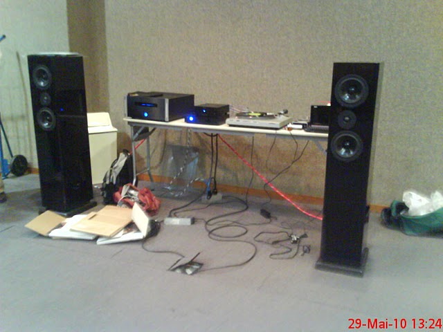

The Dx Blame ST was demonstrated to DIY and audiophile communitty at Rio de Janeiro
Brazil - South America.
It was the one sounded the best considering reports i have listened.
Place is Riocentro - Barra da Tijuca, near the Autódromo.
regards,
Carlos
Will do it Metal...and will keep you informed....give me a couple of monthes, i am in contact with the designer that will instruct me.
