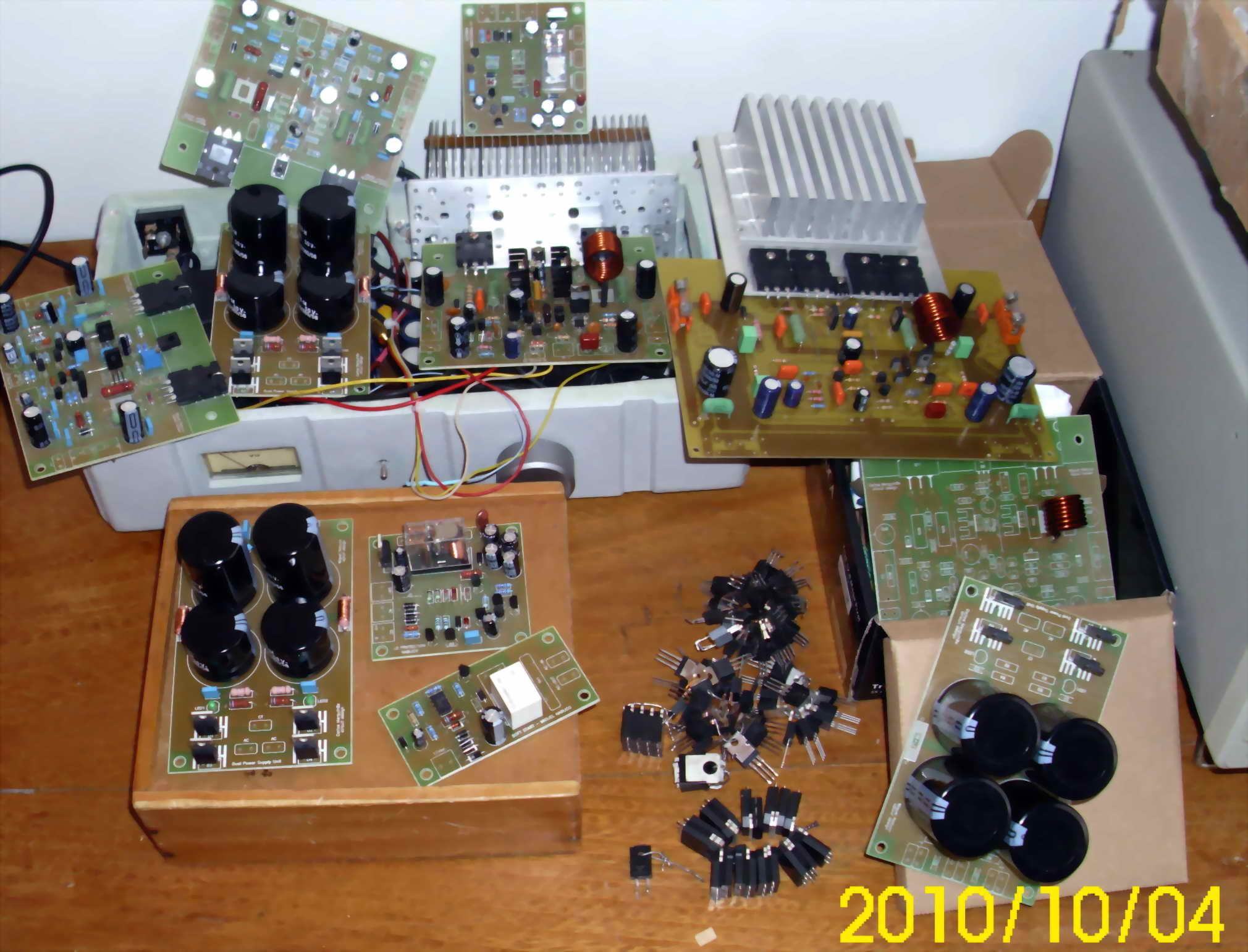

MKII will be released together the Supercharged, only in December,24
Do not wait...i am not sure it will be released or not..some folks in Brazilian forum give up to build the Dx Blame ST because the new models...so..i am thinking to cancell the new models sending them to release July 2011.
Dx Blame ST, Dx Blame MKII and Dx Blame Supercharged will be almost the same amplifier with specific features only...same sound..different input impedance and customized to difficult loads (MKII) and the Dx Blame with steróids to the powerholics or people that have non efficient speakers.
Will not offer upgrade as i want people to listen the ST first, to be sure they will not have any sonic advantage, these new models are for special cases..as i said.
Prototypes are beeing tested..a will continue to be till December, 24.
There's a lot of things running at same time here.
regards,
Carlos
