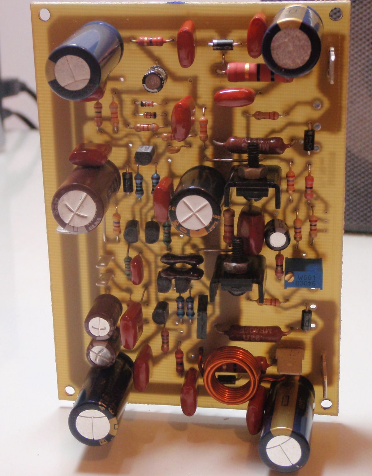

The first one to produce boards, customized to the Dx Blame ST
Sound buster, from Rio de Janeiro - Brazil
His boards are Taj boards, small modifications in the fuse area and final shape..more squared than rectangular....or less rectangular and more squared.... well...modified a little in shape.... he made to harmonize with the Dx Standard.
regards,
Carlos
regards,
Carlos

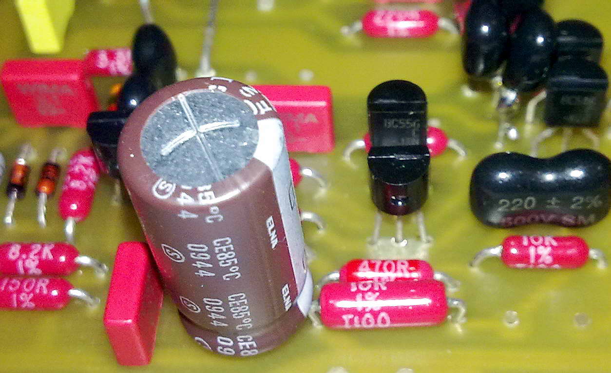

Mr. Hudnes Castelo Bonfim, from Maceio, State of Alagoas, Northeast of Brazil
is building the Dx Blame ST.
Famous beach of Maragogí...an indian name.... the last "gi" you pronounce alike the "gi" you have in Gigabytes.... it is the strong place..where you pronouce stronger.
Do you understand why we go laughing, happy as idiots?... we cannot be sad living in the middle of the Paradise.... when God decide to take a rest..you will find him here..of course if you're able to find him or see him...and IF..he really exists the way we imagine.
Carlos
Carlos

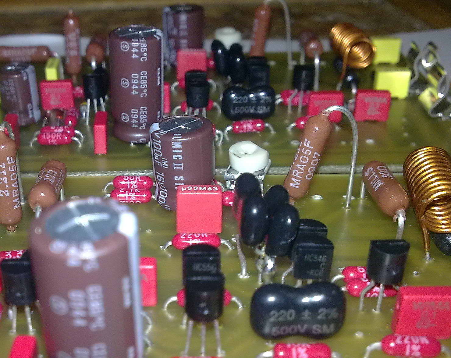

I am glad you have appreciated Zharmo... welcome to the Dx Corporation
you will be, you name and the picture (when provided) into the hall of fame..in the Brazilian Headquarters.
You have made my day...this nice feeling is my payment...i have made you happy and satisfied..this drives me happy and satisfied too...i lovely sensation..that i am usefull, that i can cooperate with others.
Please, share your kicad files with us..all them, as others can used it if they want.
Official boards are from Taj, but some folks may prefer your style...they are free to test.
I cannot guarantee your boards, as i have not build the ones..but you can inform when building (if build) with these published boards (images) and if they are stable, if had mistakes or something strange alike small distance from the output coil to the input...too much nearby lines related one to the other..too much long lines in parallel or possiblity of signal coupling having condensers (coiled) nearby different sensitivity and power stages....you can say that...i cannot.
Thank you very much, welcome officially to the "Corporation" of friends, as you have built and published picture and small review about.
Carlos
Carlos

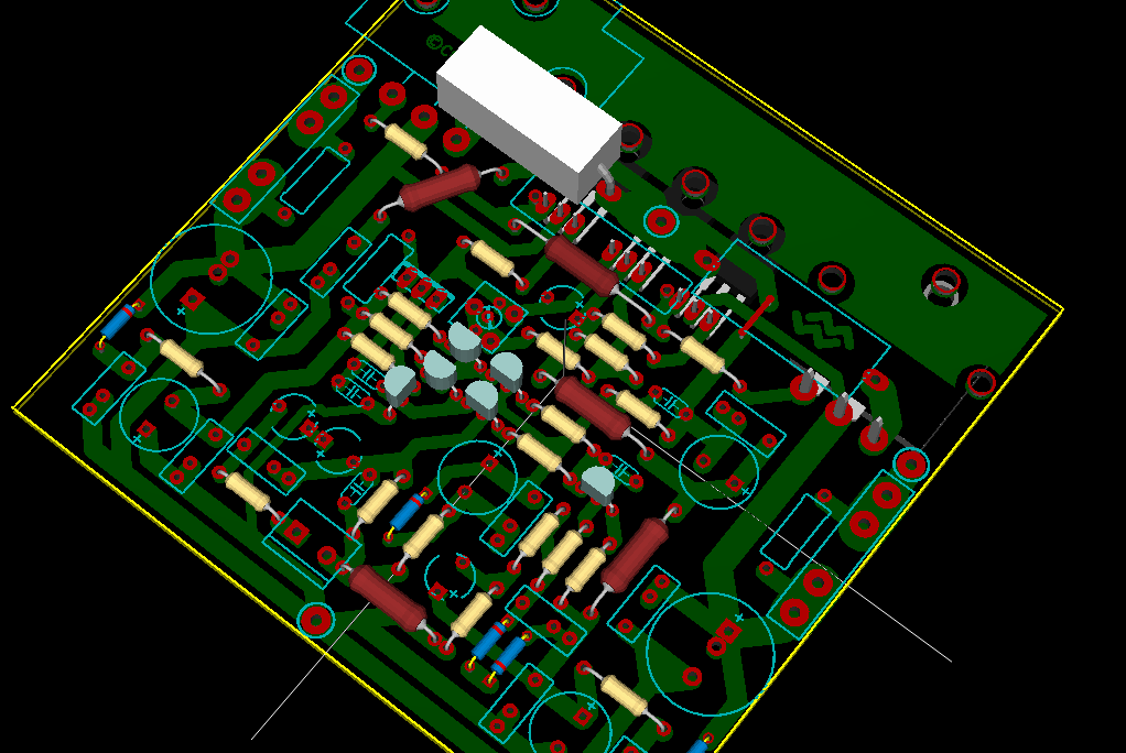

No guarantee
Yes, I cannot guarantee my boards style too. i just build what i wanted.
no deep test, have no tools for test... just simple multimeter to measure bias current and dc offset. the rest is my ears...
and the result for myself is... very nice sound
As carlos said, the board may have weak, nobody prefect... need to deep test but not me 🙂...
please, somebody who interest to use my board style... tested the board... modified to made better... published the result into forum.
again, my latest DX Blame ES board style with KiCad files format.
This ok, that's Ok..all Ok..... no problems....
Now i have kicad too.
this is good, that's good...all is good!
I like your style.
Carlos
I like your style.
Carlos
Xman -- Yea Kicad is the schezel. Schematic and PCB - easy to use, and powerfull. Picture above on the left is the 3D feature. Very flashy and good.
Bob

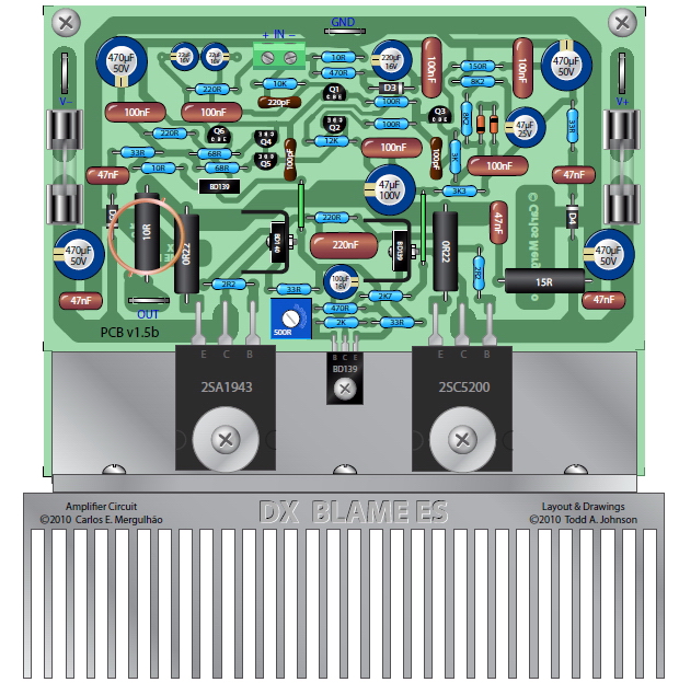

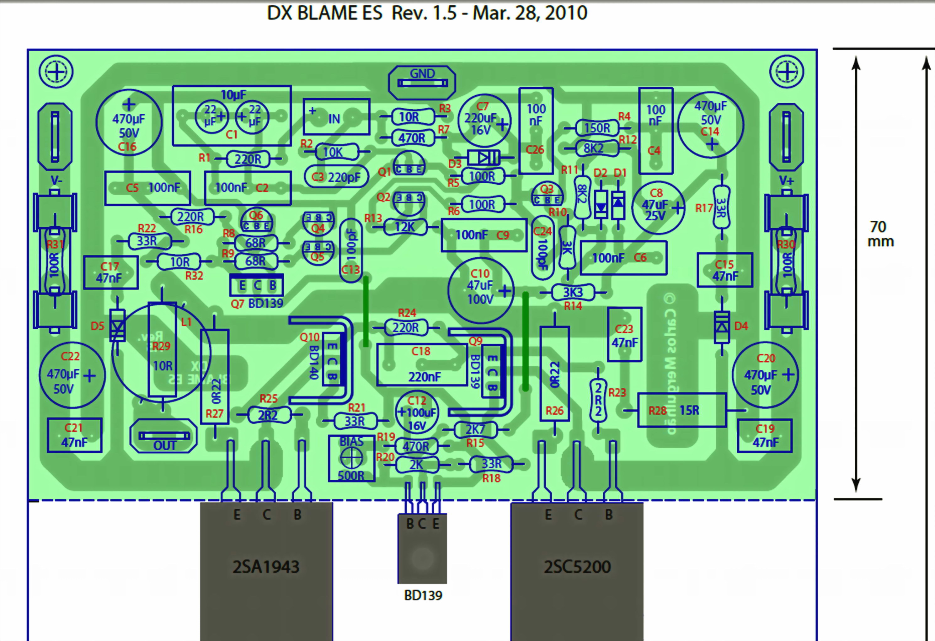

Now we have schematics, layouts and x ray vision having the ending name ST printed on
it... finally,.
These files will be uploaded immediatelly to Greg site.
regards,
Carlos
