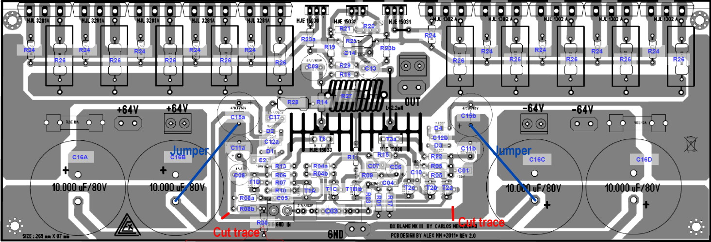

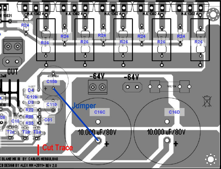

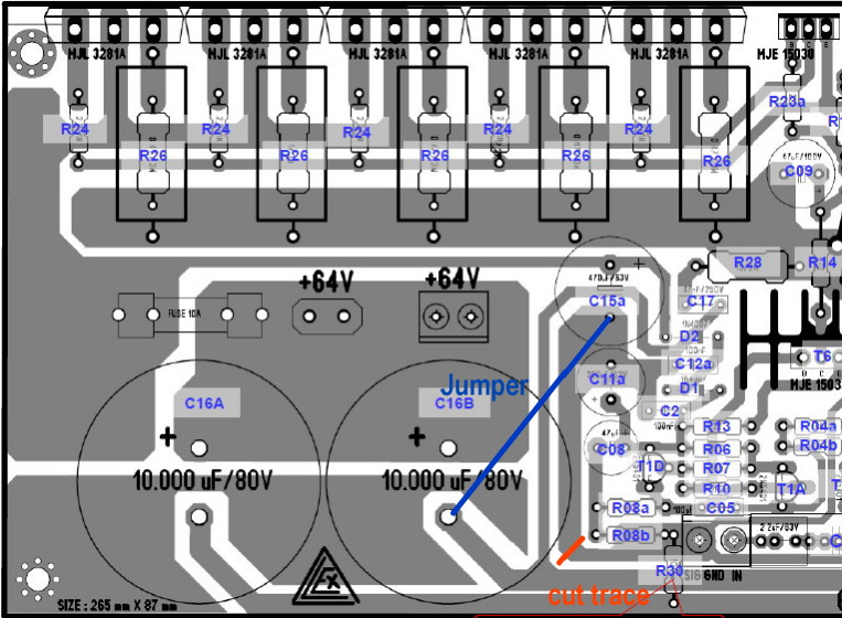

OK, I have looked over the boards and it seems that two trace cuts and two jumpers can solve the lifted ground issue. I am posting a couple illustrations for discussion. Please look them over and let me know if you see a problem with this change.
Thanks, Terry
Thanks, Terry
Hi Terry-
That's just what I had in mind and am planning to do. I think at the same time it would be wise to move the R17 ground to the star point. I don't think the bootstrap capacitor is relevant to the hum problem but it does seem to have some effect on clipping symmetry.
Thanks, Terry
I agree with your trace cut-outs. Position of R08b and R17 would need to be changed as well to connect to the star ground...
