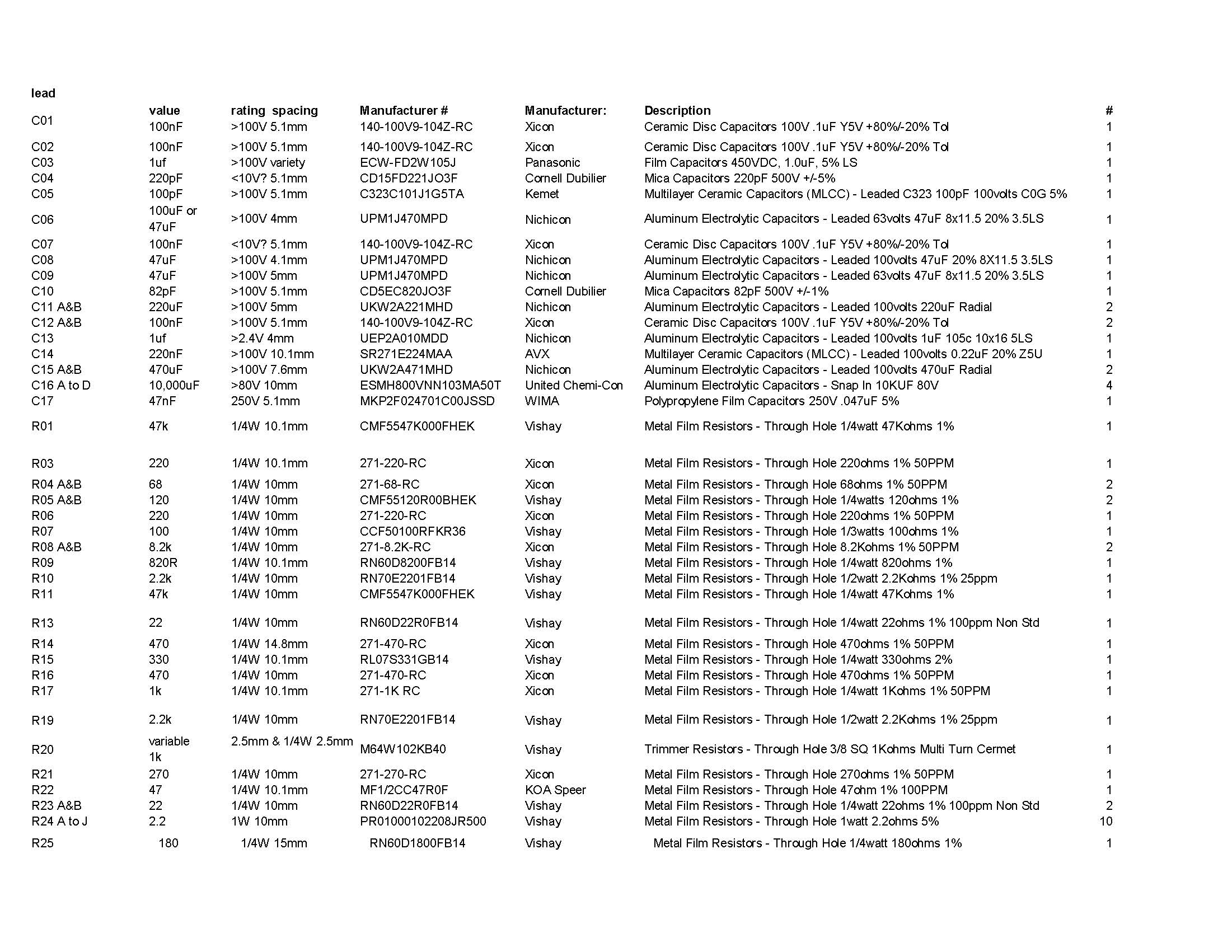

Hi Guys,
I know I'm late to the party but I just got my boards and I know there have been componant changes since this all started. My boards show values rather than part numbers. Did anyone make a silkscreen shot showing part numbers so I don't have to try and figure them out from the schematic?
Thanks, Terry

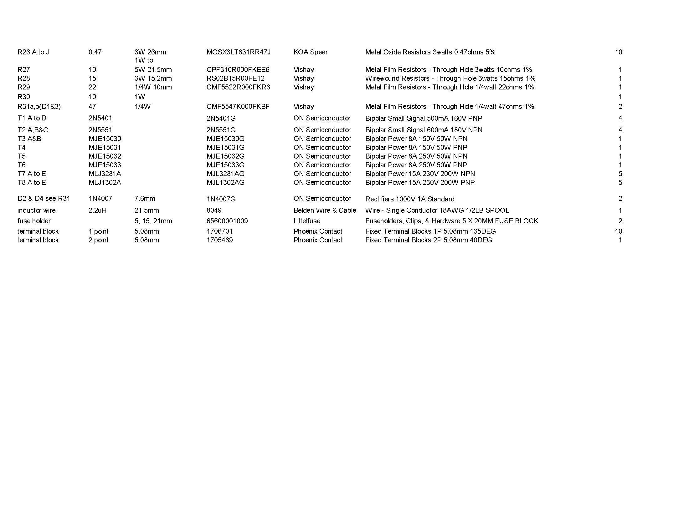

Another question. I am presently trying to update Byron's BOM. He shows an R30 at 10R, I can't find that resistor on any of the schematics I've been able to able to dig up. Also, Carlos shows replacing D1 and D3 with 47R resistors. What is the watt rating for these?

Under normal circunstances the dissipation there is 67 miliwatts
So, you can use 1/4 watt resistor.
It will behave alike a fusistor....if current increase too much due to component failure, then it will burn and will open the circuit the same way a fuse does.
Install it with clearance in relation the pcboard surface... 2 milimeters is enougth

OK, I updated Byron's BOM with what I think are the latest updates. Someone who knows, please check it for accuracy. I have it saved in excel so I can make changes fairly quickly.
Here's my inital comments:
C03 is the input capacitor; 1uF is a suitable value and it should be a high quality film type. Polystyrene would be ideal however it won't fit on the board; Polypropylene will. I have selected Panasonic part ECW-FD2W105J for this component.
C04: I would like to see a quality Mica cap in this position. For example, Cornell Dubier part no. CD15FD221JO3F.
C08: 63V electro is inadequate unless rail voltage is < 56V. If 64V rails then 80-100V cap.
R09: this value along with R11 determines the amount of amplifier gain. 820R gives a gain of 58.3. I think that for high level sources or when driven by a preamp the gain should be reduced further. If you increase R09 to 1.5K then the gain drops to 32x.
If you reduce the open loop gain from 58x to 32x you might need to increase the Cdom (C10) to a higher value to maintain stability. Perhaps 100-180pF to be on the safe side.

Carlos recommends MJL4281/4302 output transistors for best performance and power. Having said that I am using MJL3281/1302 in your BOM because they are more readily available.

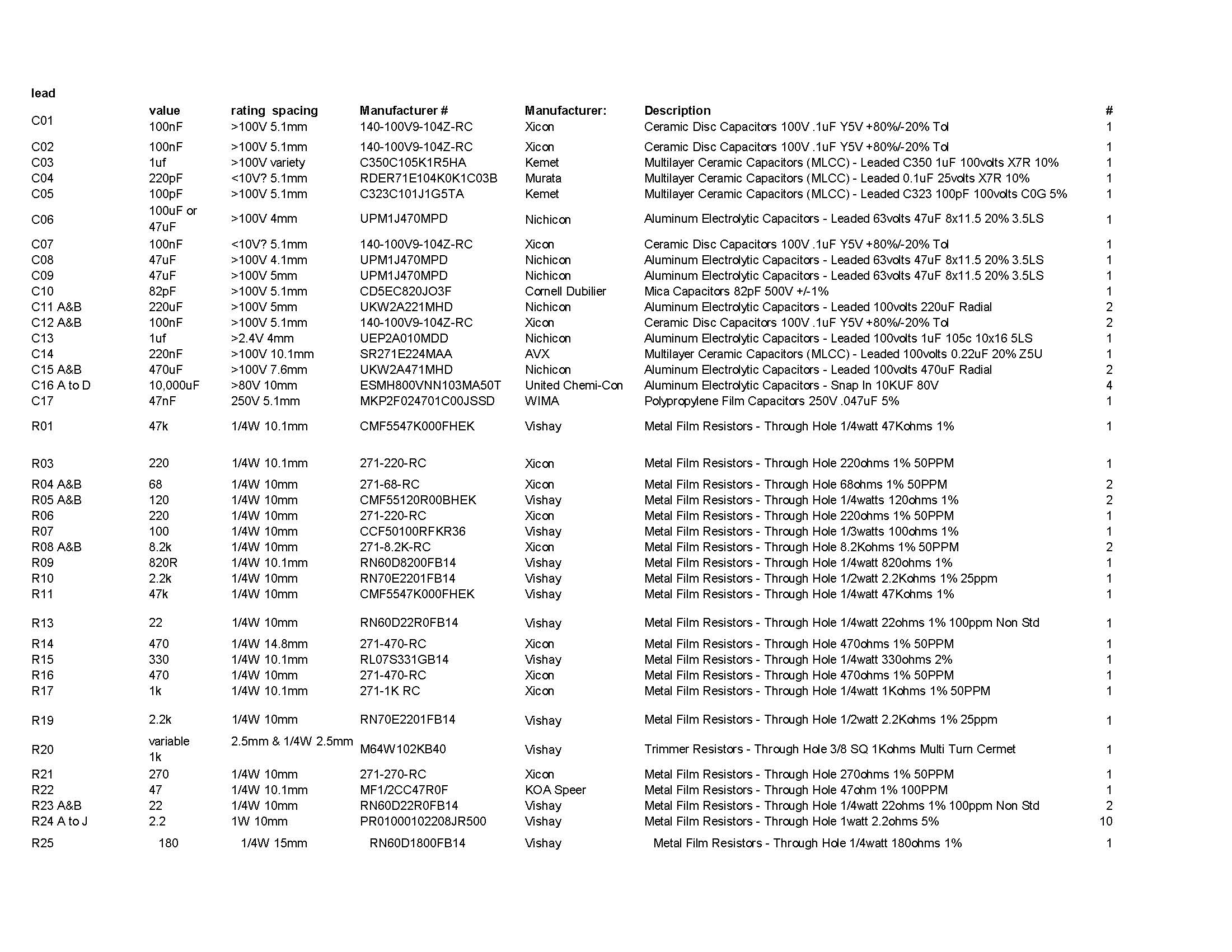

Hi Ranchu,
Thanks for looking over the BOM. I have changed C03, 04 & 08. I didn't notice that 08 wasn't 100V. When making up my order from Mouser, I had replaced it with UPW2A470MPD6. I just forgot to change it in the BOM.
R09 @ 820R is taken directly for Carlos' schematic in post #1764. I don't think Carlos likes using a preamp with his amps, just a pot. I will be using a B1 buffer which has no gain so I will probably try it as is.
I actually tried to include all of the changes shown in that schematic.
I am using MJL4281/4302 output transistors as I already have them. I left the BOM as is for the same reason you noted.
Also, for C03 I actually ordered MKP4-1/250/10P22. I'm not sure if it i any better or worse.
I am attaching the corrected BOM. If you or anyone else sees something else that needs to be changed please let me know.
