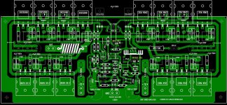

PCB
I found this design (image attached) anyone know where all the information is complete, they seem to realize companion show: Alex MM

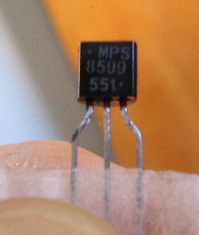

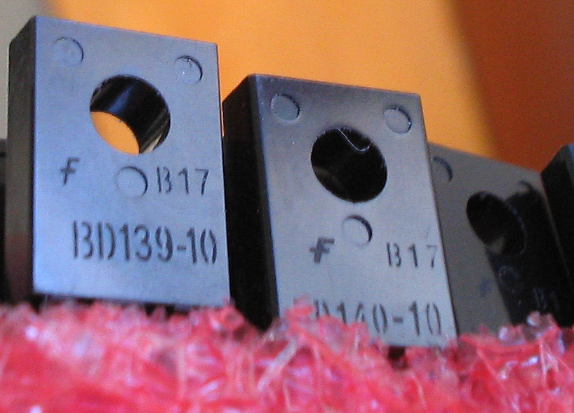

MJE15XXX transistors are popular..and they are the ones i have in my home
All them a kind gift from dear friend Evette (the Canadien).
I do think they are not that good...they can tollerate high voltages and because of that i have used them..also because people "believe" they are special...i do not think so...i have used then because i had to use them..no choice...they were the ones i have..they were the ones people approve...there are political solutions too..not only technicall solutions..if i want people to build my amplifiers i have to detect their beliefs and target their beliefs of special capacitor and provide room for them.
Try others folks....MJE340/350 is no good to...but you can try... i have tried..they oscilate very easily...maybe base to emitter capacitance or high gain..i do not know.
In my other amplifier i have suggested builders to remove 2N5551 and 2N5401, to use BC546 and BC556 instead and to remove MJE15XXX and replace them by BD139/140 and asked them to keep voltage at 42 volts maximum.
My home edition, as you know..is a smaller board..i have cutted it's sides and have used these transistors for comparison and for sure they sounded much better...why?... i am not sure, but i do think they are just perfect to this range of voltage and this range of current i am using.
BD139/140 seems to me to be very good units..they are here with us since sixties..and even now a days brazilians use these transistors in high end equipment because the resultant quality.
I am sorry...these transistors cannot operate with your high voltage.... they will burn because over voltage..despite i have used them into 55 volts for a couple of years without problems...that amplifier using BD139/140 is already operating in a friend's home....and he use to push the amplifier hard..he is 20 years old and loves to play loud music.
I have some MPS transistors , also some 2SC1815 and i gonna test them to replace BC546 and BC556... the problem is their voltage limit...so..only to low voltage power amplifiers.
regards,
Carlos

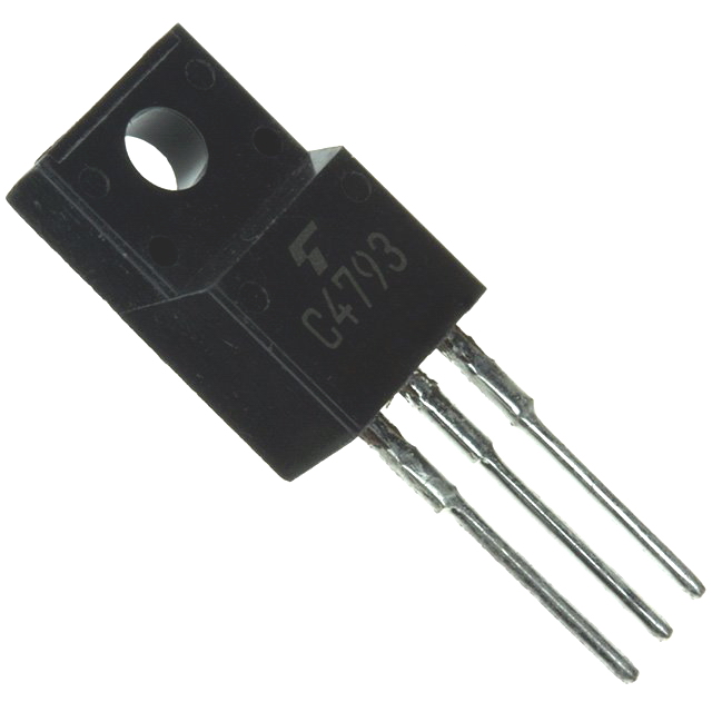

2SC4793 and 2SA1837 may fit
I have used them...sadly they finished and i could not find them anymore.
They are high speed...can operate at 230 volts and the internal capacitance is low.
It is made of plastic material (have plasticity, you can make it in the shape you want) that is an electrical insulator....due to that, the power dissipation is not that big..but current is fine and you will not need insulators for it.
Sound is good...i have used and they are fine.
regards,
Carlos
