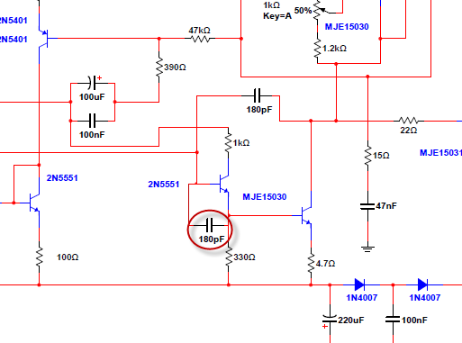

Because the miller compensation circuit includes two transistors, is there a risk of increased local instability?
Would it be beneficial to include a second capacitor as a feed-forward path which would bypass the emitter-follower at high-frequencies??
See pic.
See pic.
Miller compensation over the main gain stage, in this case enclosing 2 transistors is usually sufficient, Im not sure if adding a capacitor over b/e junction therefore increasing effective input capacitance would offer more pros than cons
Maybe adding a even smaller capacitor to form lag compensation, would be more beneficial

I'm still working in the simulator and I should admit that there's very little to tweak more. I have generated tons of fourrier and distortion analysis. That amp is tweaked to the bones. The only component alteration that improves things is to put the 56R driver base resistor instead of the actual 22R. This improves significanty the distortion level and the "simulated" stability, in particular in a low-bias setting. With the 22R (and low-bias) the simulator shows ringing in the positive side of the sinus wave. The 56R resistor completely erradicates this ringing and completely confirms Bonfis real-life experiment.
Going beyond 56R shows a slight degradation of the THD performance, in simulator 56R is the ideal value.
Of course biasing to have 27mV at each output resistor also get rid of the ringing and clearly improve the distortion.
I'm almost complete convincing me that the only modification I need to do is replacing "that" resistor.

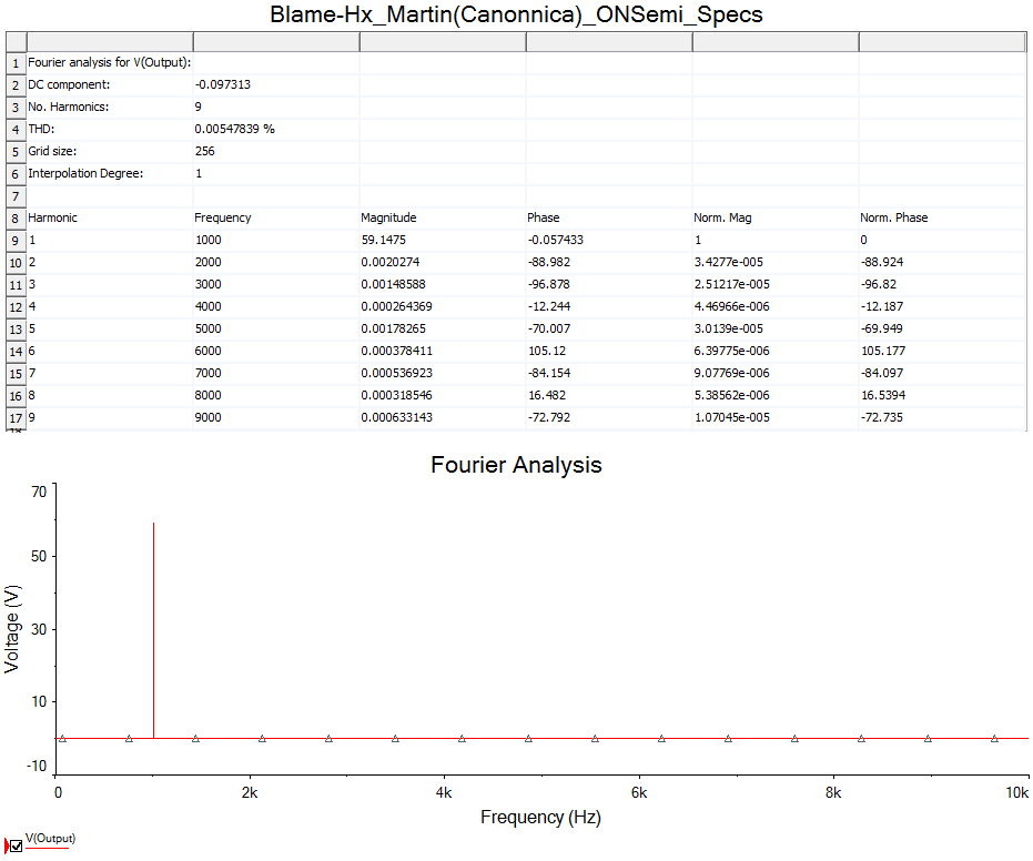

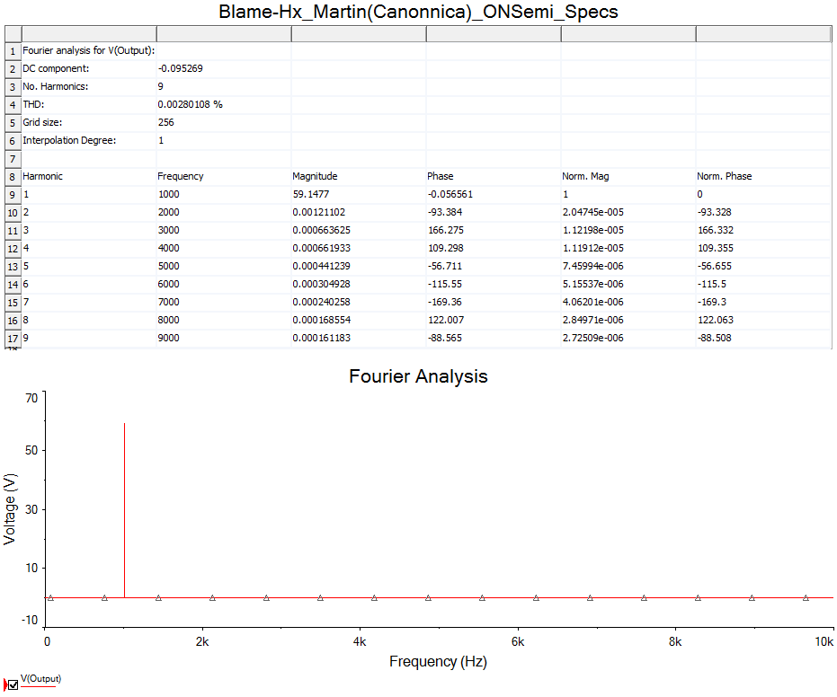

That's what i'm using since one year. I didn't open it since then. Along with simulation measurements.
Simulations made at full power (1.3VRMS input and 220W RMS at 8R load)

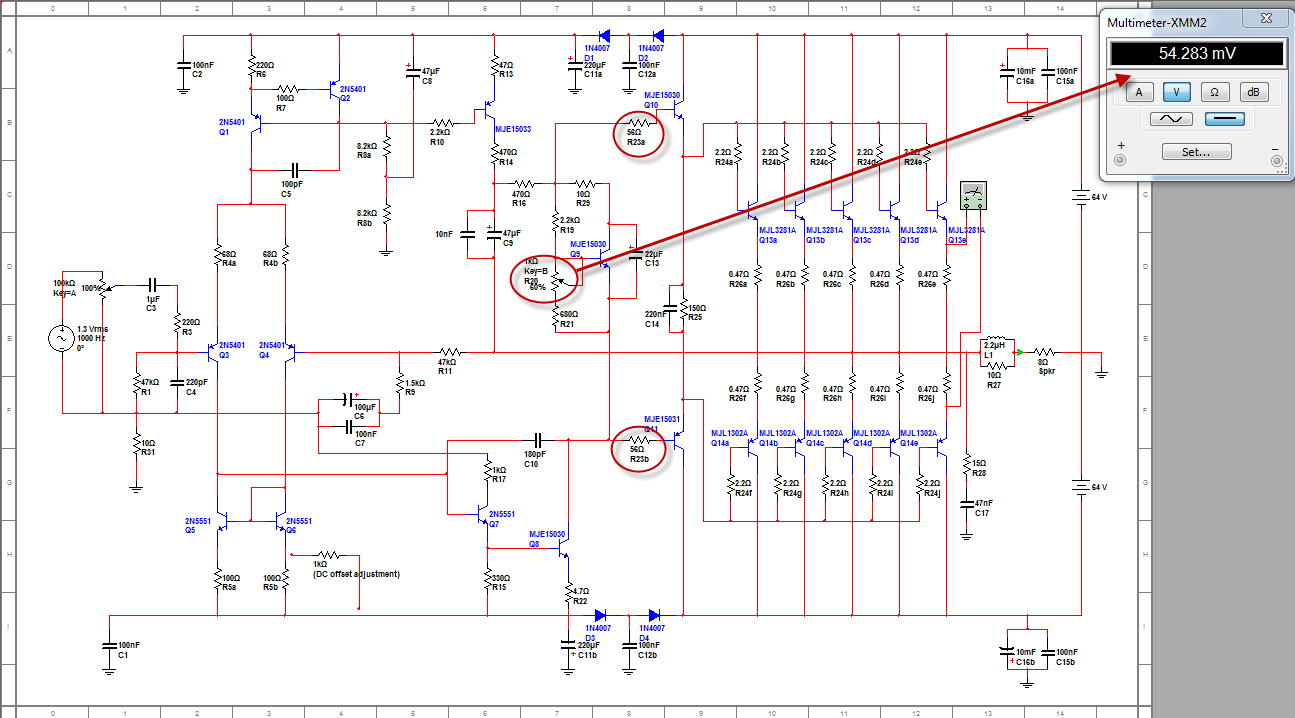

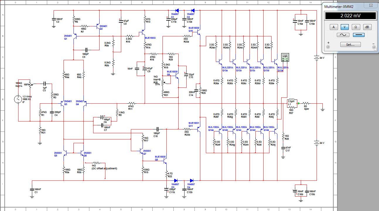

Here are the changes I want to implement.
The 56R resistor solely reduces the positive sinus wave ringing present in the sumultaor and confirmed by Bonfis. It does not alter the THD significantly.
The increase in quiescent current greatly reduces THD. The value across the two 0.47R resistors of 54mV is right on with the predicted value of Dr. Self for the lowest distortion level obtainable.

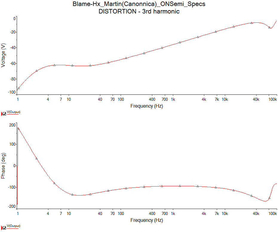

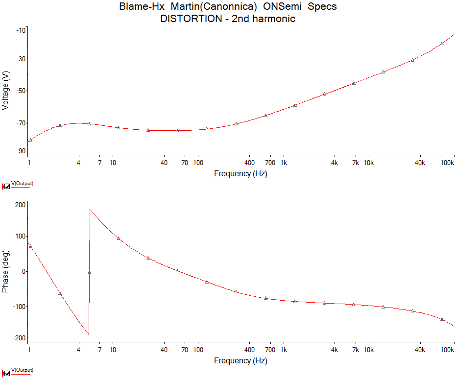

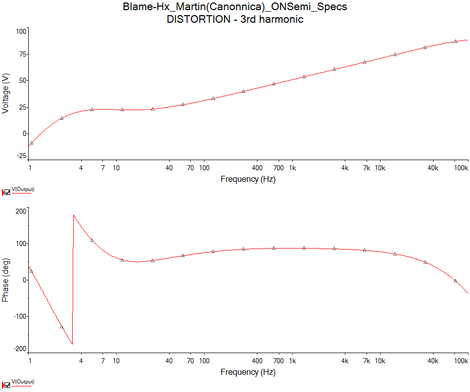

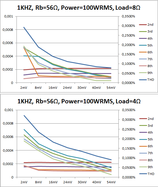

These days, I'm passing a lot of time in simulation. I try to evaluate the best combination vBias and driver base stop-resistor...
I'm exporting tons of fourier analysis into Excel spreadsheet to graph the results. Here is what I've found tonight...
These graphs represents the scenario where the resistor is of 56R in value and I only vary the vBias. The vBias is expressed in mV measured across both emitter resistors of output transistors.
The plot shows harmonics 2 through 9, their scale in on the left. The scale on the right is for the THD line (dark blue one).
I did these plots at a power of 100W RMS as at full power, the readings are scattered and they don't seem relevant. I will try other powers later on, it's very time consuming.
At 100W RMS, the 1st harmonic (reference output signal) has an amplitude of 40, the left axis shows the amplitude of other harmonics.
As I can see, the bias plays a very important role reducing the odd harmonics, which is logical as they're mainly due to crossover distortions. The even harmonics are not varying significantly, except for the 6th one that is quite high at low bias setting. I can't explain it now. I re-did the test several times with consistent results about that one...
I guess harshness is reduced as bias is increased and a warmer sound is expected... but i'm only into simulation right now.
Enjoy and comment!
I will do these plots for other resistor values and other powers as time permits

I don't follow.
I see % on the right hand vertical scale.
At the 0.1% level the harmonic for a 40Vpk signal (28.28Vac) should be 1/1000 or about 28mV.
The left scale shows values of voltage of 0.0003V (maybe 0.0002828), this is 0.3mV.
That to me seems to be a discrepancy factor of 100times.
