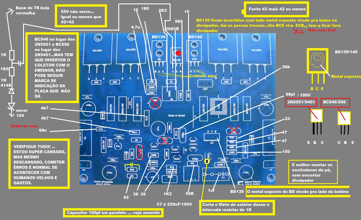

I cannot...i am old...i have 61 years old...i do not remember
You have to say all modifications you have done...also show me the original.... point alike exploded view all you have change position, also the component values you have changed.
The way i am showing in the image..also you must provide me the official image...the previous one..the one you used as a base to start modifications or improvements...have to search for it and post it to me...i have no time to do it...i am doing several things same time...really busy to go searching for images.
Watch my videos you will see that i am busy..each video takes a couple of hours..also the amplifiers and circuits to build, my home, my family, my work...all that spend my time.
See here and you may understand:
Dx Super A - Dx Voltage regulator - YouTube
and here:
Playing with the Dx Super A power supply - YouTube
and here:
Fonte Dx... como é essa coisa - YouTube
All these videos made today...almost 5 hours spent to do it...and more a couple of hours to the supply, another couple of hours to take care of my home, my wife, my daugthers, to make food, to cook, to wash dishes, to clean my pants...well... uncle charlie is busy..and slow, and old.
You must make all the "hard work", providing me clear informations for evaluation purposes...because all that stuff depends on concentration..depends on focus...i need to stop, to start think about, to understand what i have made in the past and to understand what you have made.
I cannot do in other way.
Also inform me were is the button to stop the time machine..then having it stopped i will have more time to watch your layout.
regards,
Carlos

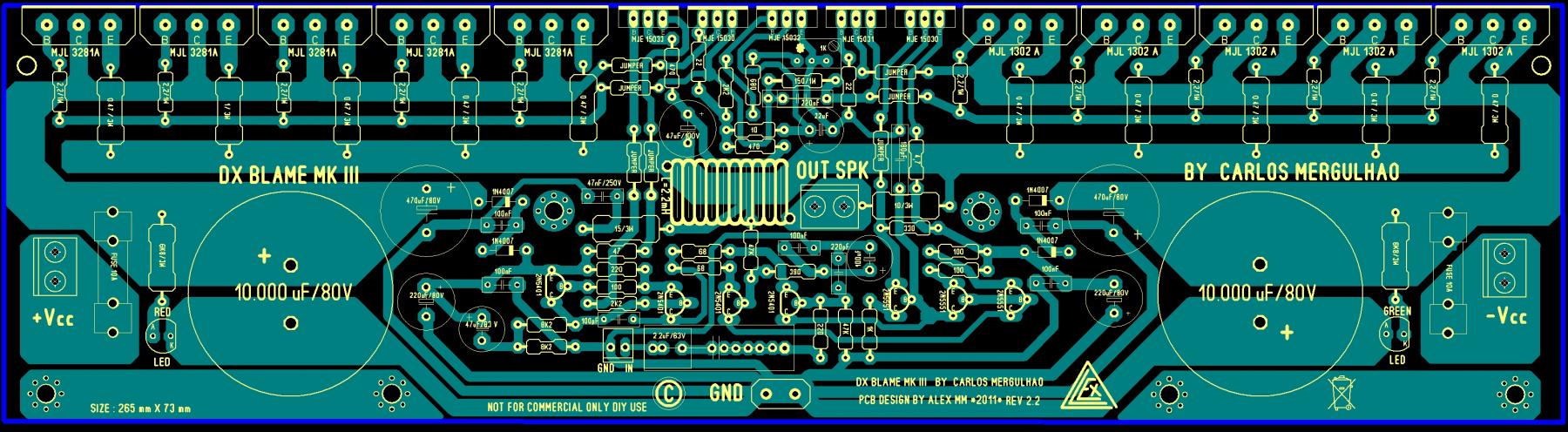

Sorry uncle charlie just to clarify that i did not change anything on this amp and no knowledge about designing or modifying amp.
I'll just grab this on below link Post#123 and i dont see your feedback after Alex post this on your thread.
diysmps
And wish to hear your comments of this Rev.2.2 (if you can), but if not well I'm still thankful for your reply.
diysmps

Mr. Carlos Sir,,I have really enjoyed building your many amps,,and I,ve enjoyed making them to my own taste. Your circuits gives everyone a very good solid platform to learn from..My only problem is I can,t move my hands the way I used too I suffer alot of pain everytime I decide to build something. But with your amps I make sure I build everyone of them regardless of how much pain..So please contiue to make your AMPS. Evette
If you want me to retune the MKIII i will do it Evette
Because i cannot dennie to you, a very good friend...but give me some time.
Retuning may represent you to substitute a few parts with the help of my dear niece Evette.
Just let me know your orders and i will do it the way you want it.
I would reduce it's power dear Evette, because this way i can tune it and also reduce it's huge price...people can cut pcboards with a hacksaw and build the same way i did, or they can etch using ony the central main circuit removing the other transistors.
To tune it correctly i have to calibrate to the supply voltage....if i do it to 55 volts, for instance, or 64 volts, then it will not be perfect to 45 volts...and the opposite is also truth.
I cannot make everybody happy...this is almost impossible, but i can make you happy...this is possible.
Give the orders, uncle charlie will be at your service!
In that period of time i was using scope (damaged) and tweaking by the scope and simulator...now a day i have returned to the old style.... i do start from the simulator but i go changing listening...this results better..i am not bothering anymore with the waveform..i want good sound...this is priority!
regards,
Carlos
regards,
Carlos

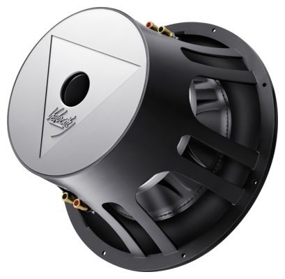

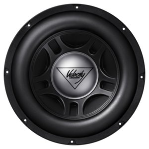

Looks like your subs have dual 4R voice coils,
So I'm guessing for this amp you'll wire them series for 8R load.
Getting Max Power into 8R takes High Voltage, difficult in car.
I have a dual voice coil sub in my car, but I drive it at 2R (vcoils in parallel) from dedicated CAR amp (1R 2R stable according to box it came in 🙂.)
Regards
Regards
It has dual 2R coil I connect in series to get 4R and 2 sub connected in parallel and it was driven with this Alpine amp. but this 2 fat boys was too heavy on my trunk so i have replaced them with 12" JBL, i wish this MKIII HX of uncle Carlos would be enough to drive into Max power.
