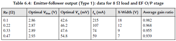

Output stage bias
Back with more questions...
The output stage bias. Carlos mentioned a way to adjust it: measure the voltage drop across output resistor to obtain 1mV. However in the emitter-follower configuration like the HX, Dr. Self has determined that optimum is very far from that value.
Dr. Self suggest a voltage drop of about 27mV across those 0.47r resistors... Am I missing something, or based on this, Is my amp very underbiased with that 1mV drop??
Please see the pics below that are from Dr. Self's book...

Since I can't measure output distortion, I rely on the Vre method for optimum ClassAB for output bias setting, unless the designer tells me otherwise.
You have to decide how close the amp output stage is to similar designs where the "professional designers" tell us of their method in comparison to Carlos' DX amp.
You have to decide who to put your faith in.

I did some testing increasing the quiescent current (bias) measuring the Vq that crosses the two emitter resistors (to prevent getting skewed by any offset).
When I gently increase the bias current, it gradually goes up to 43mV, then suddenly jumps to 140mV. Then I turn the other way around and it gently descent down to 110mV, then suddenly jumps to 30mV. I have to go back many turns to get back below the 110mV mark.
Looks like past 43mV, something is triggered that makes the quiescent current jump all in a sudden.
That was for one card, for the other, when I reach 35mV it jumps to 165mV, then when I go back it jumps from 80mV to 6mV...
Anybody have a clue for me?

The parameters of the output stage are changing.
The drivers and/or the outputs are going into oscillation.
The DX range of amplifiers are not designed in the conventional manner. They were put together with guesswork based on listening tests. Stability is not guaranteed.
Well, compared to the base design of Self's amps, the Hx is not totally different. This abrupt jump of emitter bias voltage is so unexpected that I'm wondering of the problem resides onto the design itself or onto components that reaches a breakdown point.
Il the simulator, I cannot reproduce that behavior, I can increment from a few uV to about 350mV without any jump.
I cannot agree with your comment "put together with guesswork". Dx did apply Self's "best practices" and he fine-tuned some values by ear. Look at the schematics of the Hx and compare it to Self's base amp... I don't speak about the Es amp Dx has put out, it was ... well, not good.
Still if someone else increases its bias voltage, please post results.
Martin.
Oscillations, 100%.
