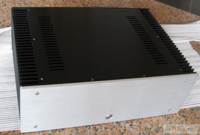

a pair of chassis and a pair of heatsinks could easily double that amplifier cost and more likely to treble or quadruple the cost.
to buy a pair of chassis and a pair of heatsinks will certainly cost more than 204euros.
Now add on some hardware.

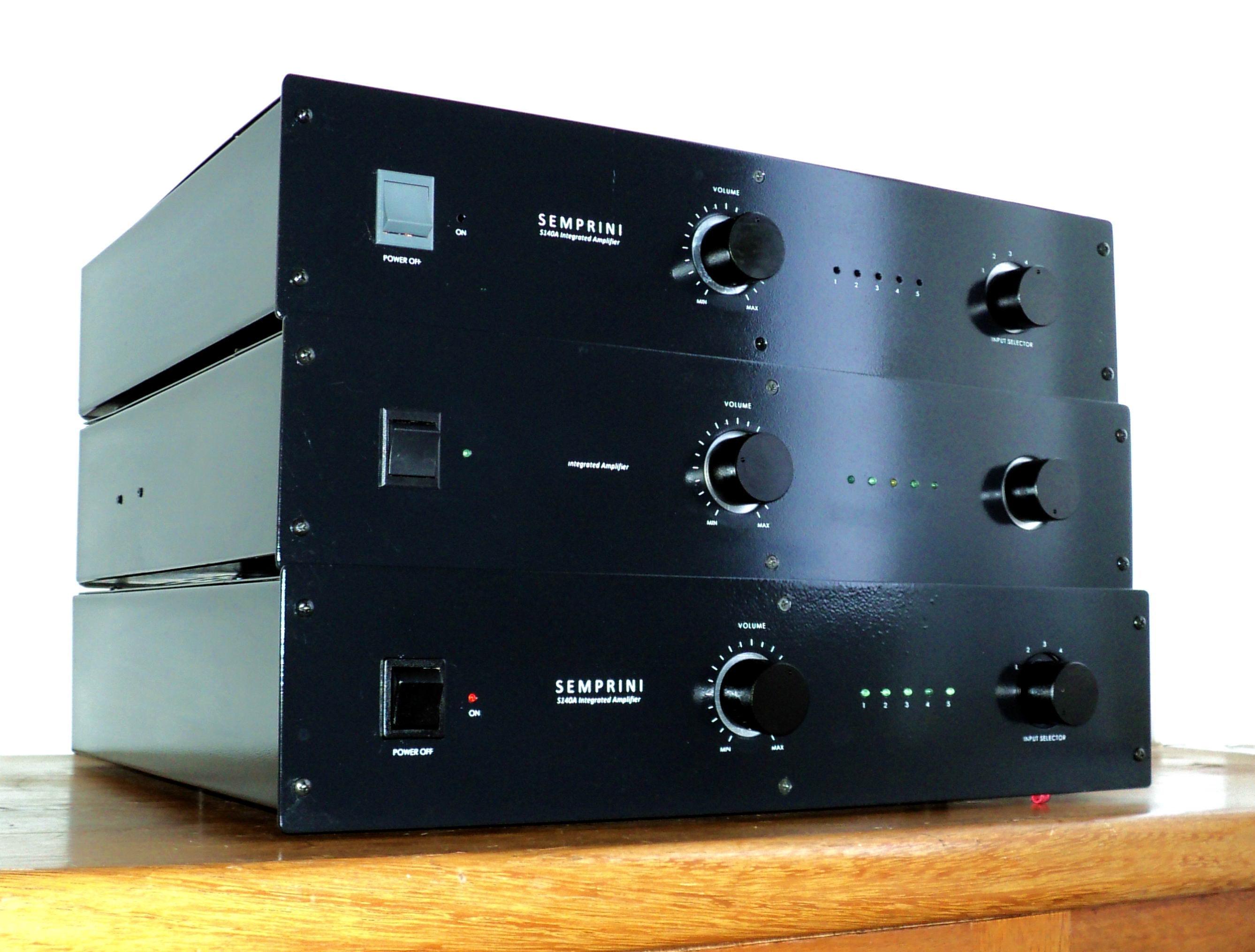

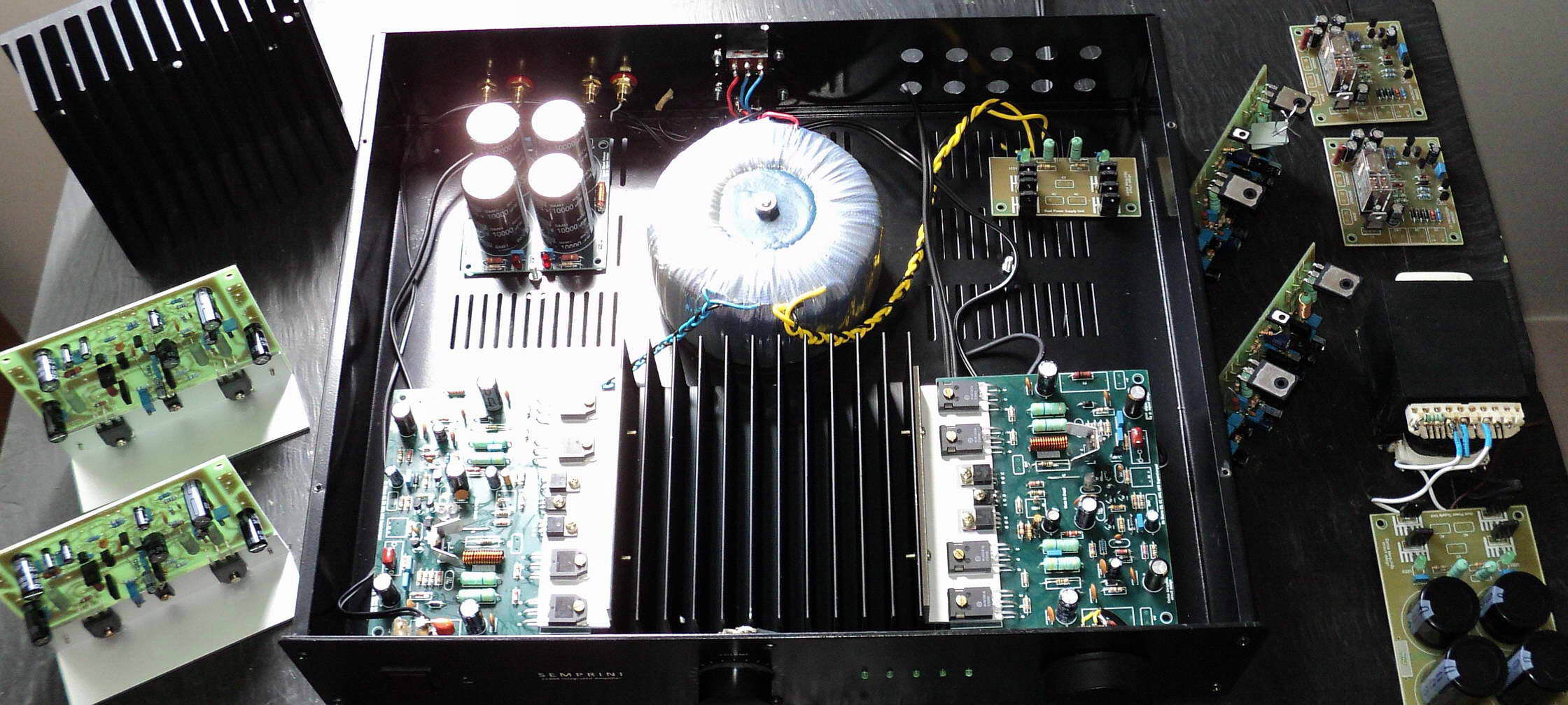

I also decided to use a single case, a single transformer and a single heatsink
to reduce cost..this way i could build much more units spending the same money.
Performance is not so good as spending more money..for sure it is less...but money is something rare at my side...i need to save the money i have.
Here you see mine unit(s)... case came from Mitchel as he use this case to a gainclone system and he accepted to sell me three units.... cost is high..around 150 USD each one...it is heavy and not very well made..good design but problems in the paint, the metalic parts does not adjust perfectly...well...not very good... he usually does not sell these enclosures..he use to assemble amplifiers and he sell to Brasil these units fully assembled (gainclones inside).... of course i have not paid all this cost... we have made some agreement to reduce cost..some negotiations with transistors and these things.
Semprini is his brand name to the Gainclone.... i will erase this name from the panel...because now a days it is much more Semprex (Semprini plus Dx) than Semprini.
Very good that Rudi will provide some small kit of parts.
regards,
Carlos

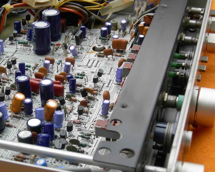

I do love white boards with black silk screen..alike Technics did in the eigthies
In the reality, each one of us prefere a different colour...this is the way things are.
I do think red and gold boards are the best possible choice...but i agree that may be tiring to the eyes.

It depends, Andrew.
If you like to have a fashionable ALU case, you are right.
If you are content with a wooden enclosure and heatsinks, found at ebay:
you have to add 40€.
Best regards - Rudi_Ratlos
