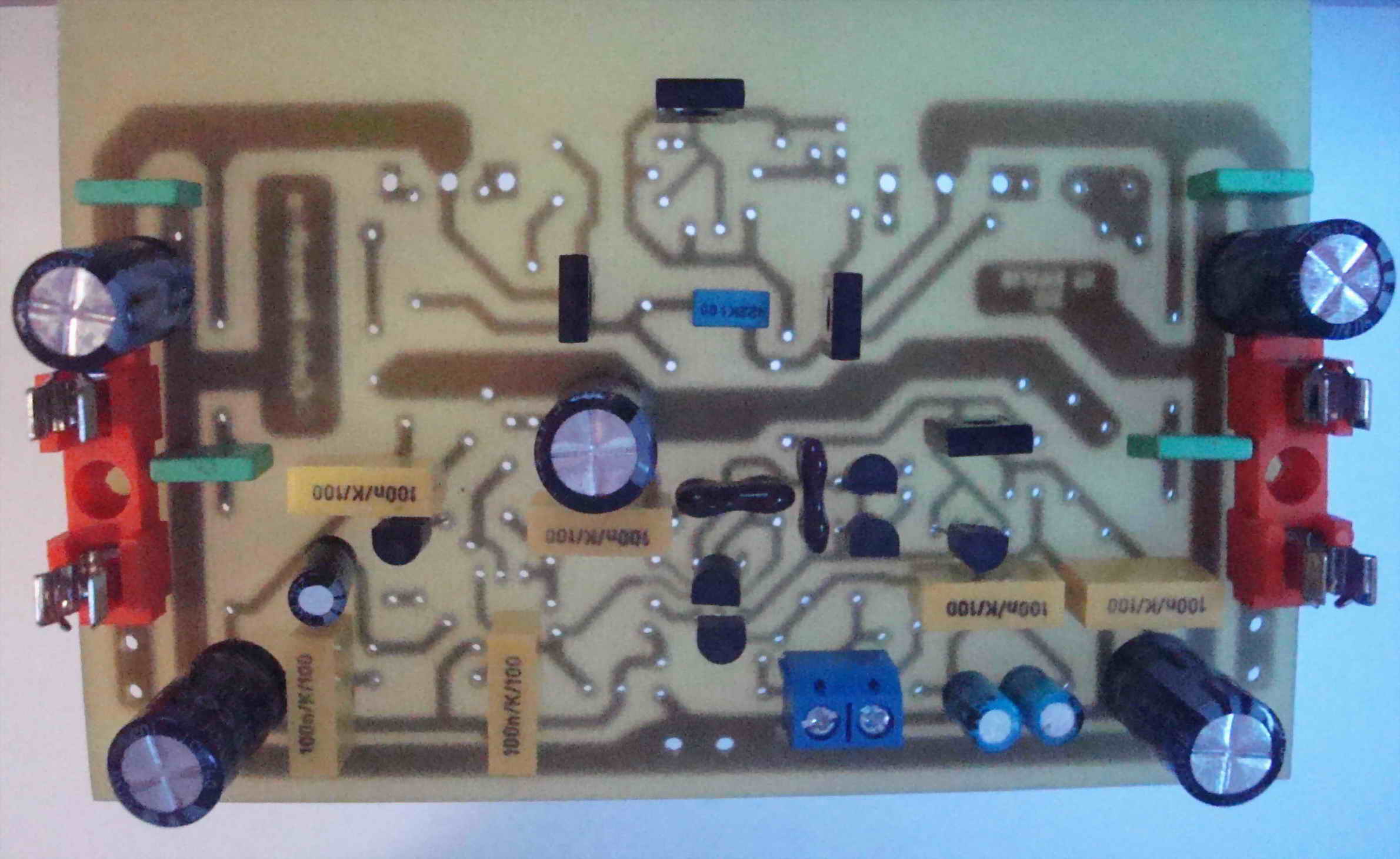

No way to adjust bias means oscilations.
Sorry because you are facing that sittuation.... and a very crazy thing, mutant behavior, one day adjust, other day not... in the early beginning was fine, then one channel became bad, now you have two channels bad....interesting and dramatic progression of troubles.
I was very carefull, since the thread beginning, to say folks the amplifier (original) was very unstable...then i worked hard to overcome this trouble...i made my best.
Then i have assembled several amplifier to be sure they are stable, friends of my also have assembled, no one have faced toubles and i have not faced troubles too.
What can i say?...continue to search, because the circuit you have, and the board you have, is the same i am listening here, daily, and i have bias adjusting and nothing wrong here.
The 470pf capacitor is the main one... without it, or using 47pf instead of 470pf, then you will be living in deep troubles.
Have you changed things?... grounding?... wires?... can you post a brand new picture?
I will look forward for better news from you.
regards,
Carlos
have you tried the capacitor dear Funky2x?
Give a try..... start with 100pF...... if no result, the increase capacitor in steps....for instance, 100, 150, 180,220,270, 330pf.
Solder a piece of wire to the capacitor....the wire free extreme goes soldered in the tranformer center tape ground, the chassis ground.... hold the capacitor using insulating material...then touch the capacitor free lead to all transistor leads...watch the scope sreen or go monitoring your bias voltage....the one is high....use bigger 100 ohms resistance in place if needed...use fan to the heatsinks.
This is a killer method.... this does not work, only, if you have a huge feedback capacitor form the output to input, or other very wrong, feedback type connection....having such kind of mistake, then have to discover, as nothing will stop oscilations before the error be fixed.
Capacitor will work for minor problems only.

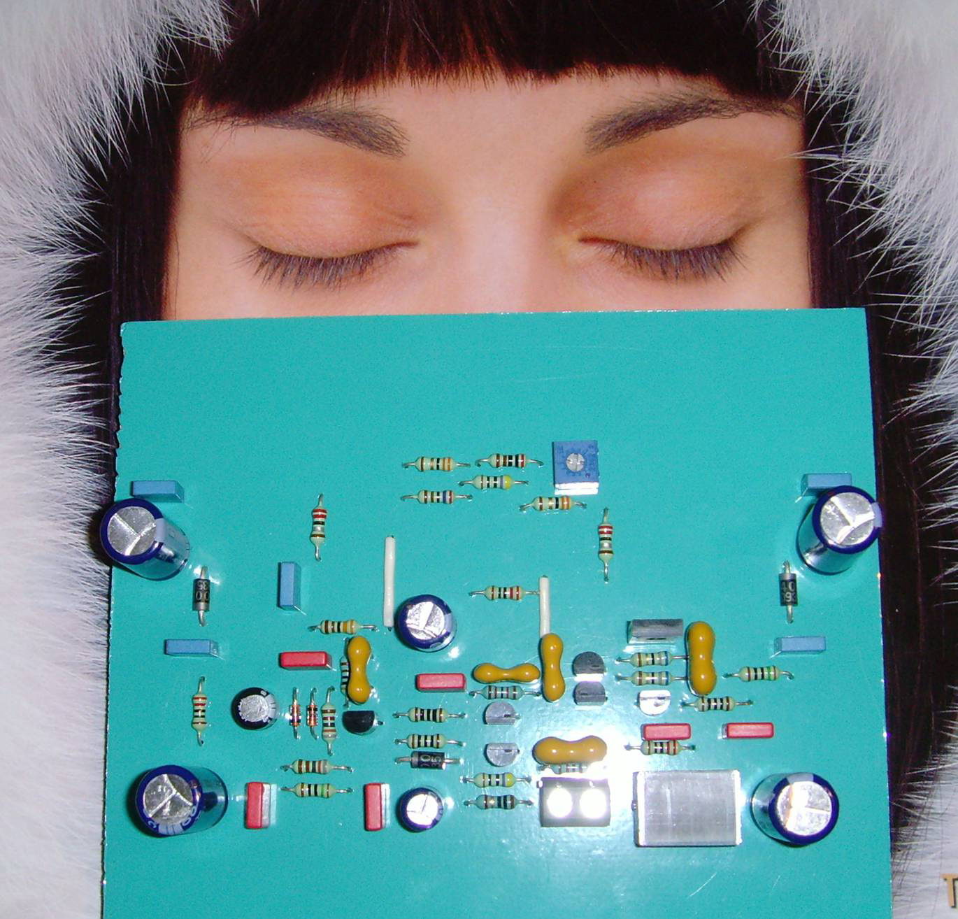

Video attached, a celebration!, the possibility that we may have a lady in our forum:

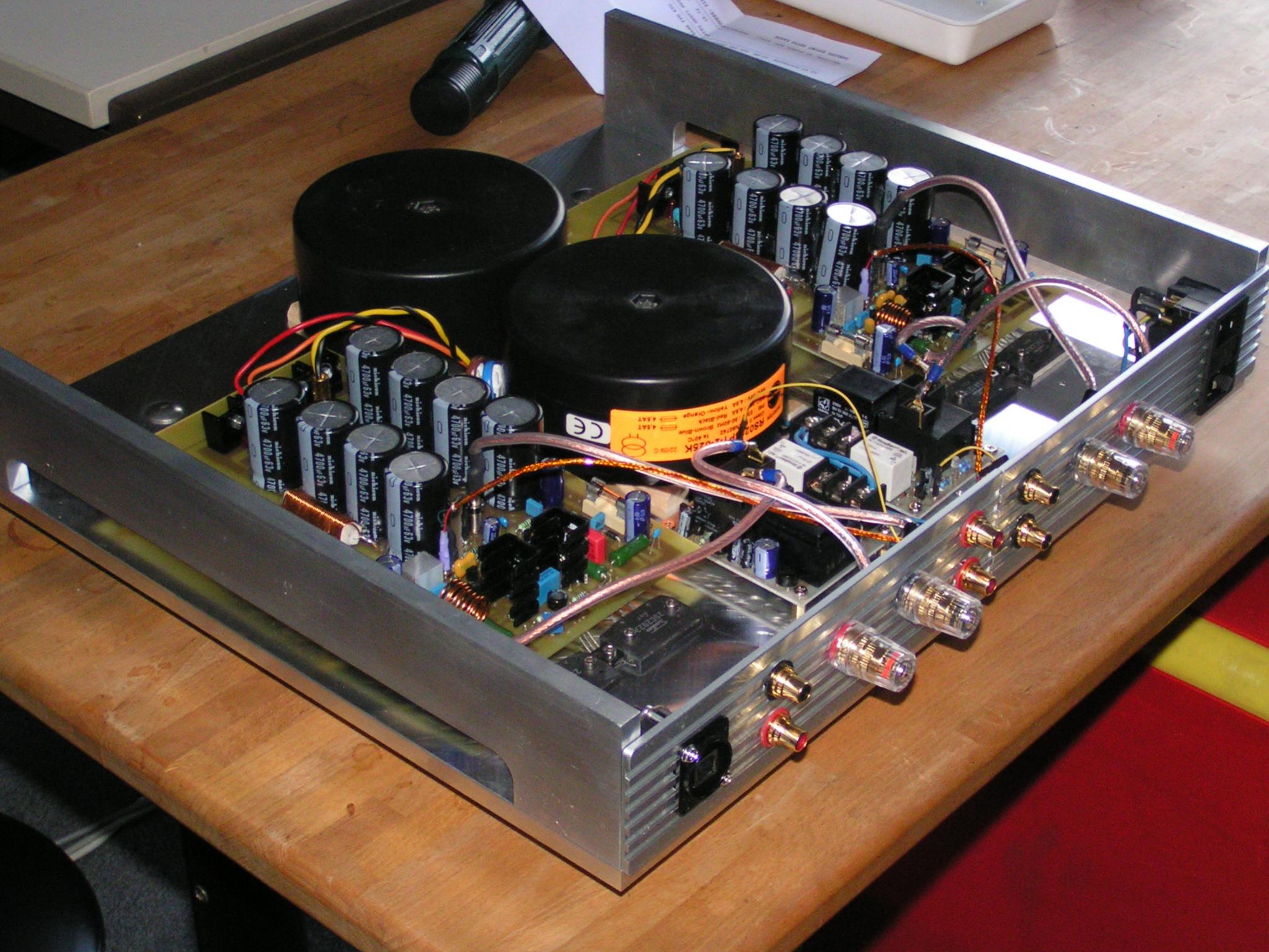

Hey together...
some things are going on .. ;-)
The amp now is playing stable at 7,9V and already prepared for build in some other components (dac, pre-amp). Today i bought a small preamp, very nice whith good harmonic to the Sankens, great sound 🙂
carlos, you must not comment this post, i know you d´ont like me 😀

Hmm, different amp, but I have had to fineadjust bias about once a year
After about 3years it seems more stable
But I expect I will have to adjust again
I dont expect any amps will be 100% on bias
But maybe some really are
But I check at least once a year
I usually know by touching heatsinks, but only possible with monos, ofcourse
But sure, I really hate to touch amps that are working, and fear the worst every time
