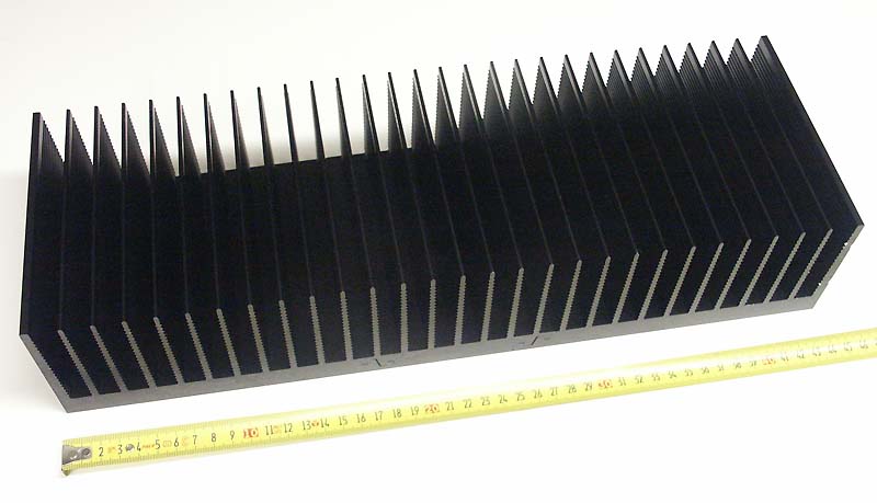

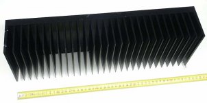

I ordered some nice heatsinks (KL-273/150/sw) from clofis.nl a few months ago. They are really massive and can dissipiate 500 Watt easily. I don't know the exact specs yet, but they are big enough for sure. 😀

Are you sure they can dissapate 500W easily ? cause I have the same heatsink (kl271-150) except the lenght is 300mm and my Aleph5 has to dissapate 150W and those heatsink get mighty hot

Seifert kl271/150
According to the specs, the KL271/150 has a 0.12c/W figure. @ 150W the delta temp should not exceed 18 degrees C or 40C in an average living room.
Would you have the ability to measure the temperature? Can you easaly tuch the heatsinks?
(Typically you can just tuch the heatsinks below 50C)
For the KL273/150 that would mean that you only can disipate around 230W.
Sorry, I forgot to tell you that I have four of them. Two for each mono block, and I used two for my calculations. 🙂
I thought this was the graph posted for the KL273 ?
For 150 mm height the graph translates to :
delta t = 18 >>> ~ 400 watts
delta t = 28 >>> ~ 620 watts
supposing 22C ambient, heatsink temp at 40C or 50 C as posted.
imo, heatsink temp of 40C is a waste of big humps of alloy.
