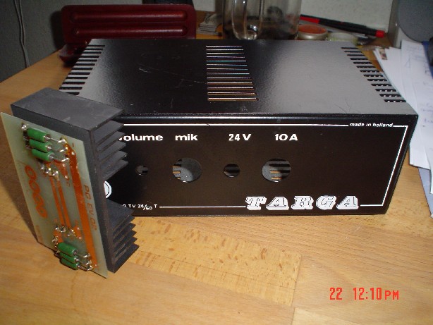

I bought the old stock of the company that produced the sound equipment for the Rijkspolitie Porsches.
TIP's were used for the output stage, i employed a number of the complete output modules as shown on the picture for BMM's
2-30volt/15 amp lab power supply.
I still have loads of these modules and chassis, already thought about using them to build something like Elliot's CM.

I am also working with exisiting parts (transformer,bridge,caps,heatsinks) to try out the Aleph.
I have a preamp without balanced outputs so i would like to try out the Aleph first.

My idea for Elliot's CM would be to use higher value primary and secondary caps and a device that handles a higher current than the 15 amps the 2955/3055 do.
Or, placing several BD139/140- Tip2955/3055 in parallel with the highest caps Mr Elliott advises.
Though it is not a fully regulated powersupply and voltagedrop will be lower, the inrush current for high value capacitors will kill the TIP devices.
I mentioned the heatsink/TIP combo's because i have so many of them.
Placing a number of them in parallel with a bunch of 4700 uF Roederstein's gives maximum ripple reduction, high inrush capability, and i need not spend on it.
The TIP's i have already have 3 parallel 0.33 Ohm emitter resistors on each device, placing 4 of them in parallel would work i think.

Hi jacco, i used 5 * 6800 uf in front and 2 * 6800 after the 2n3055.So far no problems.A 2N3771 (30 A instead of 15 A) would be better though.
