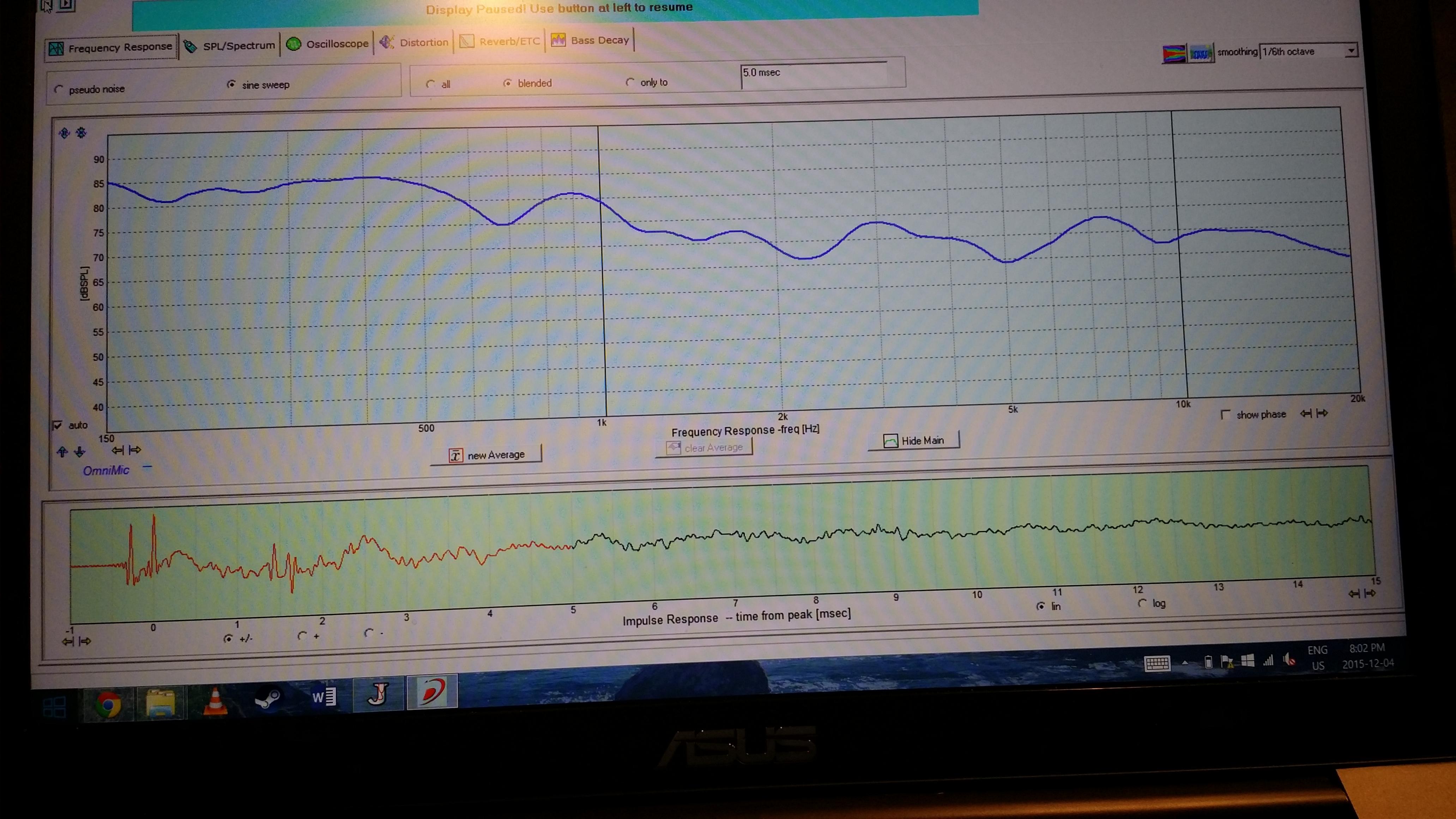

Hello all, been running them for a few weeks now,quite smooth actually.I still need some more room treatments, thinking down the road aquiring a lyngdorf rp1 to smoothen out some room issues. I picked up a Dayton audio omni mic, 1st pic is sine wave at the listening position.

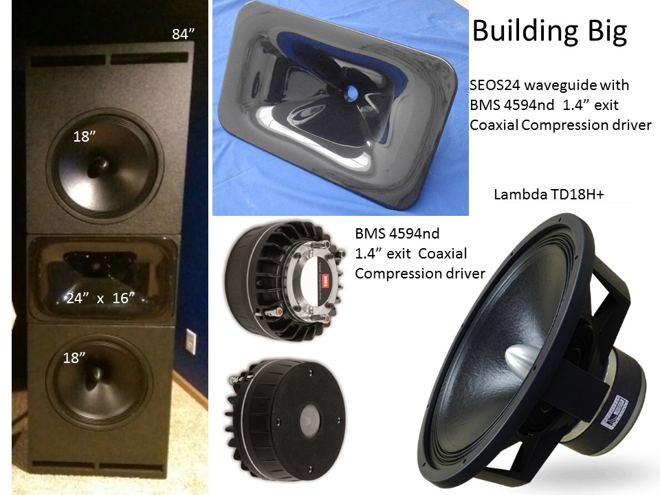

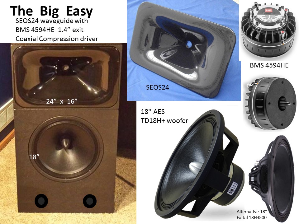

There is a construction thread on the AVSforum using two TD18HE woofers, with a SEOS-24 waveguide attached to the BMS 4594HE coaxial compression driver. Use a MiniDSP 2x4HD crossover with two amplifiers for simple woofer time alignment. The passive crossover for the BMS 4594HE is pretty good.
The MiniDSP can provide room equalization for sealed woofer bass, when using a high wattage amplifier.

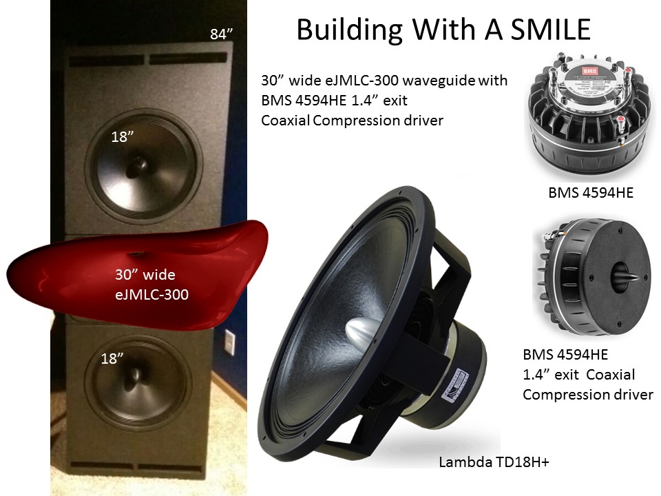

The eJMLC-300 waveguide always makes me SMILE.

--- 1st pic is sine wave at the listening position.
Did you notice the peak before 0 time? It is the actual signal from the speaker, but a reflection is stronger in amplitude and program sets t=0 threre. Move the mic further from walls.
The response is really bass heavy, 150Hz blows 15dB more than 2000Hz. How does it sound? Is this from a single speaker or a pair? Take measurement always from just a single speaker. How about below 150Hz?
