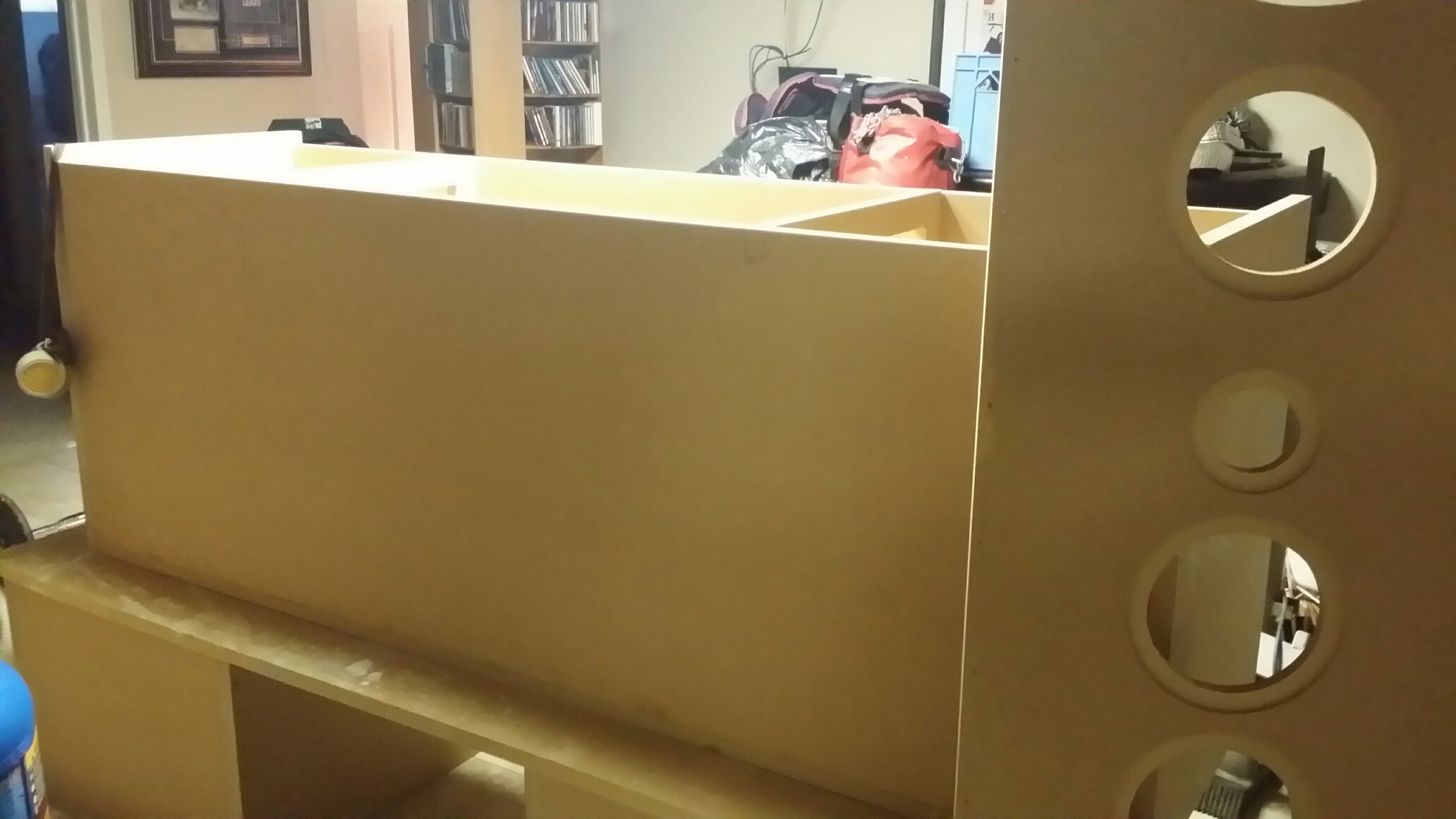

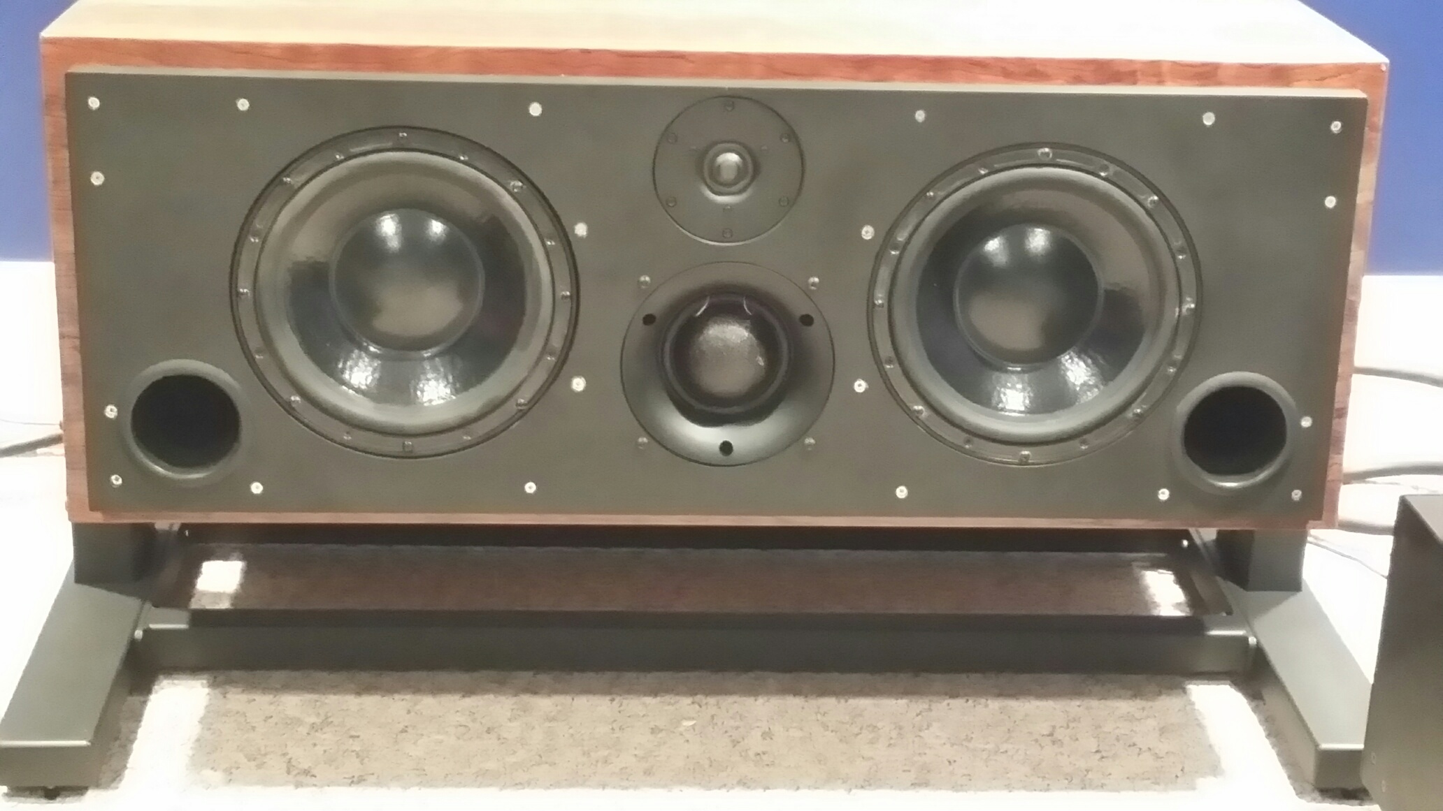

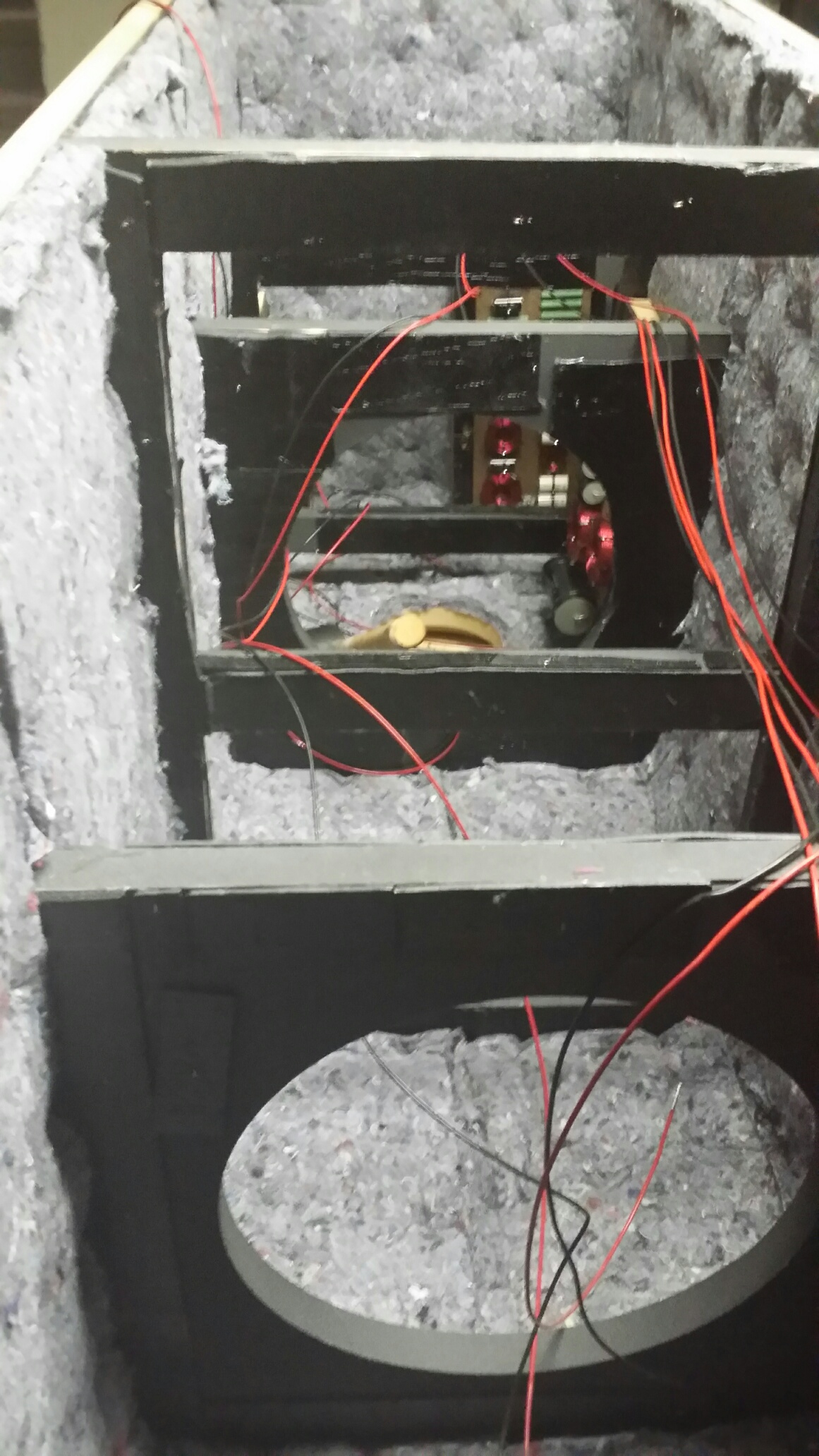

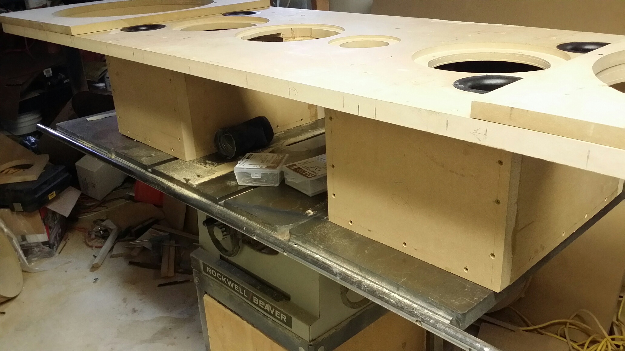

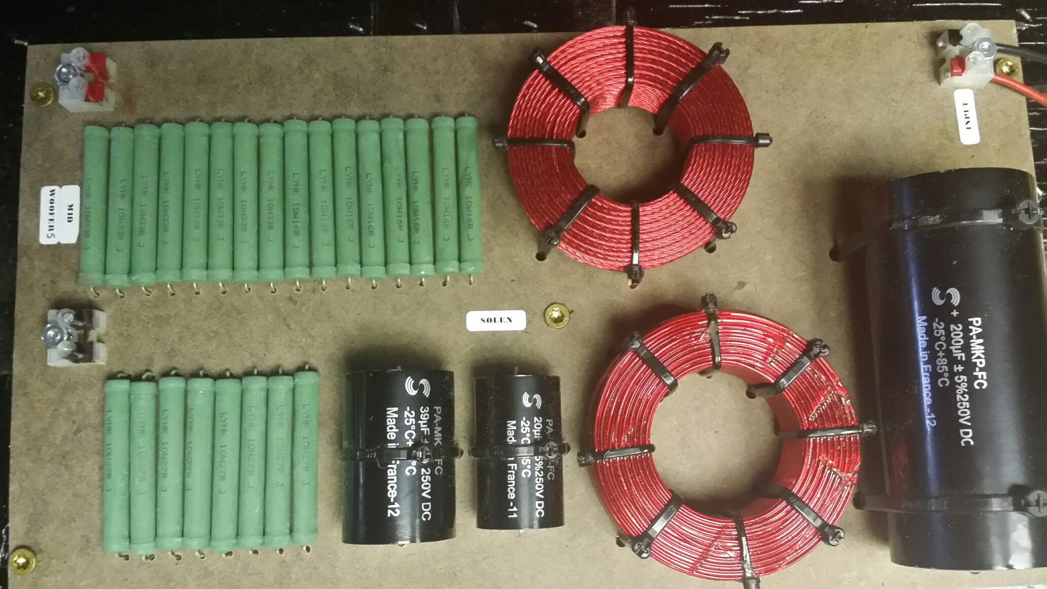

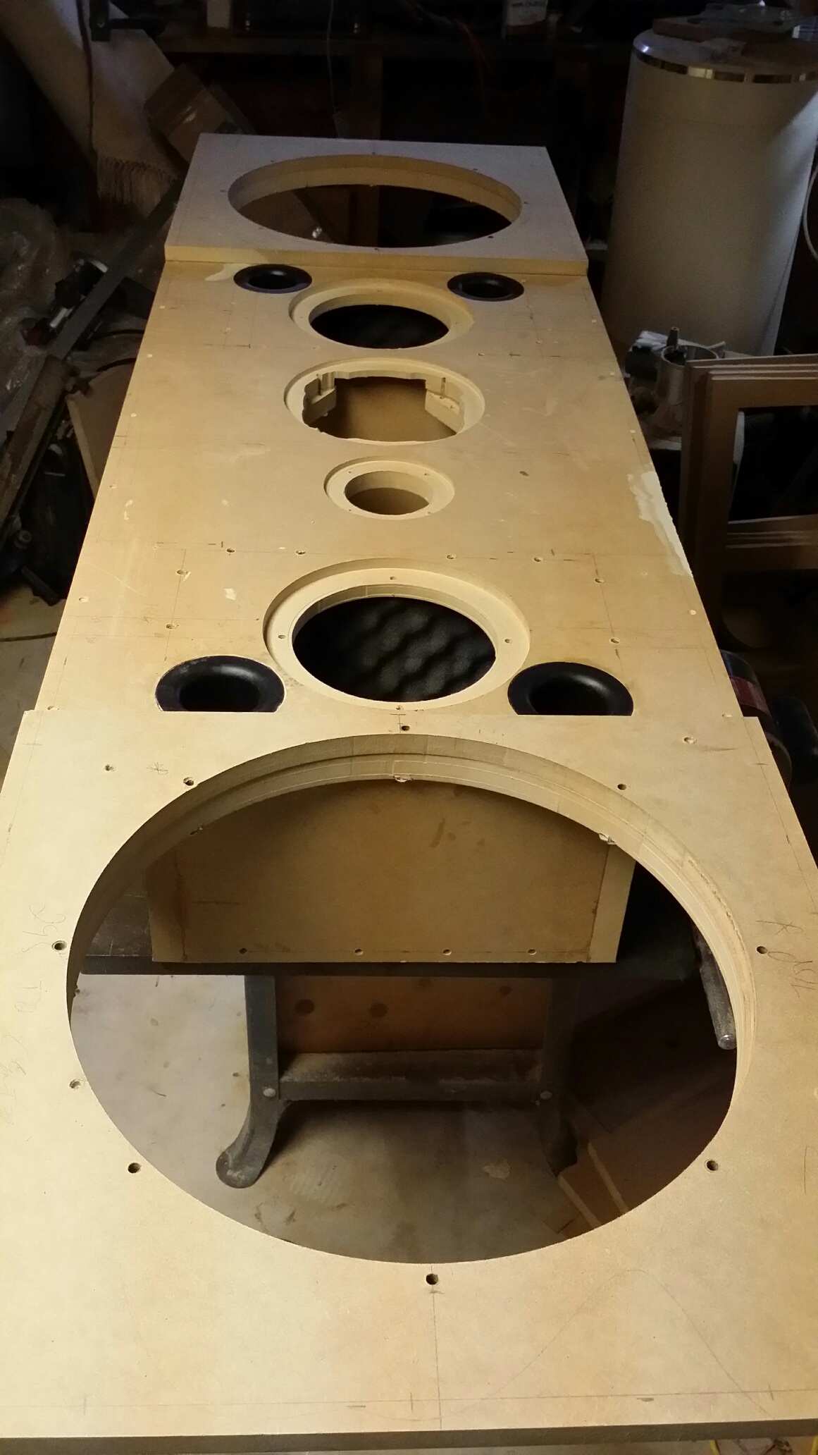

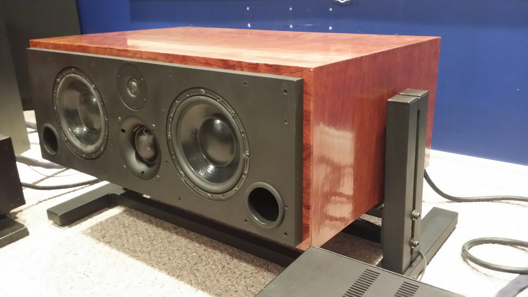

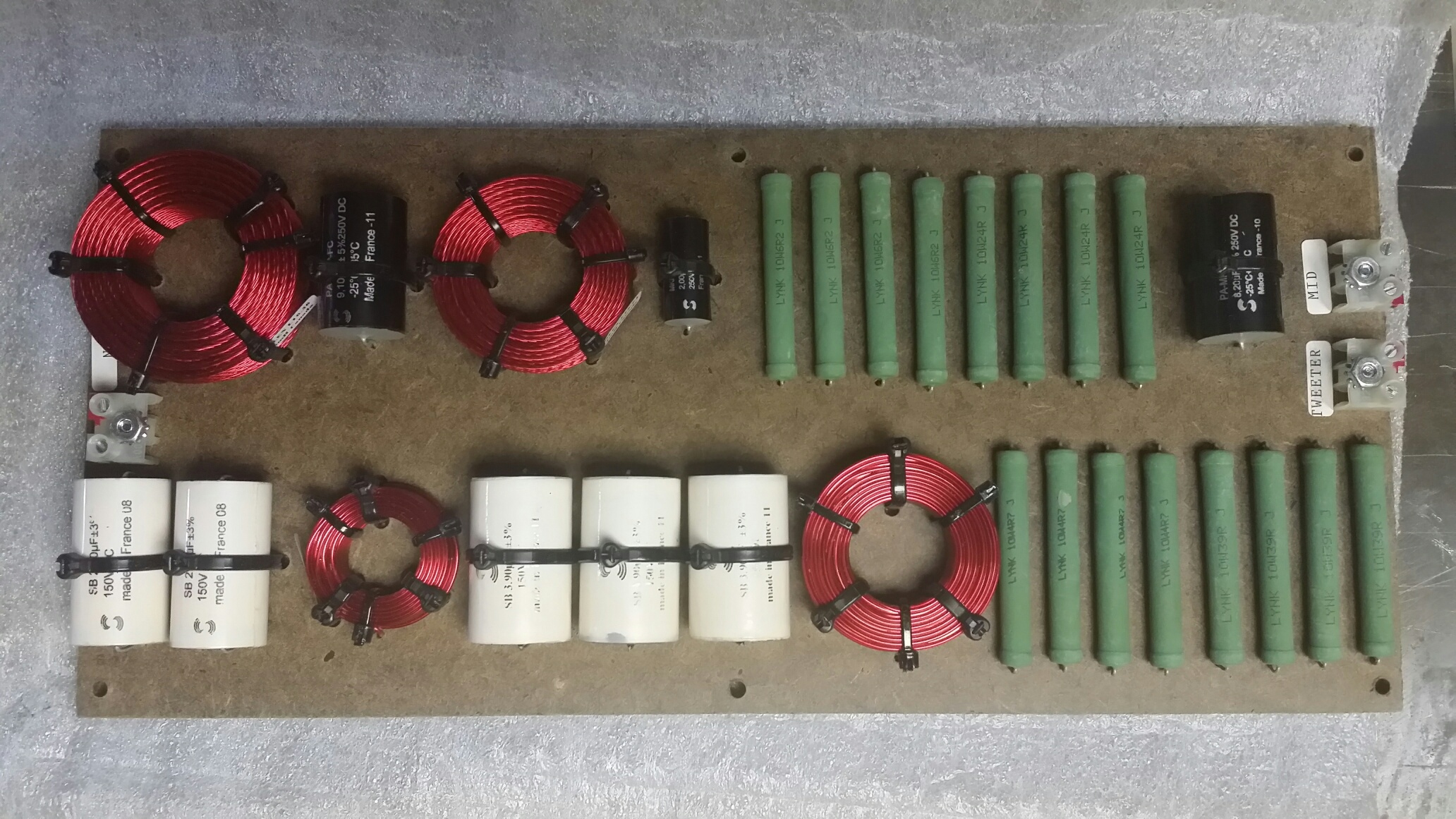

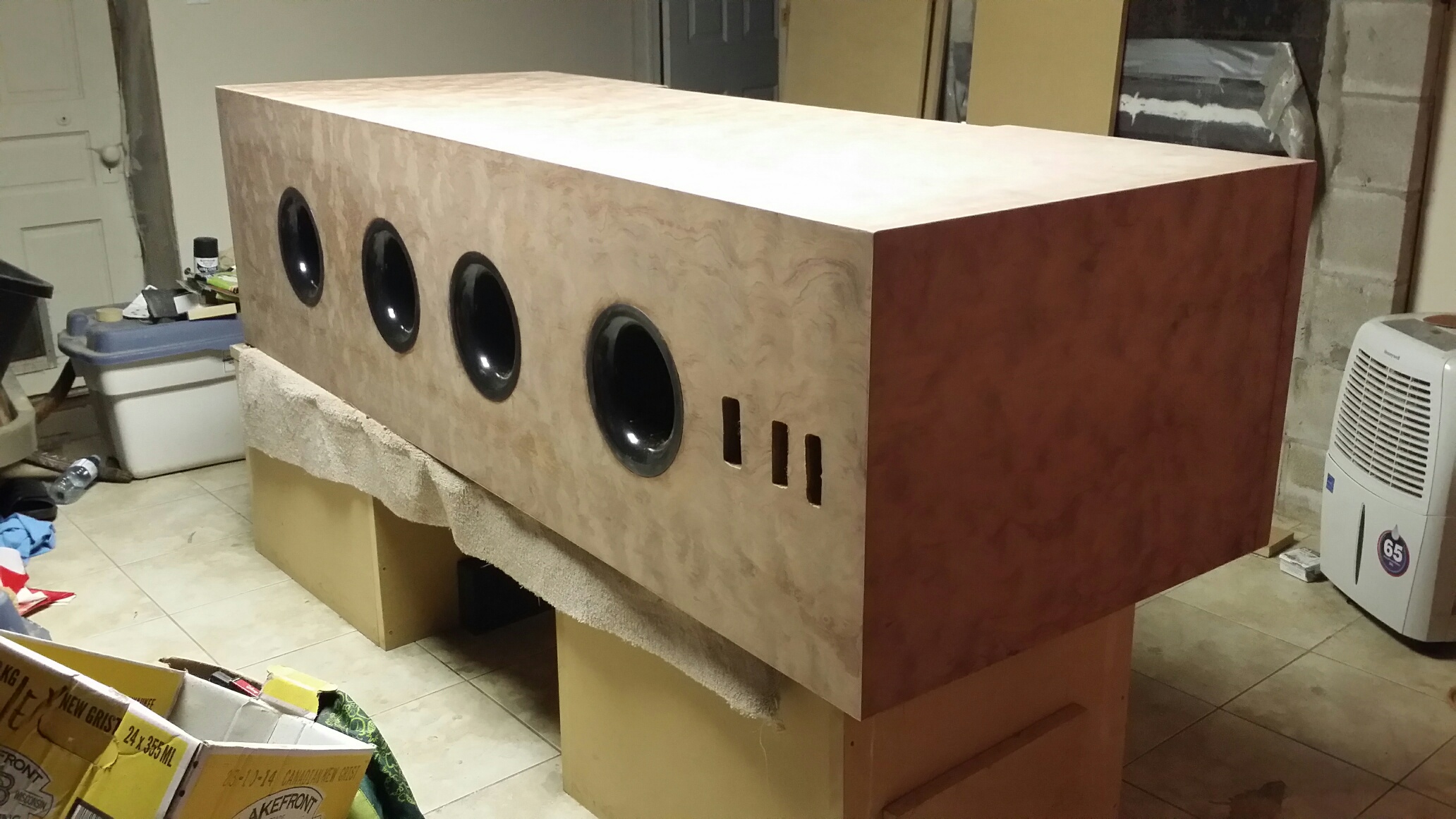

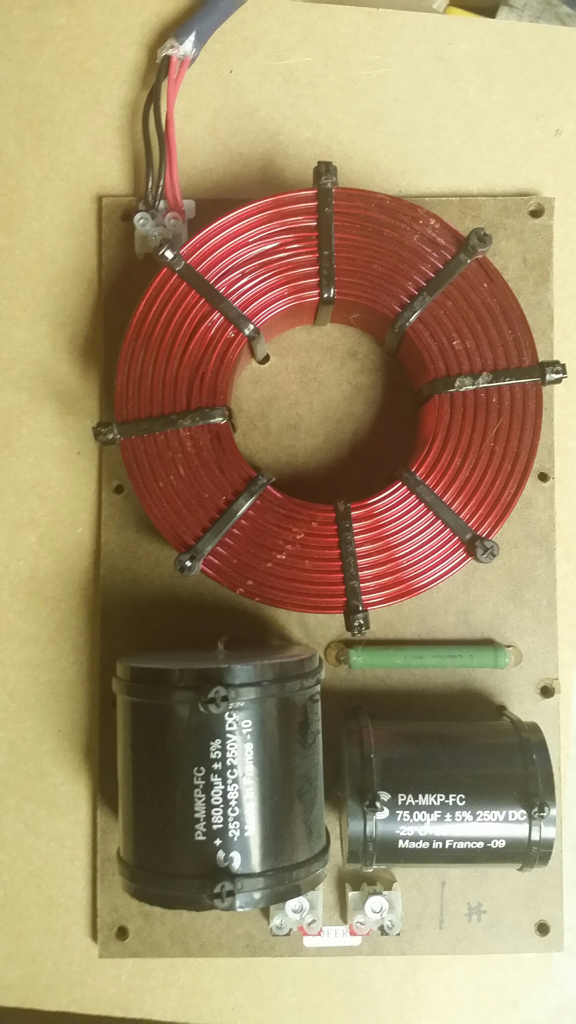

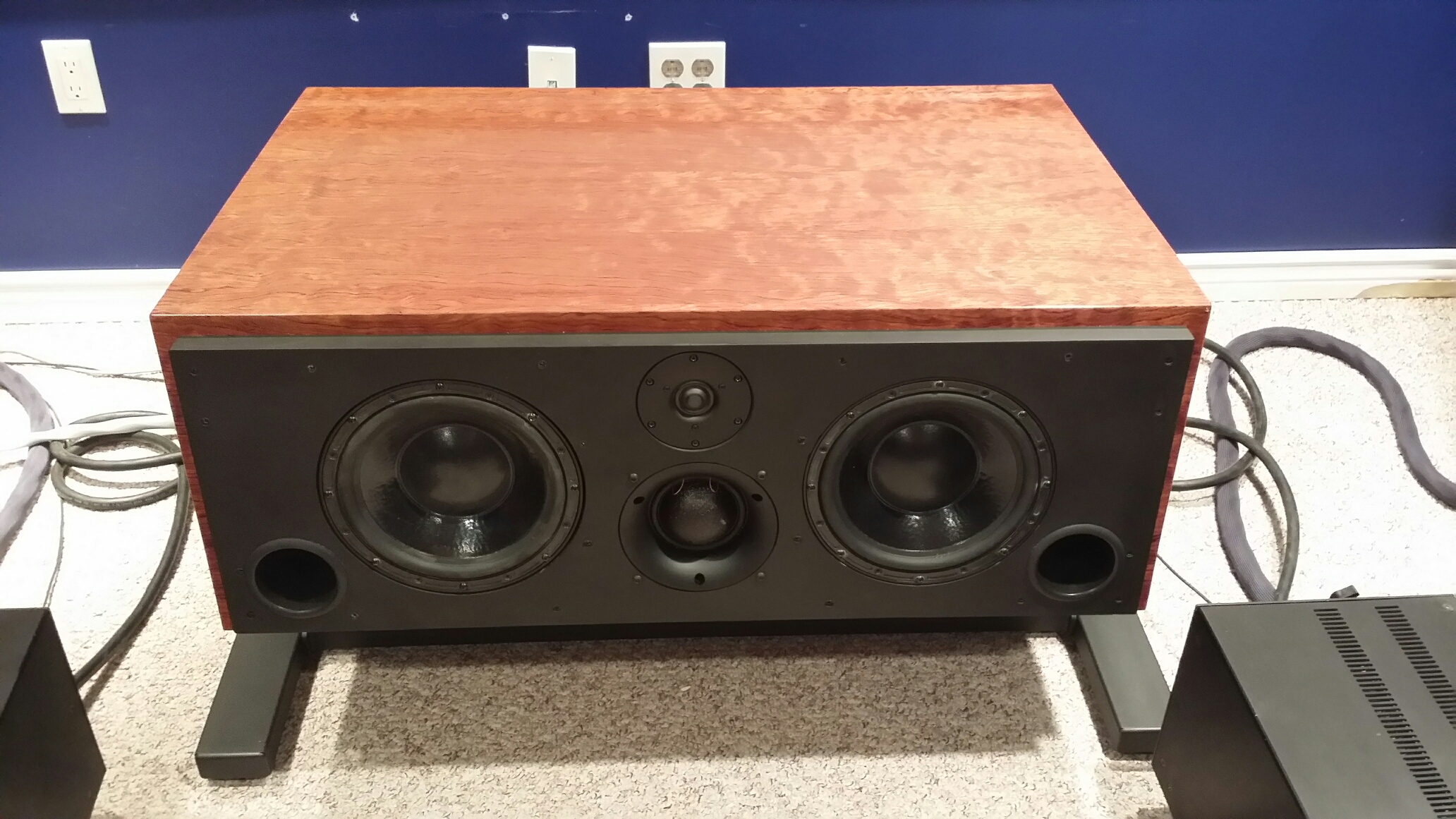

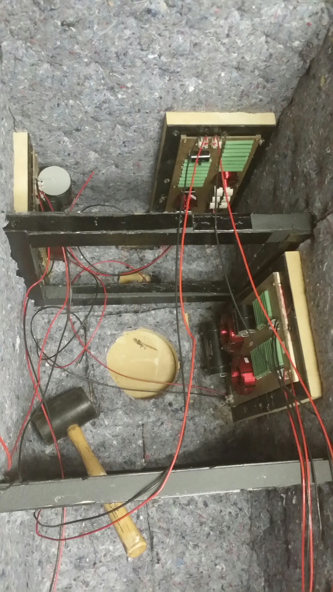

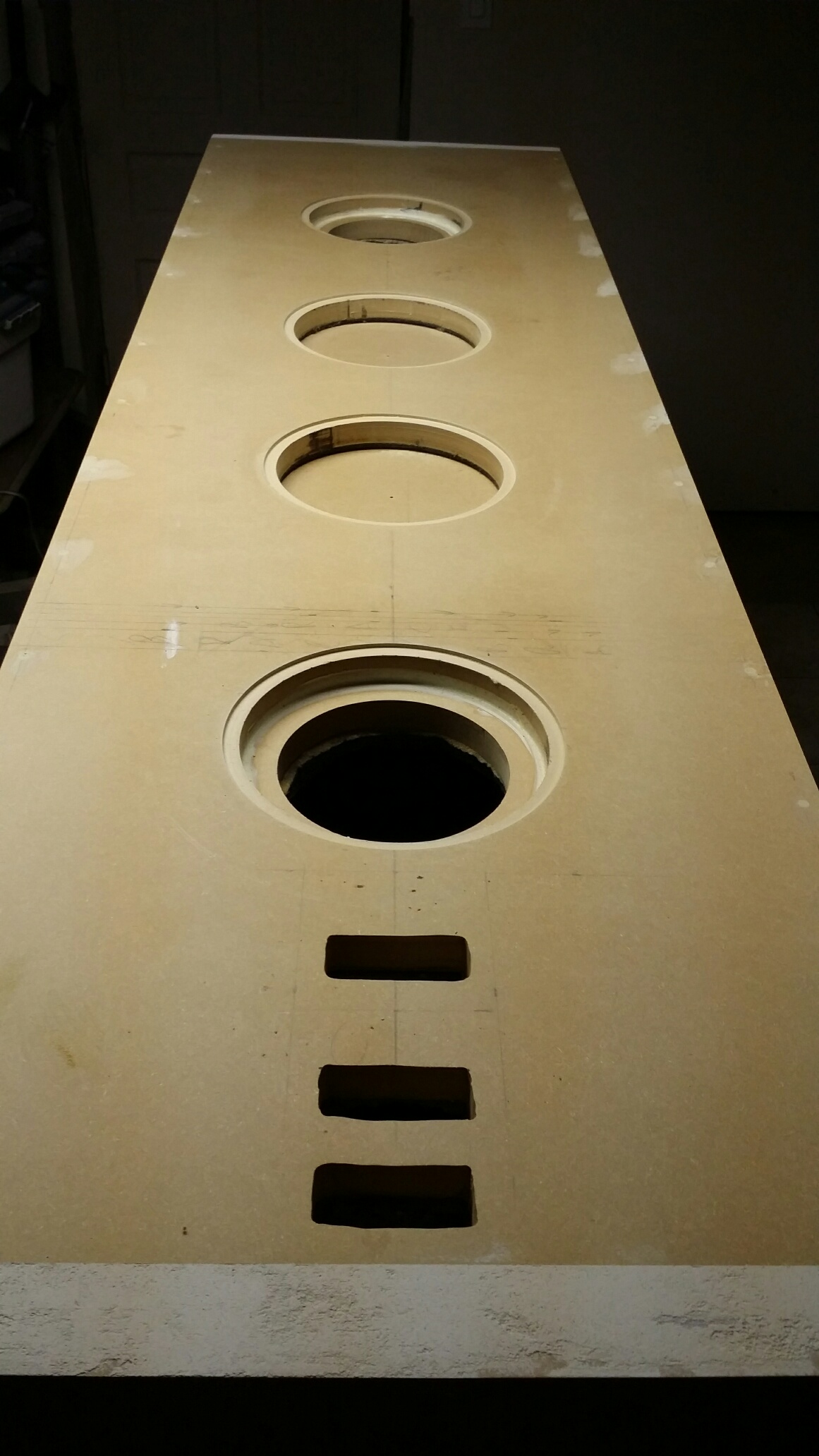

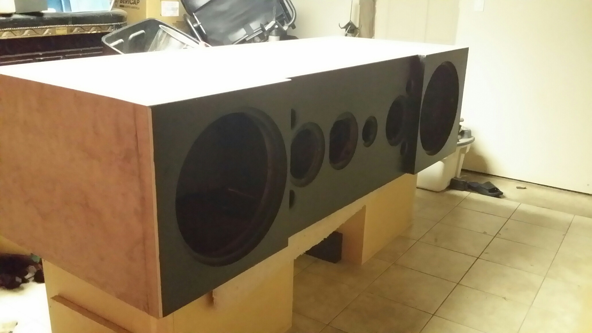

I'm a previous SC V owner, looking for a LITTLE more bottom end... So a friend ,Chris at Solen,and Neil from Wilmslow audio have come up with a 80x22x30 cabinet 4 way design . Twin JBL 2245 18",twin JBL 2118 8", ATC SM 75-150 and a Scanspeak 9900 in a classic Dunlavy design.the journey is well on it's way!

Well it wouldn't have been as time coherent... that was the key point in all of his speakers.
I could understand porting the 15" bass but I wouldn't call this a true tribute.
I'm not trying to put you down or anything, just in the spirit of Dunlavy I'd have opted for time coherency.
Not even implying that you couldn't be on your way to an awesome speaker here...
Just not one that John Dunlavy would have chosen to design or build...
Send me a PM with your email address and I'll send you a copy of John Dunlavy's paper on "Loudspeaker Accuracy" to get an insight of his design philosophy's.

Those ports will add 10ms of group delay. Not sure why ports are needed on the mids - a sealed or aperiodic sealed TL is best here to reduce GD and give best time alignment. Wesayso has a point about Dunlavy, if anything, time coherency and great step response is what his designs were known for.
The 2118 requires a port....maybe if his design was ported...it wouldn't have been so bass shy

Not trying to slam you here, but honestly the introduction of porting goes against all Dunlavy stood for. Sure, you may end up with a great speaker but one that should not be lumped together with Dunlavy designs. FWIW I would recommend you tune them low and then add a brickwall filter to make the best of what you have, so that the worse of the group delay is kept below where most musical content lies.

Dunlavys had the ability to excite room modes, ie "bass.". They could do it better than most, because they had big woofers in closed boxes. The problem is, in the bass the speakers play a bit part. It's all about room modes, and a stereo "full range" pair of speakers offers no control of room modes. That's why a truly high fidelity system requires multiple subwoofers.
The subject speaker is nothing like a Dunlavy design. Note that the tweeter isn't recessed with stepped felt. The post makes no mention of 1st order acoustic crossovers, which are at any rate impossible with a vented midbass. That could be a good thing. Dunlavys were IMO the world's biggest headphones. Move your head and the magic goes away. A good reason to design for even power response and not just flat axial response

IMHO, if you're unhappy with the bass response of Dunlavys speakers, the optimum solution would be the addition of a subwoofer array. Here's why:
Dunlavys used first order crossovers. In order to use these filters, he had to use drivers with very wide bandwidth. For instance, a woofer with a first order lowpass at 125hz will only be down 12dB in the octave where the midrange is playing. IE, due to the use of first order filters, the smoothness and bandwidth of all drivers has to be exceptionally good. Due to this fact, Dunlavy tended to use drivers that weren't terribly efficient. (Heavy damped cones and low efficiency go hand in hand.)
I've got mad respect for Dunlavy, and improving on his designs will not be easy. You can't just throw a bunch of drivers in a box and get the same results; everything he did was for a reason.

I think the OP's project here looks awesome, but I do agree that the design is not any closer to a Dunlavy than it is to any number of extreme floor-standers. I like your mid-dome and tweeter choices and not all that familiar with the rest other than knowing most would agree those JBL drivers are very good.

Thanks too all for the input, I come from the belief of big name big $$$ speakers are gospel of audio,then discovering that they use cheap drivers for example the Wilson Maxx's I sold to venture down this diy highway.my recent first completion of a passive atc c6 clone center strengthens my passion for a large floor sander.I agree with the poster about room nodes...I sure had them.and to the poster regarding a 4 way active...I totally agree...it would be the the ultimate way to go. I used to run in competition car audio (which has put a dent in my home audio projects)..
In the end, I'll have a fairly efficient tower, able to run with a large mono....to any level my ears can handle.

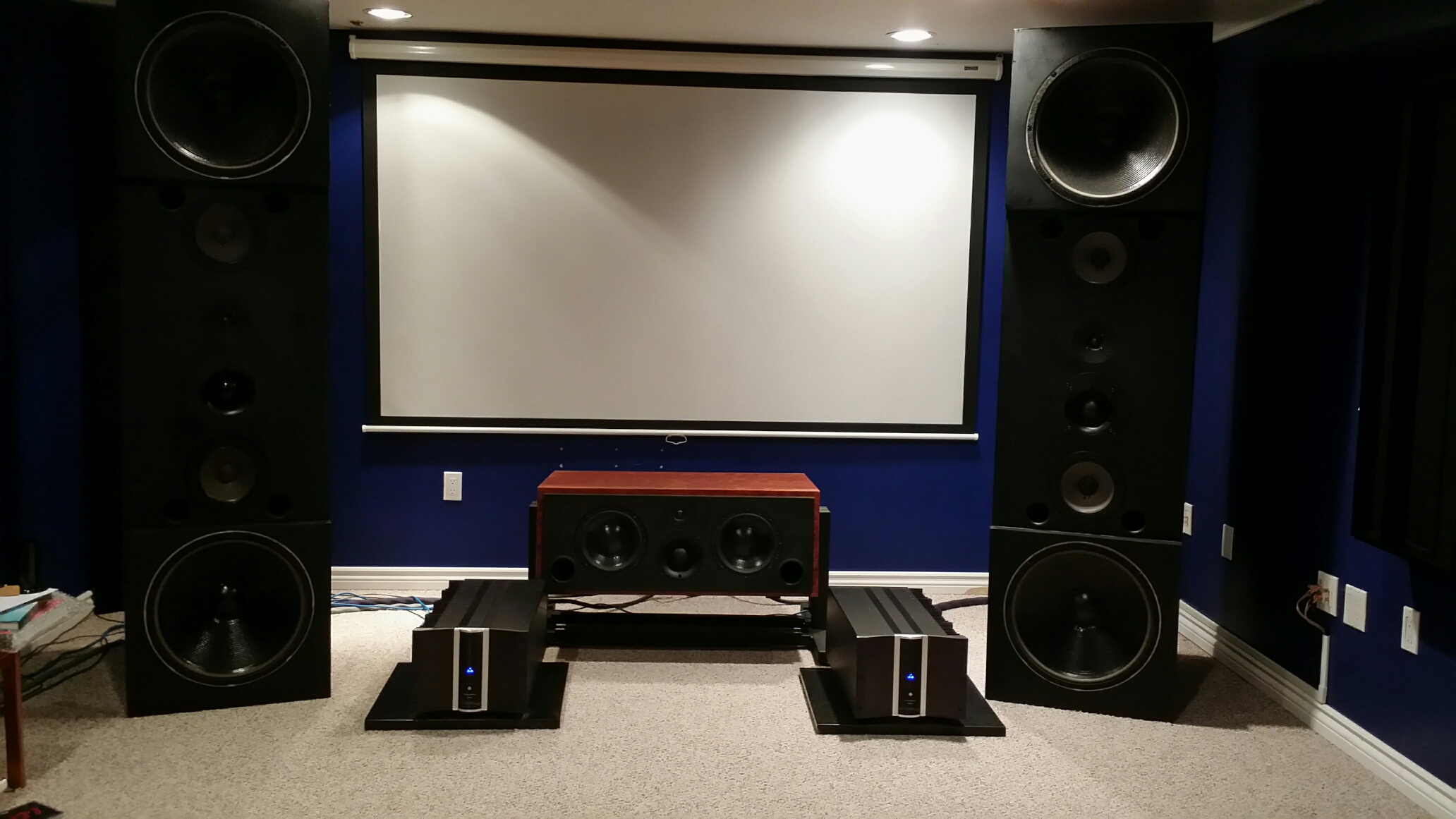

Finally done my ATC C6 center channel and my tower project.11 months for 3 speakers start to finish. A very cool first attempt at DIY IMHO, thanks to all for input thus far

I'm sorry to say that i just discovered why you think SC-V have no bass!?, Car audio competitions . Those guys are sooooooooo into fake, over exagerated low quality bass... This being said, i am working on a similar project, using dual JBL 2235's in a wmtmw config in ported design . I will follow your project for sure!.Thanks too all for the input, I come from the belief of big name big $$$ speakers are gospel of audio,then discovering that they use cheap drivers for example the Wilson Maxx's I sold to venture down this diy highway.my recent first completion of a passive atc c6 clone center strengthens my passion for a large floor sander.I agree with the poster about room nodes...I sure had them.and to the poster regarding a 4 way active...I totally agree...it would be the the ultimate way to go. I used to run in competition car audio (which has put a dent in my home audio projects)..
