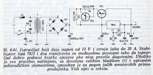

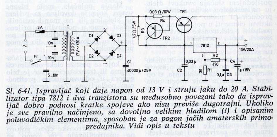

Here is the scan of the original schematic:
TRANSFORMER POWER~400W(PRIMARY)
SECONDARY =17 VOLTS/~20A
TR1=2N5302
TR2=BD136
The circuit has over current protection (from short circuit) if time interval is not too long!
FINALLY:
My recommendation is that you can add more parallel transistors in place of 2N5302(if you can't find this) with other equivalent replacement or for example:TIP2955 or similar but PNP type plus adding extra ceramic resistors of 0.1 Ohm/5watts on each emitter of the transistors which should be connected in place of TR1.
Author of this book also mentioned that we must put TR1 of a big heat sink and to use like upper side of the Box.
This is tested by many including myself and works.
So you must find other transformer or if you are able rewound the secondary to 17- 18 Volts.
I have rewind a lot's of transformers all types of cores even welded ones, and toroidal.
I wound my 2000VA toroidal core with naked hands end secondary wire I put is 2.4mm Cu lack diameter!
If I can help you more tell me how?

HERE FOR THOSE WHO ARE LAZY TO CALCULATE BY HAND(OLD SCHOOL) METHOD HERE IS THE SIMPLY STUPID METHOD TO CALCULATE VALUES OF THE VOLTAGE DIVIDER (RESISTORS R2/R1) USED IN MY ORIGINALLY PREVIOUSLY POSTED SCHEMATIC DIAGRAM FROM THE "Radio prirucnik za amatere i tehnicare Dr. Bozo Metzger(YU2BR)"-ONE OF THE BEST HAM BOOK, MY BIG RESPECT TO YU2BR.
VISIT THIS LINK AND JUST PUT VOLTAGE REFERENCE WHICH IN OUR CASE IS 12 VOLTS(LM7812), PUT THE (DESIRED OUTPUT VOLTAGE WHICH YOU WOULD LIKE TO HAVE @ OUTPUT), THAN PUT VALUE FOR R2 WHICH IS 470 OHM OR 0.47KOHM, AND THAN PRESS CALCULATE TO GET R1 VALUE.
IF YOU LIKE TO CHANGE THE PRESENT OUTPUT VOLTAGE WHICH NOW IS AROUND 13VDC, WITH ORIGINALLY POSTED VALUES FOR R1/R2, THAN PUT THE NEW DESIRED OUTPUT VOLTAGE (VO), FOR EXAMPLE 14 V AND LEAVE R2 VALUE LIKE IT IS=470 =0.47KOHM, AND PRESS CALCULATE TO GET VALUE FOR THE R1.
VERY EASY, ISN'T IT???
http://www.daycounter.com/Calculators/Voltage-Regulator-Resistor-Divider-Calculator.phtml
🙂 TELL ME IF I CAN FURTHER HELP YOU?

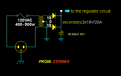

Bad news. The transformer puts out 44v. Guess my memory is playing tricks on me. It has a center tapped secondary, so I can get 22v but, that would cut the current capability in half also.
Back to start again. Although, I might consider pulling some windings off, since I have no other use for this transformer.
The other two are too valuable as transformers for gain clones.
David
You are wright.
Try to find other 400 to 500w transformer with 18 volts secondary, or you can also use transformer with dual secondary like 2x 9(9-0-9) volts with BRIDGE RECTIFIER. with wire for about 20 A because you do not need more 20A.
ALSO YOU CAN USE 18-0-18 VOLTS TRANSFORMER WITH CENTER TAP BUT IN THIS CASE YOU MUST TO USE "COMMON CATHODE RECTIFIER" -TWO DIODES WITH CATHODE CONNECTED POINT" TO GET "+" VOLTAGE AND "-" VOLTAGE WILL BE THE CENTER TAP OF THE TRANSFORMER.
HERE IS THE SCHEMATIC: 🙂
