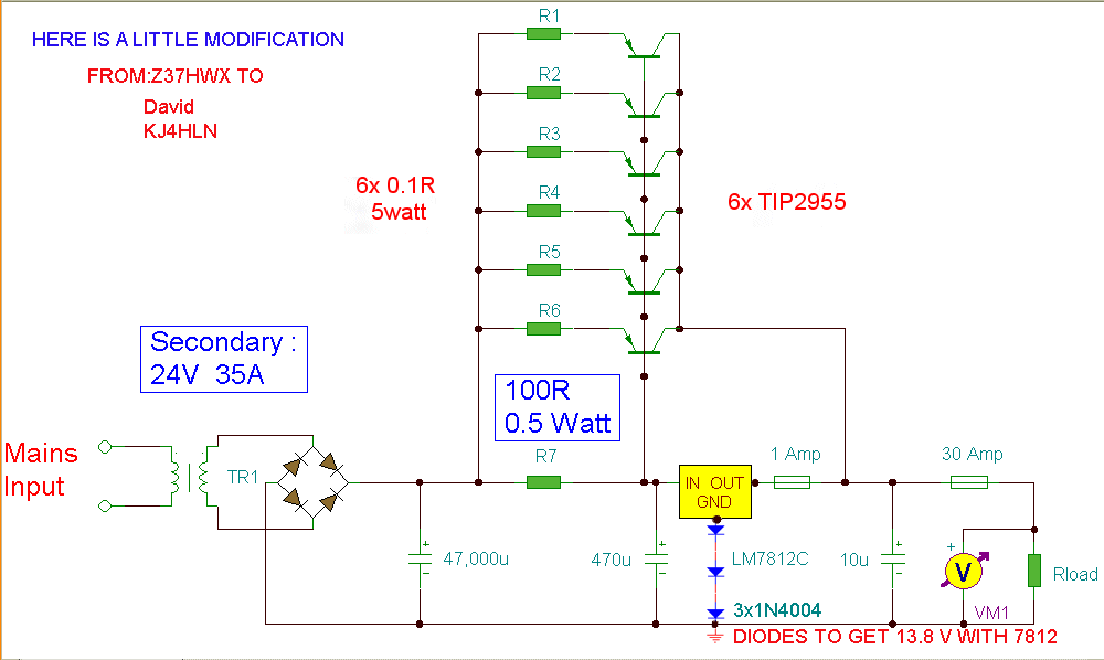

The problem is that with 24V AC input and 13.8V output 60% of the power is burnt as heat (300W) and only 40% is delivered to the load (200W). Thus, one 500VA transformer can only provide 13.8V 14.5A continuously. Another disadvantage is that drawing 200W from the supply results in 500W being drawn from the wall outlet (and paid).
This is relly bad performance, and it's not even accounting for the fact that VA ratings are usually given for a resistive load, but this time the load is a rectifier. For a given output power, a rectifier produces a RMS current through the windings tipically 1.5 to 2 times higher than a resistive load resulting in a proportionally lower VA rating.
In other words, expect everything to be already close to melting at 13.8V 10A output (20A for 2 transformers). Be careful since toroids may take one hour or more to reach steady state temperature, which may be too high although they may seem cool after 5 or 10 minutes.

Here is the scan of the original schematic:
TRANSFORMER POWER~400W(PRIMARY)
SECONDARY =17 VOLTS/~20A
TR1=2N5302
TR2=BD136
The circuit has over current protection (from short circuit) if time interval is not too long!
FINALLY:
My recommendation is that you can add more parallel transistors in place of 2N5302(if you can't find this) with other equivalent replacement or for example:TIP2955 or similar but PNP type plus adding extra ceramic resistors of 0.1 Ohm/5watts on each emitter of the transistors which should be connected in place of TR1.
Author of this book also mentioned that we must put TR1 of a big heat sink and to use like upper side of the Box.
This is tested by many including myself and works.
So you must find other transformer or if you are able rewound the secondary to 17- 18 Volts.

With Adjustable regulators such as the LM317,the resistors are used to set the output voltage.
The same principal works for fixed regulators,such as the 7812. The output voltage is in relation to the ground pin on the regulator. So,if you 'lift' the ground pin above circuit ground,you can kind of trick the regulator into outputting a higher voltage,in relation to circuit ground.
Adding two diodes in the ground pin of the regulator will boost the output by approx ~1.4V (Diodes drop approx. ~0.7V each) up to ~13.4V
It's a kind of neat little trick to get different voltages from fixed regulators. 😉

Try to find other 400 to 500w transformer with 18 volts secondary, or you can also use transformer with dual secondary like 2x 9(9-0-9) volts with BRIDGE RECTIFIER. with wire for about 20 A because you do not need more 20A.
ALSO YOU CAN USE 18-0-18 VOLTS TRANSFORMER WITH CENTER TAP BUT IN THIS CASE YOU MUST TO USE "COMMON CATHODE RECTIFIER" -TWO DIODES WITH CATHODE CONNECTED POINT" TO GET "+" VOLTAGE AND "-" VOLTAGE WILL BE THE CENTER TAP OF THE TRANSFORMER.
HERE IS THE SCHEMATIC: 🙂
