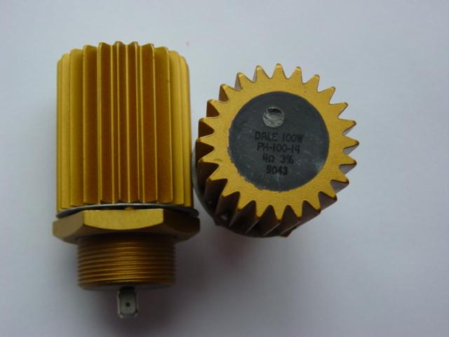

I have a very large heatsink with 8x 4 ohm 100 watt Dale aluminum resistors mounted on it. I have it wired to provide dual 8 ohms at 200 watts, 4 ohms at 400 watts. and i could wire it for 8 ohms at 800 watts.
So far i have got the heatsink a little bit warm. not enough to even be considered hot. But i am concerned. I have done some "Full pulls" at 1000+ watts into 8 ohms with just 2 of those resistors rated for 200 watts. The "pulls" are short in duration. not more then a few seconds each but i am so far over the rated power for the resistors that i fear damaging them.
I wish i had purchased at least a second one of these heatsink assemblies.

My dummy load have 32pcs. Dale 50W/3,9 Ohm,that is :
4 x 400W/8 Ohm
2 x 800W/4 Ohm(w.bridges)
1 x 1600W/2 ohm(w.Bridges)
I fired up one of my Crests one ch( 2 Ohm ) full power, about one hour without damage!
Only thing is heat2.
