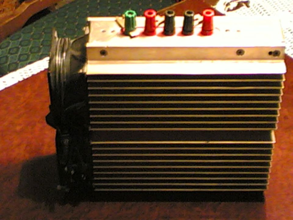

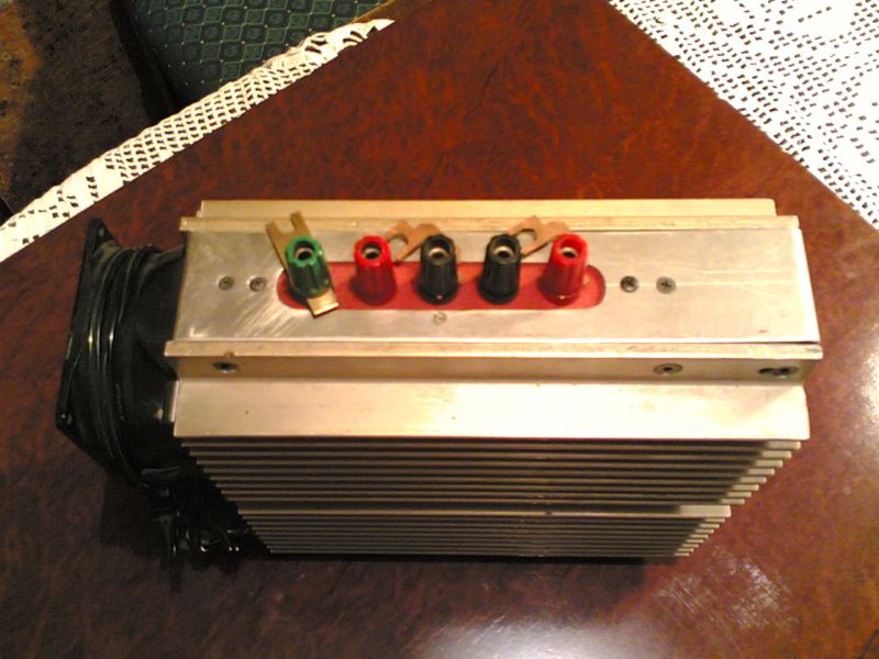

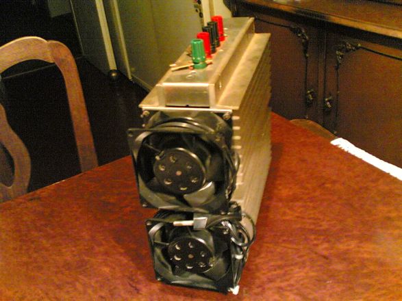

Hi Chris
This is a dummy load that i have invented by allone because my demands was the absolute absence of any inductance. Yes, indeed it is clear resistive by 99,9%. Also it is a double dummy load in the same package. Each one it is 8Ù and 2000W, thus by paralleling the outgoing cables we can obtain a 4Ù load also. Its length it is 0,5meters. By measurements, due to large heatsink sandwitch it touch the 50deg C as much when i check the output of an amplifier at 150W for half an hour continuously. Thus its ohmic value it shift at 8,05Ù after it pass this time. Very good stability. For further informations at your disposal.
Fotios

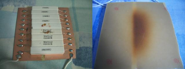

I have a legitimate query. From as much posts i have read in this thread no one takes into account that for an accurate measurement of the output of an amplifier, the dummy load must be clear resistive. Capacitances or inductances are undesirable components in the load and the measurements that we take finally are unreliable. These all paralleled ceramic resistors which i see in the photos composed from a wirewound turned around a ceramic rod before cemented in their ceramic or marble or heatsink package. Thus they are also inductive loads. Also the method of using a speaker it is the worst case. According to my knoweledge all of them. Thus a better solution from the wirewound resistors it is the series/parallel connection of many metal film (they offered also in 3W power) resistors which don't present any inductance, dipped in a vessel filled up with oil.
I used this method before the load presented in the photo of my previous post.
Fotios
