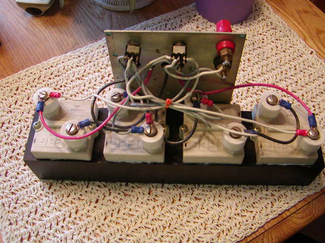

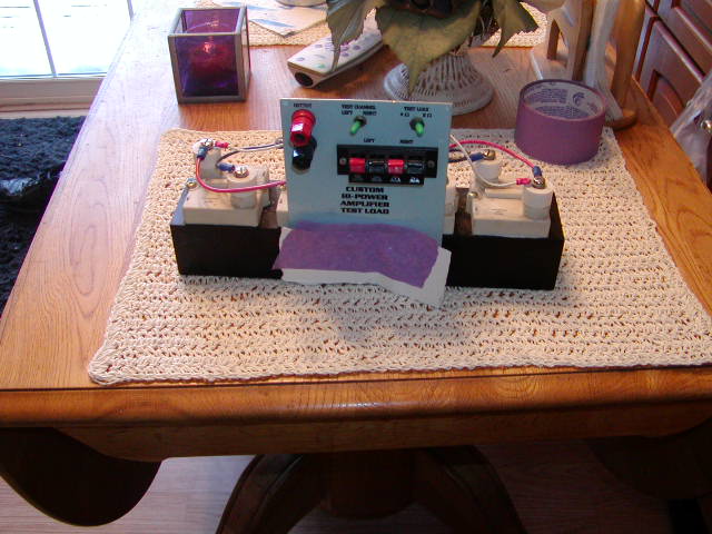

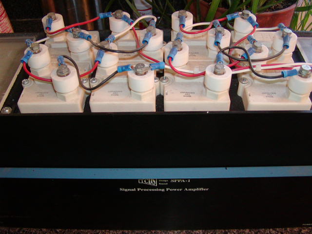

4 EBG 600 watt load resistors per channel in a series parallel for a 4 ohm load per channel. The unit can also be used as one massive 8 ohm load if needed for large bridge amplifiers. It is cooled by 3) 5" Dayton 70 CFM fans and never gets warm no matter what.

UXP SERIES Power Resistor
EBG has developed a small unique package (60 mm x 65 mm) that can handle up to 960 Watts continuously when mounted to a heatsink with a bottom case temperature of 70°C at full power. They have 3 different models available; 300W, 600W, and 800W, all using the same unique packaging. The catalog power ratings are all shown for an 85°C bottom case temp, however if you are able to keep the bottom case at 70°C you can acheive a 20% increase in the continuous power capability. This resistor was designed for the high-speed trains in Europe, but is one of the fastest growing lines here in North America. This patented package offers electrical advantages as well as physical advantages. The ohmic value range begins at 0.5R up to 1M. The dielectric strength can go as high as 12 kVrms and the partial discharge up to 7kVrms < 10pC for 30 seconds. Although the standard terminal heights are offset at 30mm and 32mm there are many other terminal heights and options available. Easy mounting with 2 screws to the heatsink is also an advantage to our UXP series as it has an internal calabration to apply equal pressure to the heatsink with only those 2 mounting screws. This thick film resistor can save your company time and money. Check their detailed spec sheet or call them for many additional options not listed.
