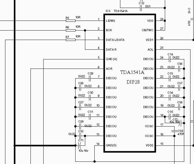

I have started some breadboard tests for a fully balanced TDA1541 DAC.

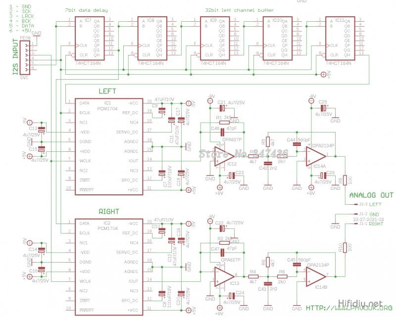

finished Receiverboard: CS8414
finished Board to split I2S signal into R + L (circuit see attachment)
Actually TDA1541 is configured in the usual way. (see attachment.)
output +/- for balanced should be AOR and AOL right?
Are my suggestions correct or has something to be changed?
How would be the I/V-restitor circuit?
2x30Ohm to ground for XLR?
Many thanks in advance for your support

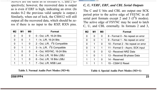

Probably a good idea as it is easier to implement.
By the way, how should the TDAs be implement in which mode:
Simulteanious OB/TWC to - 5V?
Which mode should be used for the CS8414 or 8412? See attached chart.
Thank you very much
